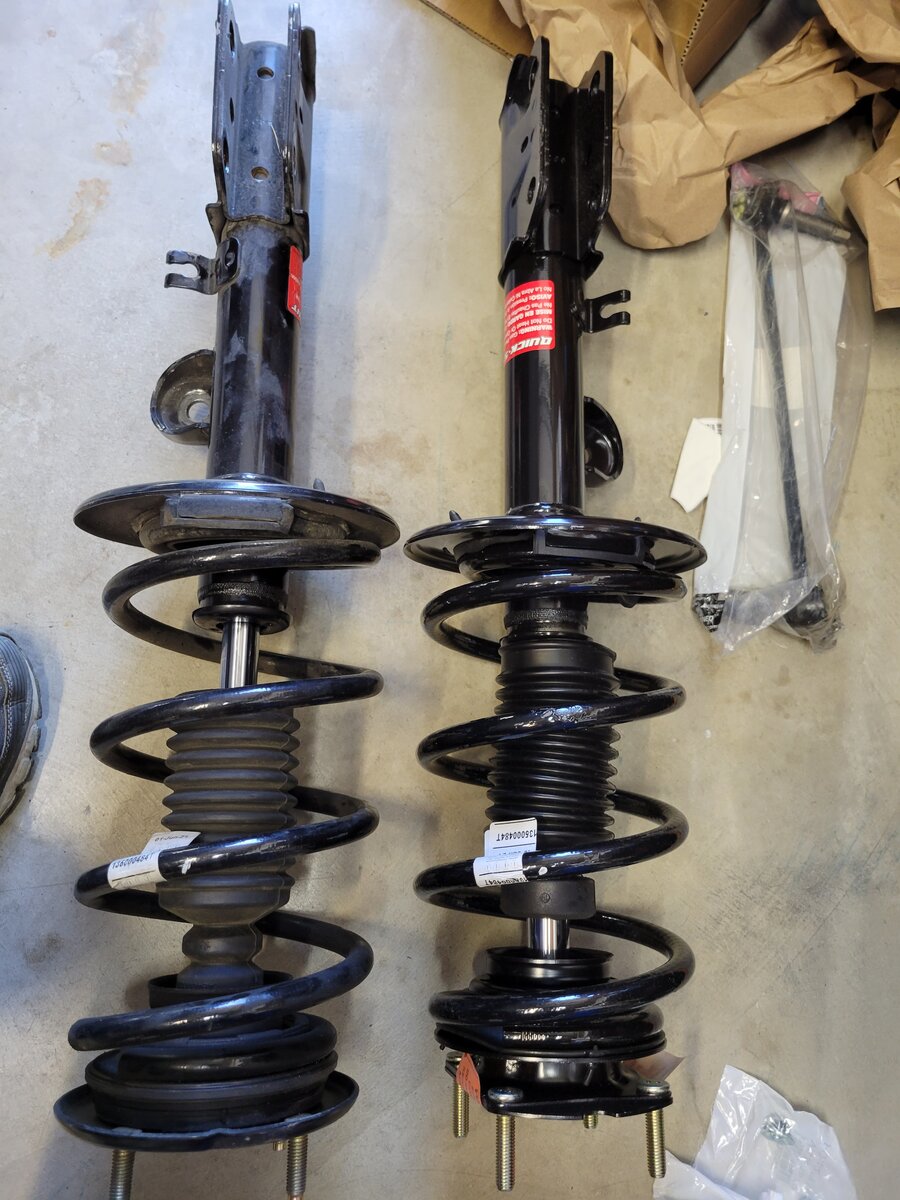

Some time back I had read up on suspension and steering issues, mostly low speed steering noise. Late last year after getting new tires I concluded that this was down to the struts. Bought a pair of Gabriel quickstruts and then bought another pair because the first ones were junk. Still had some noise but the steering noise/clunk was gone.
Noise has got worse, had a sickening crack noise when pulling into a parking space, you could tell it was a compressed creak rather than something breaking.
Got under there yesterday and had a look, thinking maybe the sway bar links had given out. Everything seems solid, but the rearward control arm bushings look a bit past their use-by date. Couldn't get much leverage to shake them but figure new lower control arms aren't expensive and come with bushings, so that's the next plan.
Anyone changed these and have pointers?
