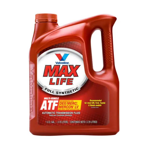

My bad it IS this one.....not the first one I posted I did not pay attention to the picture, This one I was told was for my trannie

Nuthin' wrong with Valvoline Max Life ATF fluid, it's Full Synthetic/Top Tier Quality...
That looks like the newest Mercon LV ATF, which would be wrong for any 1st or 2nd gen Explorer. Double check that again to be sure. The A4LD's need just Mercon I, not the Mercon V or LV etc. The 99 Explorer does take Mercon V fluid.

@RustyMacintosh

I am curious as to why the valve body was replaced? In most irregular shift problems just changing out the fluid will cure most issues. I agree with the previous posters on the Mercon V fluid. In the Ford manuals " Change fluid every 30K miles". Usually this does not get done until it creates an issue, which may be too late. Every time I take a pan down I put a drain plug in it. Every other drain all I have to do is refill it with the new fluid.
On the 5.0 equipt. EX's there is a drain plug in the torque convertor also. Most shops will not go to the trouble of draining the 2-3 quarts in the convertor. Also if you EX still has the original pan gasket they are reusable. Lastly I do not let any one use a trans. flush machine on any of my cars.
I have a 99 XLT with a rebuilt trans, so I could clearly tell that the 01 XLS was sloppy. Its shifts were almost un-detectable. Which in of itself is fine with me, I felt several times a 500 rpm rise going into 4th...at about 50mph. Only happened once or twice. But my ear picked it up. I have towed a trailer with it, with no problems. The trans is not slipping. But, the reverse and 1st are slow. Like what was happening on the 99 before I scored a deal off Ebay on a rebuild for $700.
Today, I am VERY tempted to put the pump on the trans, drain out all that MaxLife Dex/Merc synthetic. Then replace it with either FOMOCO stuff or dyno fluid. Other than the waste of oil, I "THOUGHT" in the 20-30 minutes of driving the XLS after the install of the valve body, the shifts were smoother prior to seeing the pan leak, which the shop dropped the pan, all the oil they had installed, put the pan on correctly then added the MaxLife Valvoline synthetic stuff I bought at Walmart. Now, for what it is worth, I also have a really clean 1994 XLT. I bought it from the OO who was totally hosed by a shop in North Vegas. This older gal, (I'm and older guy myself--65 on the 12 of July) was sold a 2600 rebuild. She brought the XLT to Cal, where she was told a head was cracked. It was not, it was a head gasket. I bought it from her for $400, put gook replacement new heads on it Dec 2018, and have been driving it.
I changed the trans fluid also to MaxLife which is the same stuff I now have in my 01 and the 99 with the rebuilt trans. What I noticed that is similar on both the 94 and the 01 XLS, is a noticeable, (to me) clunk, as the trans downshifts into 2nd as you come up to a stop. Not bad, but you can hear it if the radio is off or the AC is not on full blast. Now mind you, both have over 200k on the clock, so there obviously is going to be wear in the drivetrain. The 99 with the rebuilt trans does not make that clunk.
