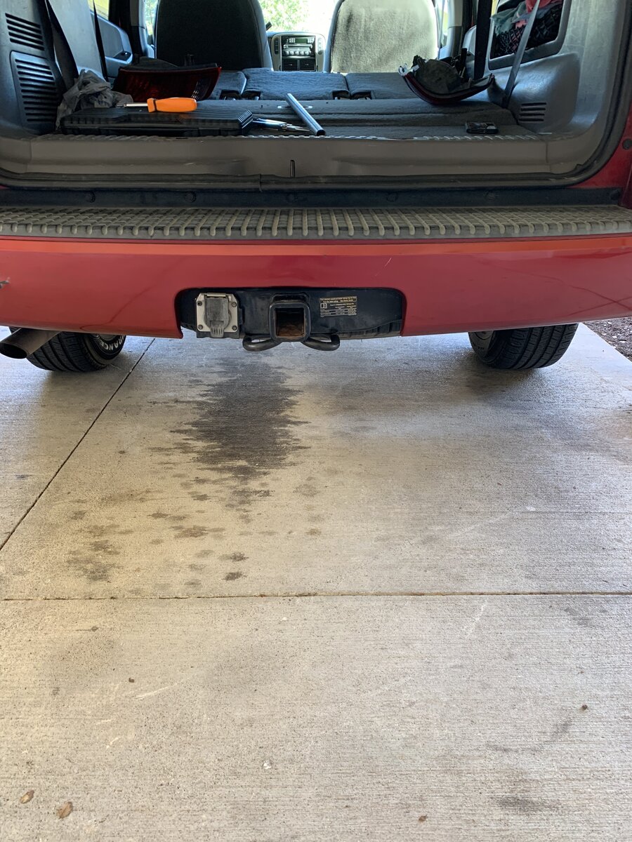

So after a trip to a salvage yard here is the final result. Thank you guys for your help.
