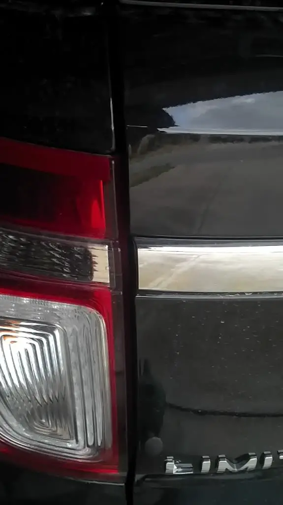

Currently waiting on Ford to inform dealer how to fix. Looks like the hatch is distorted some how. Sticks out on bottom left, flush top left, sunk in on bottom right and flush top right. Left gap 2-3x larger than right gap. Right hand side sits higher up than left hand side.
Sorry pictures not great since the car is black. But, I can assure you that it look v.bad.
Spoiler LHS
Spoiler RHS
Liftgate gap LHS
Liftgate gap RHS
RHS sticks out

Wow zed512, that is a bad alignment job. Does is leak? The dealers body shop ought to be able to fix it. No offense intended, but I can't imagine Ford would not fix this right away so other potential customers aren't turned off by this poor workmanship. An inspector somewhere ought to be fired for letting this get by.
Yes it is bad... in fact the other tsb issues seem minor compared to this defect. My dealership believes the liftgate was made incorrectly and the best option is to replace the whole liftgate. I just want it fixed.... I just don't understand why I need to wait weeks until Ford provide direction...
When I first picked mine up my lift gate was bad. They took it back and fixed it at the bodyshop. Any competent bodyshop could do the fix required. Yes it was as bad as this. Haven't had a prob since. Not sure why Ford spent all that money on those friggin lasers that are supposed to check for fit and finish. Personally I'd fire the idiot in charge of that department.
Chimoman, how did they fix it? Did they adjust the top hinges and striker latch?
I'm not sure of the exact process. I can speak to the bodyshop next week to see what they did. Ill let you know
That would be great. As I said my body shop informed Ford that it requires a new liftgate in order to fix the misalignment.
