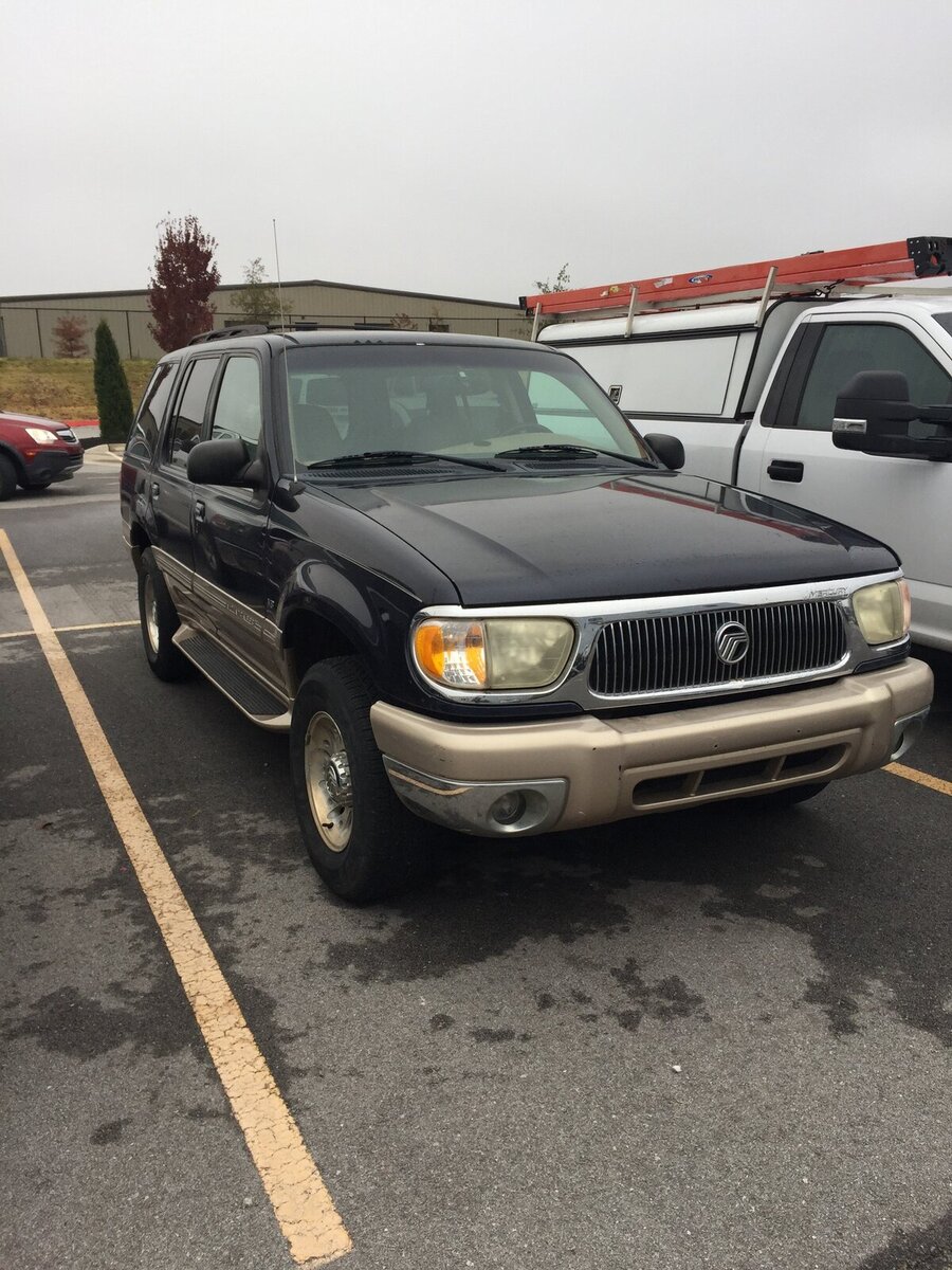

Yep you read it right - #3. Will this ever end :snicker:
I was scanning the marketplace of FB and this little blue gem popped up and I had to go see it in person. I plan on shifting my 97's Sport to 'Loaner' status and let the new drivers (Kids) use it until they :pget their own car.
After seeing it in person and chatting with the owners, it was a no brainier.
Here is a funny fact on this vehicle - see the "Jacks" dealer sticker on the tailgate, my Green SAS/SOA 97' has the same on on it. :cool:
Its not exactly "perfect", but close enough. I love the color. Picked it up for a small sum of $2000.
1999 Mercury Mountaineer
V8, AWD
LSD Rear End
Tan Leather Interior
Great working AC/Heat - Environmental Controls
Never modified
Had a slight hit in front, but was fixed by PO (Grill and front bumper)
140,050 miles
All steering wheel switches work
Cruise Control perfect
Super clean steering wheel
Runs and Idles great. P1451 is holding CE light on, but I believe when I resolve this, it should improve better
Onboard computer is pretty fancy :thumbsup:
Some small issues:
Radio works, but screen doesn't light up
Currently has P1451 - EVAP System Canister Vent Solenoid Code
  • Any info that you can shed light on would be great. I have been reading threads on this and going to test this evening. New part ready to be ordered
Needs new rear wiper arm - weak spring
Fog lights need to be connected
Slightly longer starting issues. Not sure if it is code related or ICV need replaced or cleaned.
Multi-Function Switch - or turn signals not working/canceling
Center console arm cover was shrinking (replaced the fabric w/ some lighter leather I had - may change)
On with the photos, Ill post more 'In Progress' info/photos as I do more. :bounce:
Just what I need...another project. I'm thinking of maybe just putting slightly bigger tires (31's maybe) and TT lift and shackles.
Let the fun begin!:bounce:

410Fortune
Truck Season!!
Staff member
Moderator
August 3, 2000
26,631
2,324
NORTH IDAHO, 7B
B2 "Slightly" Modified
Callsign
FOURTEN
Perfect!!
410Fortune
Truck Season!!
Staff member
Moderator
August 3, 2000
26,631
2,324
NORTH IDAHO, 7B
Callsign
FOURTEN
I used to have a 2000 Mountaineer Premier....I fixed that thing up so nice, it was hard to sell her
I love these trucks very much
Very nice find, 140K is just a baby
Beautiful! And polishing these yellowed headlights will make it look even better.
By the way, I would get rid of that silly ball on the rear bumper and install a real hitch - if you need one.

Great looking find.
I always ran a hitch and the bumper ball, both.

Looks great, and has all the best of a Gen 2. The front bumper is from an Explorer Eddie Bauer Edition which I think matches up perfect to the Mountaineer grill. I did the same thing on my '98 Explorer with the Mountaineer grill and headlight conversion. :thumbsup:

Looks great, and has all the best of a Gen 2. The front bumper is from an Explorer Eddie Bauer Edition which I think matches up perfect to the Mountaineer grill. :thumbsup:
That did not occur to me. Thank you. I need to know my models and parts better. :)
I knew the PO changed it, I thought only the grill and head lights were the only difference:dunno:

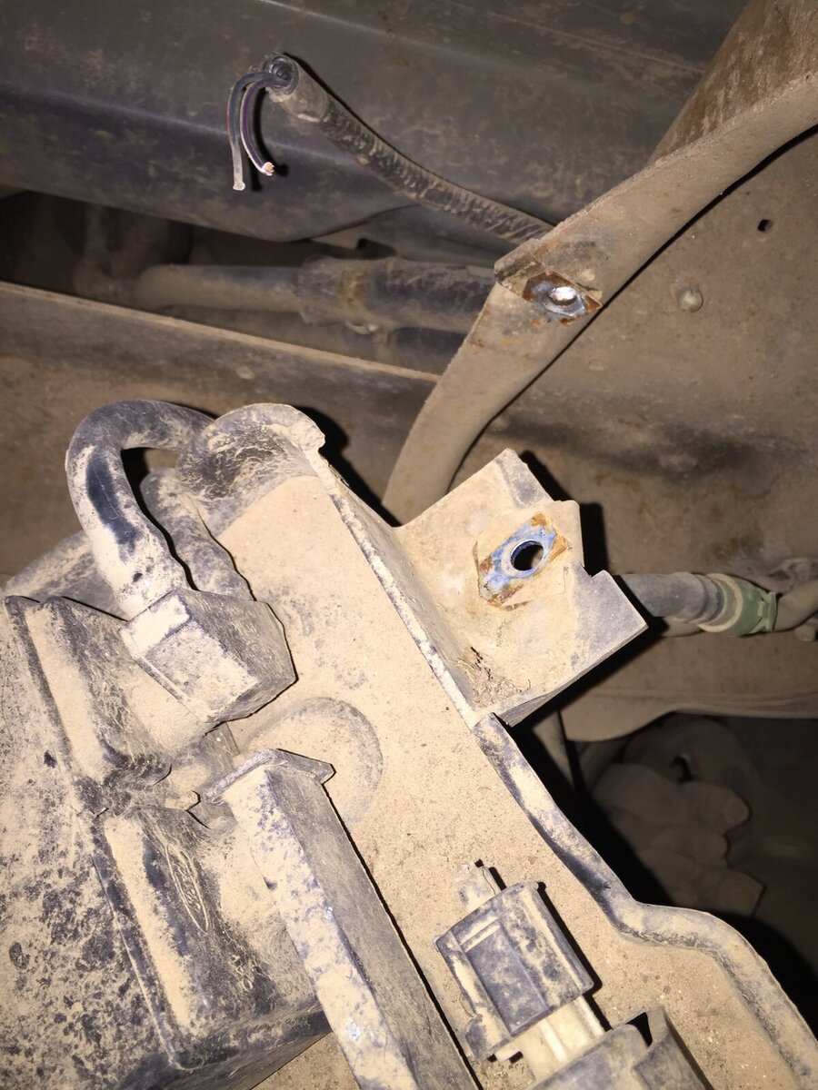

P1451 - EVAP canister Vent Trouble shooting.
The culprit. Broken wire at the PID.
index.php
Wire was cut or eaten right at the connector. I pulled it apart and spliced/soldered new wires to the little female posts and cleaned and replaced all the weather proof seals.
index.php
Repaired and reconnected. I hooked up OBD reader and cleared the re-occuring codes.
index.php
I did start it up and no code reappeared. Previously, The Monty would cycle the starter a bit before starting, but this time the start was almost immediate. While the spare was out and the solenoid clear to reach, I did a quick ohm check, 56 ohms was read.
Tomorrow's trek to work will also help me see if milage will improve.
Update: (Next Day) Drove to work and during lunch took it to the JY for some odds and ends and no Check Engine light! :chug:
