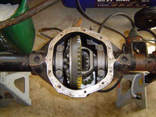

Woo Hoo! Back in action again. Did some serious work today on the SAS. Should be back on all four feet in no time... Enjoy todays pics! Got the axle back together including a lunchbox locker (not in pic).
4.88s installed..

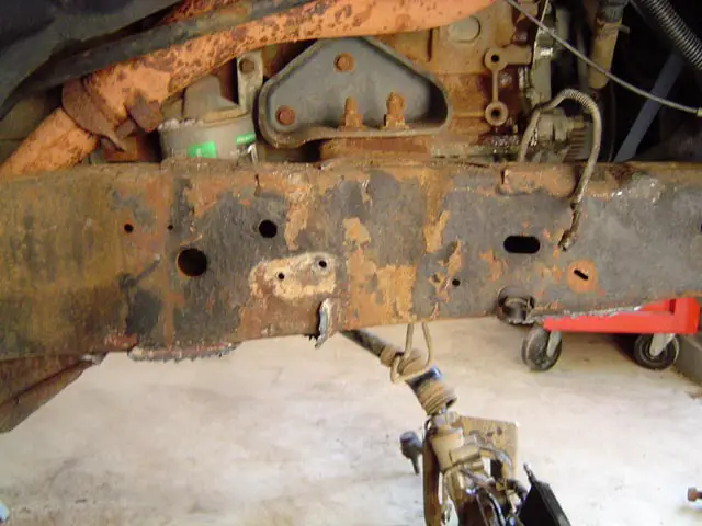

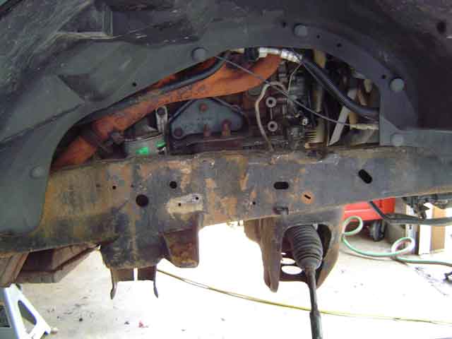

More fun pics.... Did some more work this evening, got my coil buckets all cleaned up and ready for mounting, got everything cut from the pass side and removed the good old crossmember!
pass side:
The infamous (that means more than famous :)) front crossmember! Yup thats it sitting in a pile of all my power steering fluid!
BTW you can notice looking at that pic that I torched on the pass side, but used the sawzaw on the drivers side. I am not brave enough (or stupid enough, one of the two) to use the torch near the fuel lines on the drivers side.

Dave, that passenger side of the engine makes me want to get a tetnis shot! :eek:
lol... thats all that good old salt we get on the roads up here in the winter. Sad thing is I just painted that all black last fall.

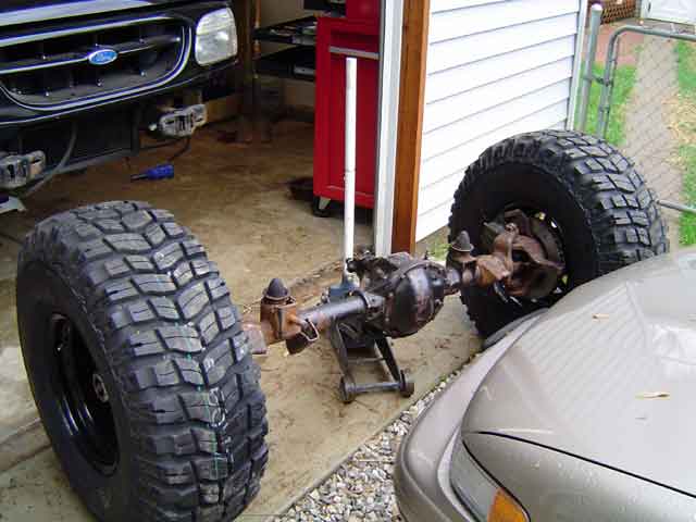

It has feet!:D
