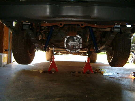

Well it's all buttoned up, took it for a test drive, I could feel it launch a little harder but not a whole lot, only the timeslips from the track will tell. The front drive shaft is still out because I wanted to drive it in 2wd and see how that felt:burnout: My brakes are a little to strong for a good burnout the powerslots and hawks really hold that thing will. I'll post the video and a couple of pics after I get back to topeka tonight.
