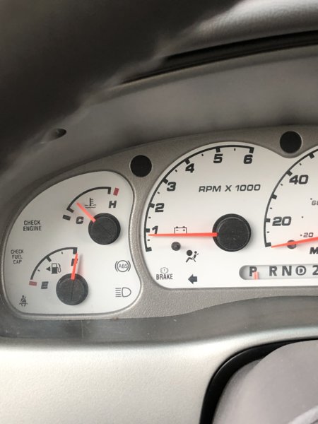

Sorry to hyjack this thread mine makes great heat in the winter my gauge never goes over what’s in my picture. It will go down a bit from there for a little bit then back to that point. But runs well and makes good hear. Normal for winter I guess. If I remember in the summer it pretty well stays in one spot.
