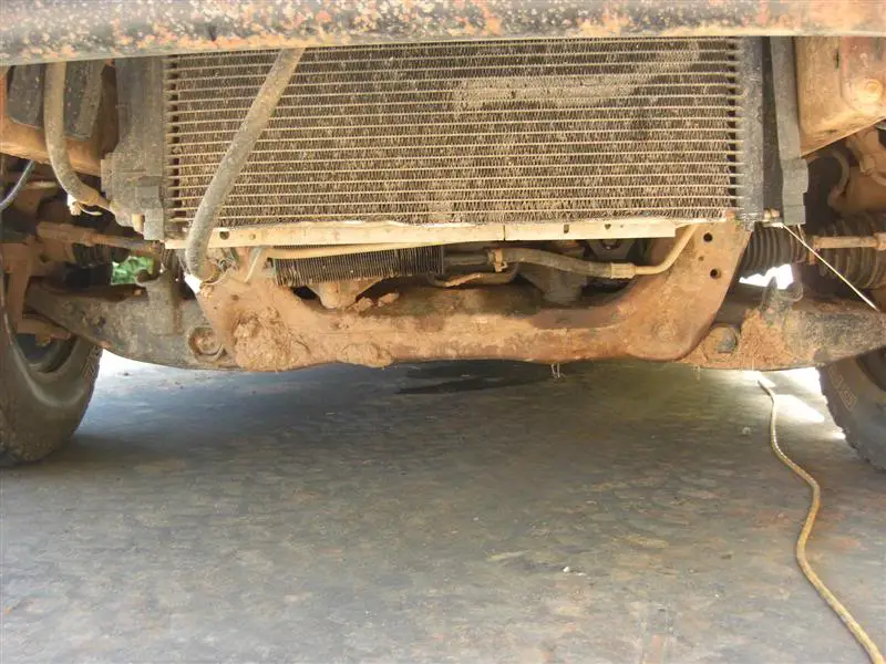

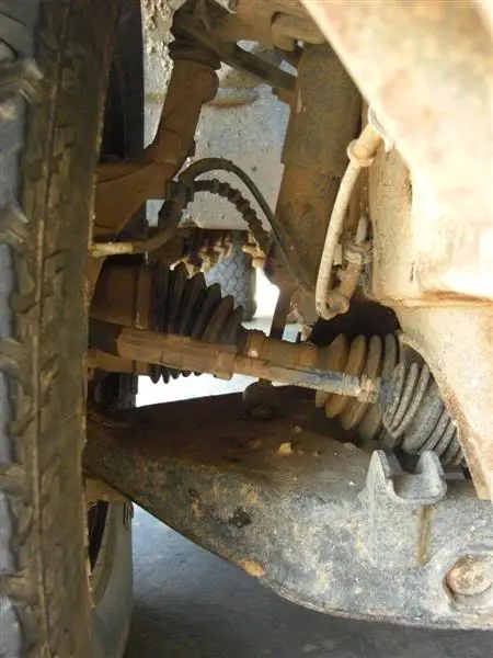

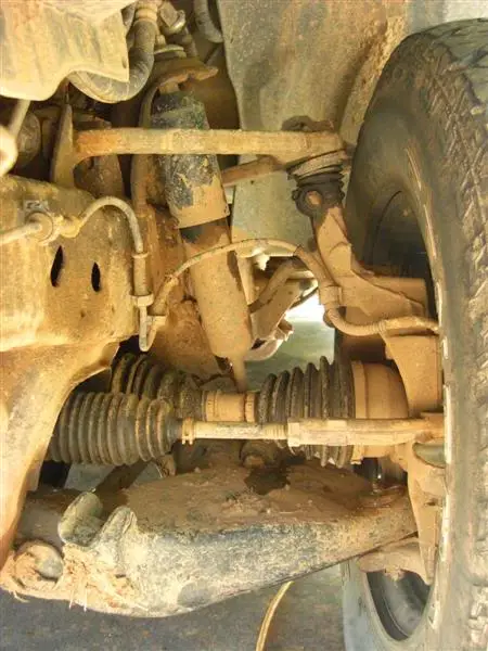

I had to a frame swap around February. I put a 96 frame on my 2000 body and i put all the 2000 suspension underneath. Well apparently the torsion bar Keys sit in a different type of pocket on the 96 compared to the 2000.
When i put all the 2000 suspension underneath with TT all the way on the stock bolts. It sagged Alot but it didn't bottom out. Thinking it was the torsion bars i put my 96 Torsion Bars in And Ran them all the way up. BIG Problems. My FR Control Arm was allowing the torsion bars to slip slightly in hole making my right sit lower. But with the bars TT all the way up the right was sagging so bad now. That when i even pull into a parking lot it bottoms out.
Could i fix this problem by putting 1996 Torsion Bar Keys on instead of the 2000 ones?
Could the Lower Control Arms Be Different then the 2000 so it doesnt sit in the pockets correctly ... HELP
Front Left Suspension
Front Right Suspension

If you could post some pictures up it sure would help us help you. Your wording of parts names are kinda confusing.

I'm thinking you either don't have enough of a twist with the t-bar bolts, or the tbar keys are not going up because of some type of interference from the swapped parts. The newer styles have "Pads" for cushion on the wrist of the keys. If you have a 96 frame under it, you shouldn't have these.
Sorry i guess i meant keys when i said knuckles. Correct There is no pad and i was thinking the 2000 keys are different than the 1996 because the 2000 keys are supposed to be on a cushion
Wow! You really do have a problem there don't you.
There is definitely not enough twist on the t-bars. Your LCA should sit level for a stock ride height.
What size bolts are you using for the t-bar crank? If your bottomed out with the ones you have (which might have got mixed up & wrong ones used during swap) you might just try some longer bolts and see if that helps. They are a M12-1.75 bolt. Dealership parts counter should have them stock length, or Fastenol.com has them in diff lengths.
Try that 1st and see if it helps any. Make sure your ball joints are still good too, those pics make them look stressed a bit.

Any Suggestions for Fixing the Right hand side cause as you can see in the picture its the one with alot of problems
When i installed them they were not level or above they were below cause i could not go level because i would have had to the key one notch would put the key vertical to the frame
