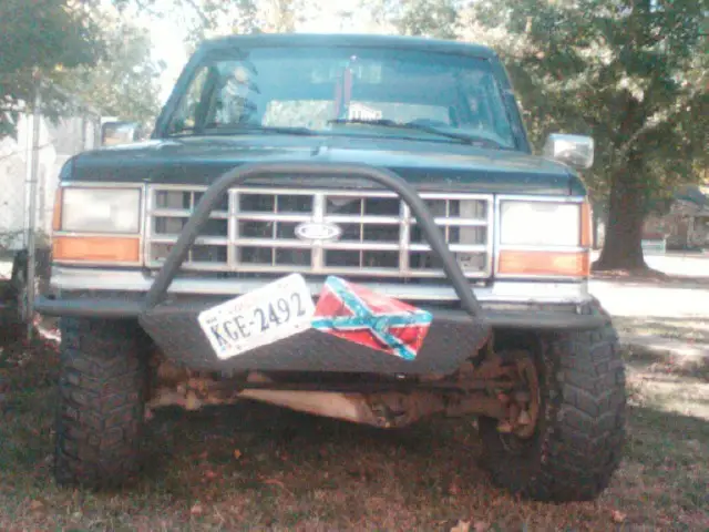

well one guy out there(the guy that actully plulled me out) had a bumper on an ol ranger frame he wanted to give away but it needed to be re welded and some way to hide the frame(he had a piece of plastic zip tied :rolleyes:)

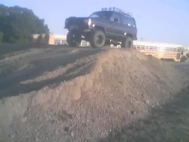

so i welded a peice of diamond plate on and added some used 31x11.50x15 m/t claws

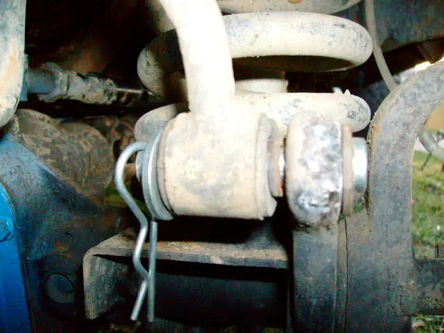

wheelin with 31s was fun but i was ready to get serious (and plus it was rubbin) so first off i added 2" homemade shackels on the rear
and those kept me from rubbin in the rear but i ended up buyin a 4" rough country lift
now i needed bigger tires :D
next to my buddys stocker:p:

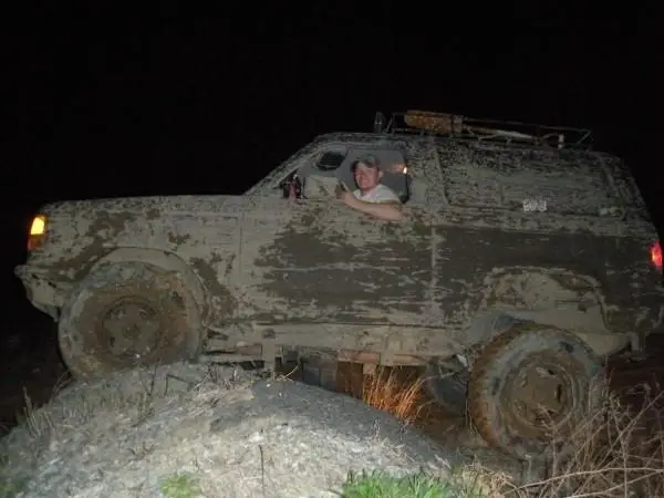

and now a test !! went wheelin and got in to one of those "if you do it ill do it " deals i tried to go through a pond . i was goin good till 3/4 i remember i for got to lock the hubs :rant: and well i got stuck
the end result was a wet smelly flor for like a week

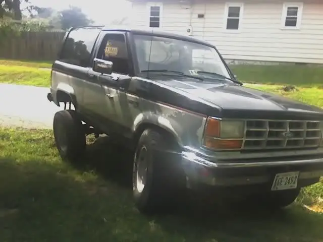

welp few weeks later i got a hold of some black paint and desided that the gray had to go and i wanted a solid color
yes i painted the wheels too

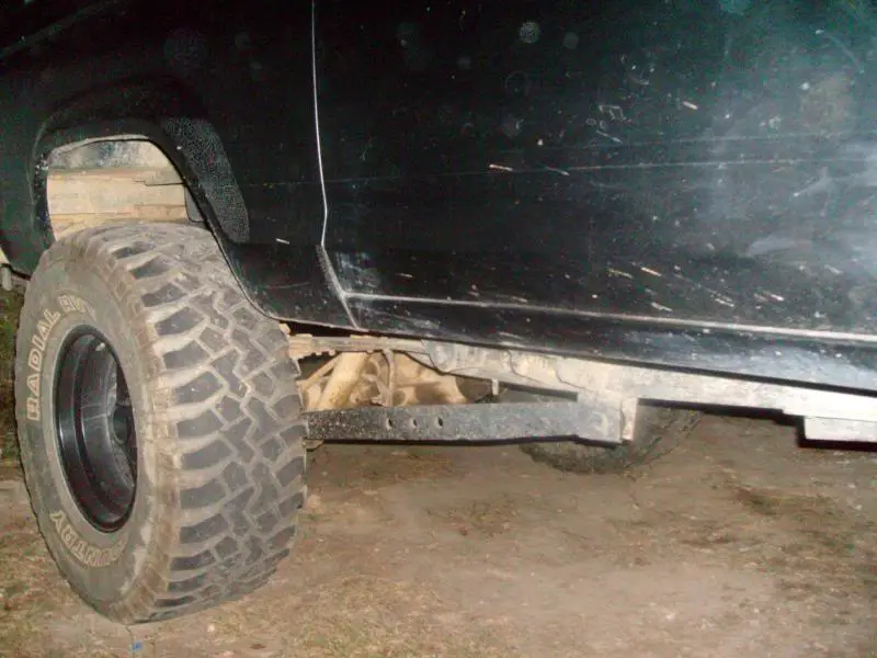

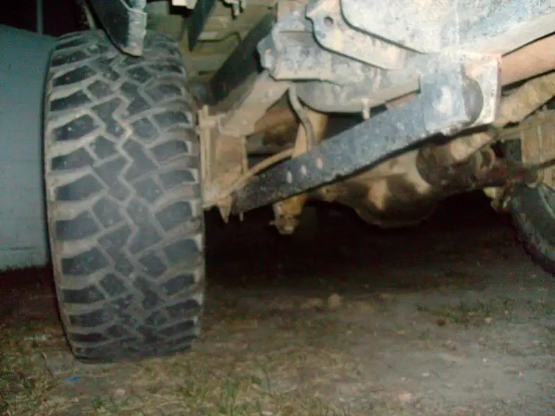

now with the bigger tires and weak springs ,the rear need some help bein stable so i made some traction bars from tractor attachment arms to fix my axle wrap

and the ag arms work and ride pretty good on my four link in the front and flesxes well to but if i keep this setup ill try to get the y shaped control arms from rustys . if you was talkin about the tration bars for the rear they work great as well but i havent had them on since a swaped me rear axle it does make it ride a bit stiffer but i never seen where it limits the flex of the rear but i added those cuz i was having issues with axle wrap.
