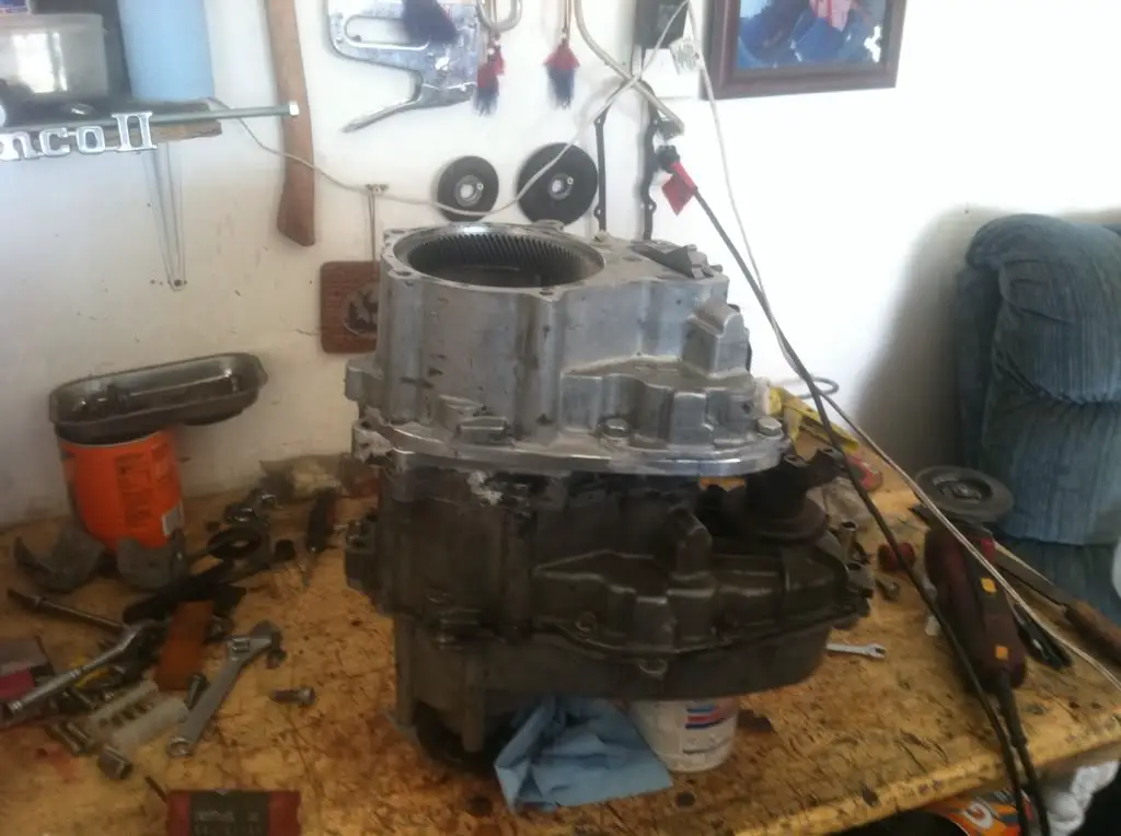

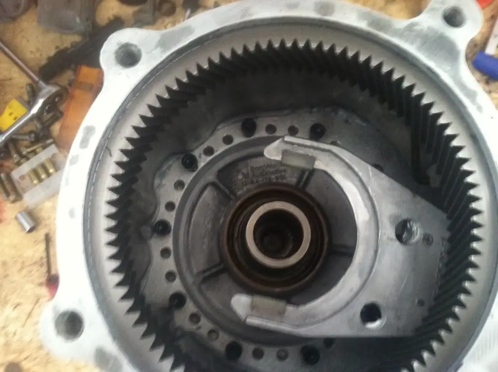

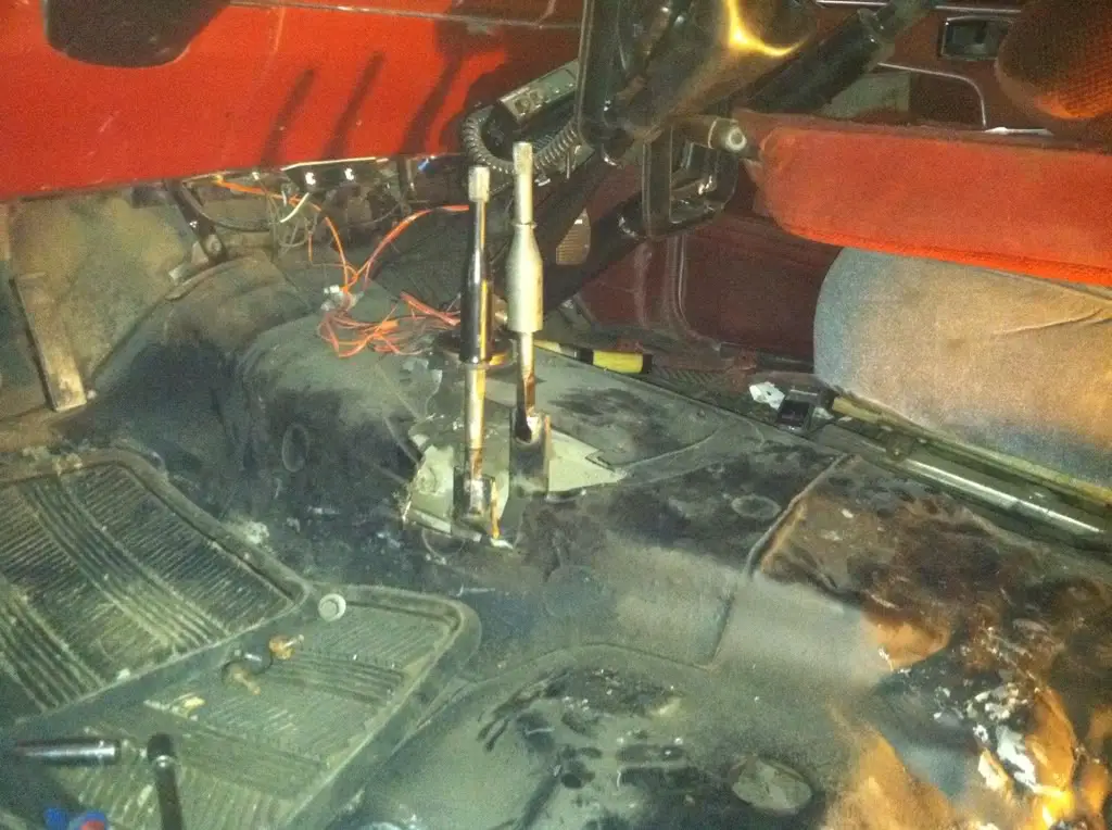

ok I got the doubler together, here is a little run down in pics on how to put it together, first you put the clocking plate on your back case,
then stand the case up and put the doubler case on it, I had preinstalled the doubler plate onto the case, it is straightforward and bolts together, here is the case standing up,

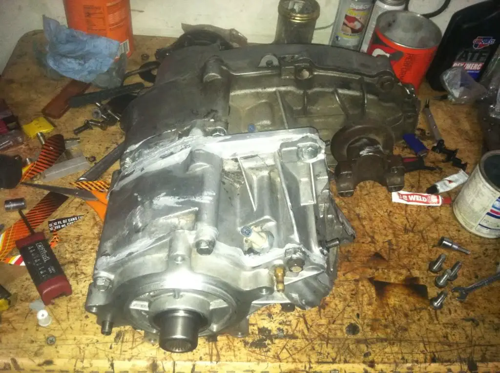

clock to your desired position and install the bolts, I drilled holes in the shift fork for easier access to the 2 bolts underneath it, shouldn't comprimise strength,
then assemble the components of the doubler case together from the front and tighten the bolts down, I used ultra Grey silicone this time instead of parts store brand, I hope it doesn't leak,
