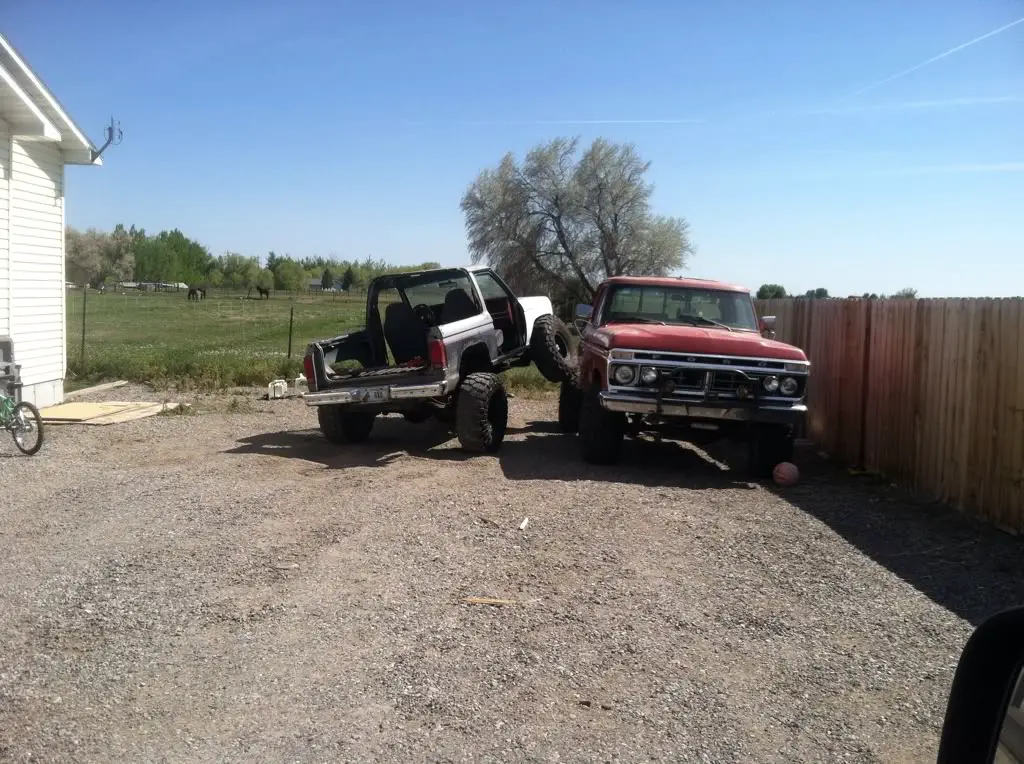

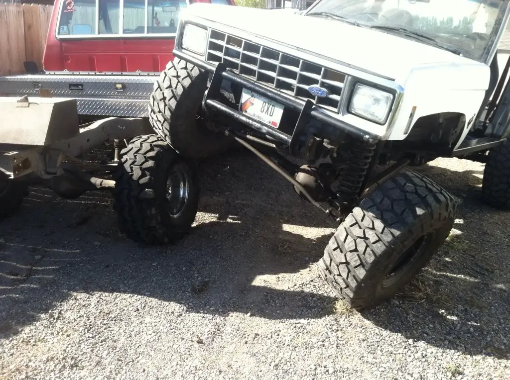

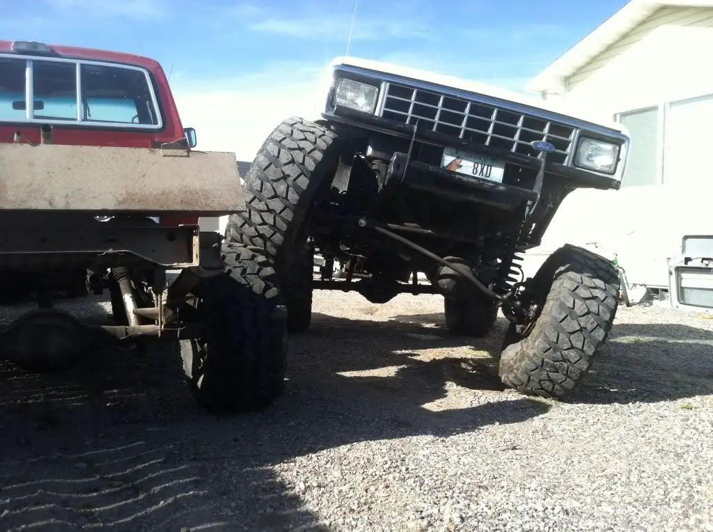

got it back together, little fun with my brothers truck in the driveway,

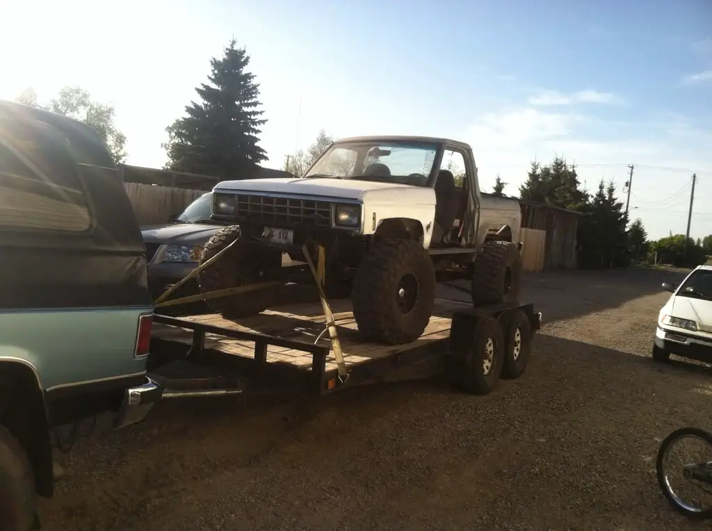

also loaded it up on the trailer to take it to Erics, need to build the crossmember, skidplate and the fenderwells, we have a run this weekend and Eric told more people they can go than he can fit in his rig haha. gotta get moving on this thing. on a sad note it does still have a few leaks, pretty pissed about that, I was VERY careful putting it together. oh well guess its time for "The Right Stuff", but im going to wait till after the run to take it apart.
I bet it did turn some heads. Nice flex, I like the way the front axle was articulated and both rear tires were on the ground. Now for some real action shots.
