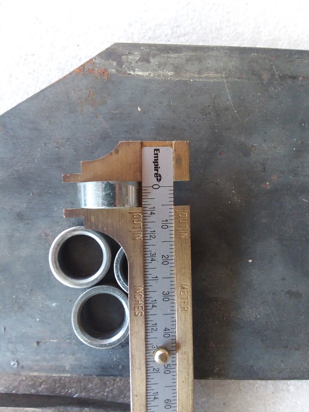

So yesterday I decided to start one side, and wait for the missing bolt spacers to arrive next week. I went at it, using the spacers I had. I Quickly discovered, that the spacers were a tad too wide, for my mount tabs. My brackets, was made for the QA1 shock spherical bushings, with a 1" width. The Fox spacers Poly sent me, was for a 1.250" wide tab. So, I used the bench grinder, and removed 1/8" on each. I decided to put on new hardware, and found some longer spacer tubes, while rummaging the specialty bins. I cut down the other 4 I was missing, and had what I needed, for both shock installs.

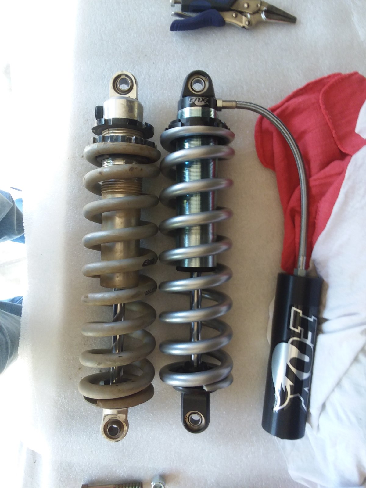

With the old dirty shocks off, (haven't cleaned them from the CO trip last month) I compared them with the new Fox 2.0. QA1 are about 1" longer overall, as they have a slightly bigger body, and a slightly longer shaft extension. So this meant, I couldn't install my new limit straps right now. Those will have to wait until the welding is done, with new tabs.
I like that the Fox has more threads on the body. I will remove the coils off the QA1's and clean everything up, and put them up for sale for half price. ;)

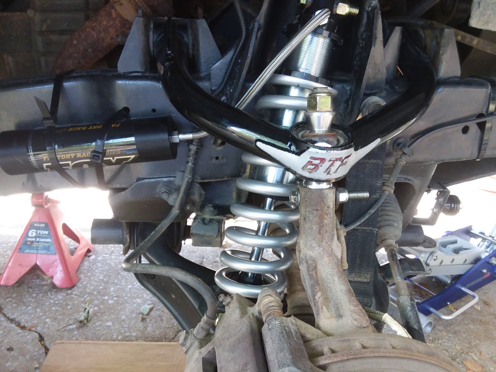

So with the shocks installed, I had to place the reservoirs in a temporary position, until the welded tube mounts are installed on top of the frame rails, and tuck them out of the way. This pic is with full droop, and limit strap doing it's job. The Reservoir line is free & clear, even tho it looks like it is hitting in the pic. You can see what time has done to the paint, and surfaces. But I have taken it to a few major locations, and ran them thru the ringer pretty hard. I will touch up after all the welding is complete.

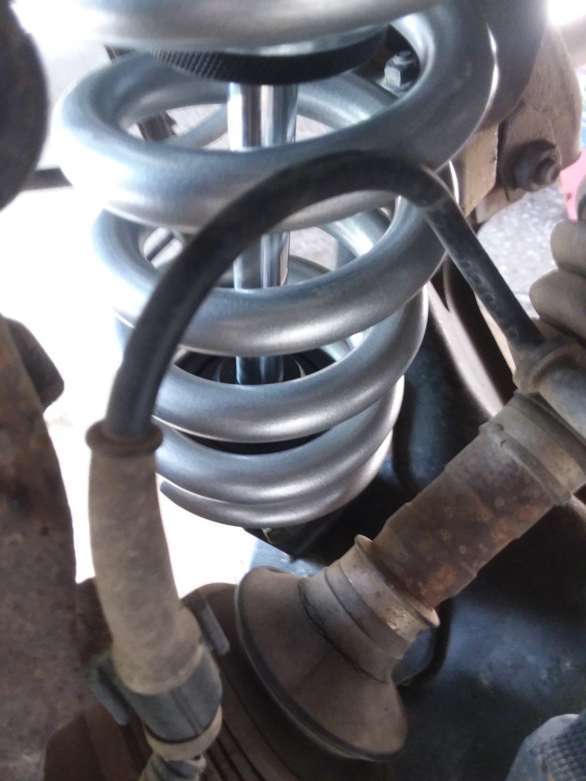

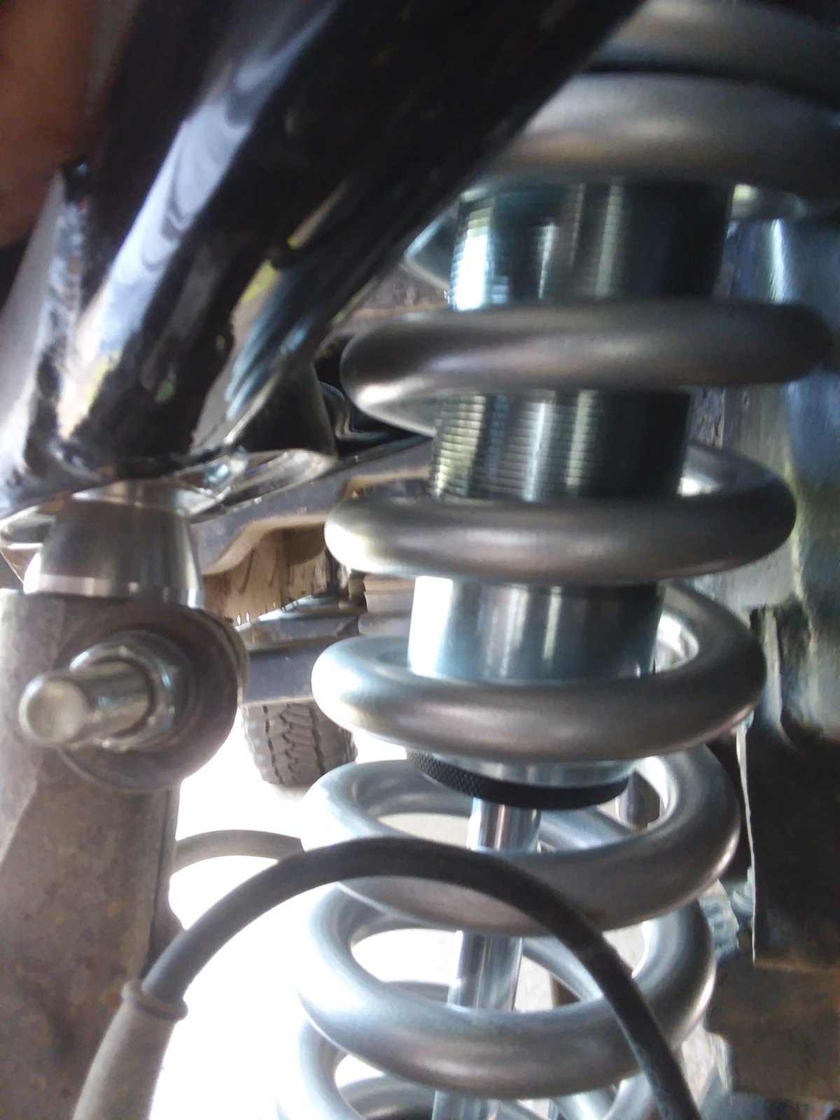

The new coils are 700 lb x 12". I got them close to where the old setup was, but really no way to know how far to crank on the keepers, just yet. Oh... The spanner wrench I paid extra for, from Poly Performance was wrong. Wasn't even close to the right one. Ordered a set of 2, got one and it was wrong. SMH... I got lucky, and was able to make one of the QA1 wrenches work. So after a run around the neighborhood, the coils settled and was able to re-measure, and adjust them again. Set them 1/4" higher then the previous height. Dropping 50 lb's made a nice difference, and loosened up the stiff front end a bit.
So these clear the CV's and the UCA's just the same.

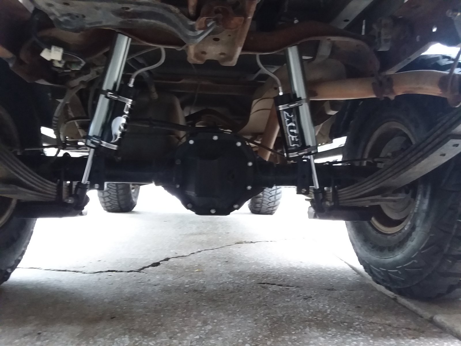

So the other half of my shock order arrived yesterday. Got them on today. The BH is full on Foxy now. :D
Learned these are a royal PITA to do alone. The little tab spacers are pure evil to put on. You have to hold both spacers on the eyelet ends, as you slip the eyelet into the tabs. I think I will order the poly bushing kits from Off Road Warehouse for these. They eliminate the spherical steel bearing, & spacers. They make the shocks like a normal set with poly bushings and a bolt sleeve.
I had to install the lowers first, then lay on my back, and compress them with all my might (doesn't help I'm a tired mess) and quickly swing the upper end to the mount before it extends too far. I used the Hi-lift jack on the sliders to lift one side at a time, to make the distance longer, and give me an extra fraction of a second. lol
Also, the upper pin bar eliminator tabs, and the lower skid tabs are made with a 1-7/16" space. Most shocks are 1", 1.25", & 1.5" widths. I had to order some spacers for 1.5" tabs, and the shocks come with 1.25" spacers. Using one of each, I cranked on the bolts to compress the tabs a bit to take up some of the slack. Best I could do today. Time to get horizontal, and deal with the ongoing face pains.

Shocks installed.
So the new-ish MT7000 with 10" travel I removed, will go up for sale too. ;)
