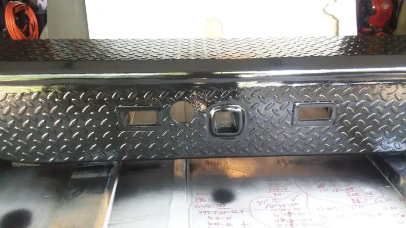

It is getting holes put in it for the trailer chains, and the 7 pin trailer harness. I don't want the chains to run under the tube, rather through the center face plate. The trailer is built for the trails, and I don't want the chains to get pinched/dragged on rocks. Backside is heavily gusseted for the hitch, no worries here.
Plan is to cut sq holes into the vertical diamond plate, then weld 1/4" angle to box them all around. For the chain hooks, the loops will be welded to the backside, hidden from view.

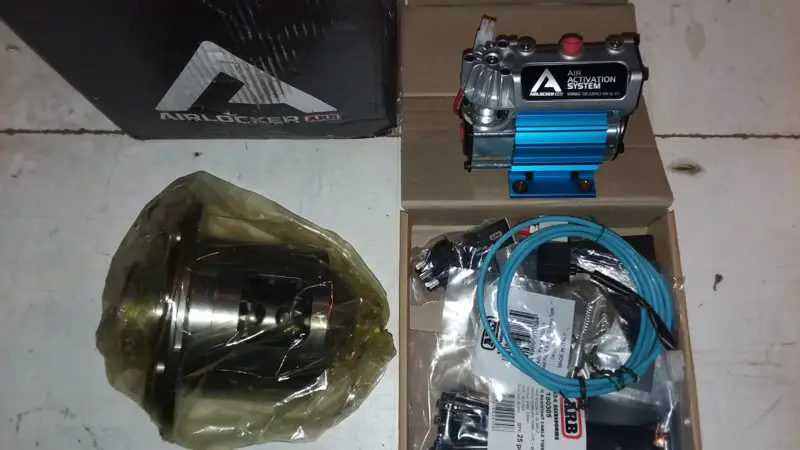

While back I bought this 8.8 ARB locker, and a bigger pump to use for double duty with tire inflation in mind. I made a custom mount box for that pump, and installed it. I decided to steal this bigger pump for the trailer build, and bought another pump for it. This pump is smaller, and only used for the locker. I have another pump installed for the tire fills, that works just fine. I might update it eventually, but it works for now.
This will be installed at some point over the summer. I am in no rush, as I still have the ongoing trailer build, the rear bumper work, and the troublesome brake/tow circuit to figure out, and more to come.

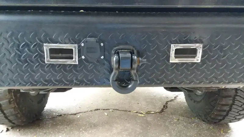

So I cut a 2" Round hole, and two 3" rectangle holes. Mounted the 7 pin Trailer connector thing a ma Bob, but didn't wire it up. Just zip tied them in place neatly for now.

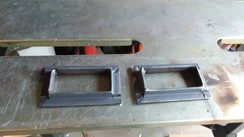

Cut up the angle iron with the old chop saw, notched them with the grinder blade, and welded them up.
Mocked them up just to share with all you awesome people.
Not sure when I will take the bumper off, to weld them on from the backside yet. I put them in a zip lock bag, and chucked them in the freezer for now.

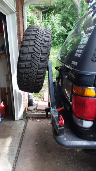

Half day at work, sun came back out, and decided to hurt myself........ I mean work on the tire swing out mount.
Cut the top Horizontal tube in half, between gussets. Put the loose end with the mounting plate in a vise. Marked the end of the tube, and made a 15* cut.
Cleaned both tubes of paint, clamped it in place, and welded it back on. Quick shot of black paint to hold it over until it gets sand blasted, and mounted the spare 35" tire.
I didn't account for the new angle in depth at the bottom. I can remove another 2.5" from the horizontal top tube to draw it in closer to the rear door. That's going to have to be for another day.

Why do you want that angle for the tire though? I'm imagining barely touching something backing up ...?
Well, after it is brought closer to the door, it will be tucked in tighter, and look better to me for one. The distance from the top of the tire to the back glass bugs me, but....The other more practical reason, is while on the trails.
In wooded areas with heavy foliage, the top of the tire won't be as much as a snag point.
While climbing and descending from an angle to flat ground, the lower outside of the tire edge is higher, and less likely to scrape.
I hear that, you get intimate with some foliage at times don't you?
I just had a dumb idea, really hard and probably not practical. Place the tire where the hatch is(cut a hole in the hatch so it's mounted in a pocket), extend the hatch outward. I could see really strong hatch shocks being a problem, and the back end would look way weird with the bulge and glass moved outward. But that would be interesting, and R&Ring the tire would be more interesting. It's worth a chuckle, but never mind, keep going.
That would be cool to see done, but not by this guy! Lol
Why you wanting me to work harder anyways Don???? Lol
Trying to keep that tire centered between roof and top of the bumper, while getting the desired angle, and as close to the swing out tubes as possible, is hard enough.

For the last 6 days, the rear bumper has been worked on. It had to come off, to weld the tow chain loops and the pass thru boxes on.
While it was off, and the paint needing stripped to weld, I kept going, and stripped it all with wire wheels.
New chain loops on the main bumper tube.
Pass thru holes boxed.

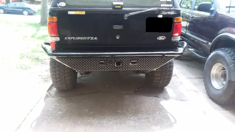

And since it was stripped, I added kick out tubes to the sides. These will help protect the body corners if an off camber situation slams it into a rock/tree. Getting the tubes notched was the hardest part due to the extreme angle on the fronts. Took me forever a removing a little at a time.
Cleaned and painted the rear cross member while it was exposed.
Installed the beast today. Painted the tubes, & 3 sided brackets all purdy, then bolted the side support tubes together with stainless hardware.
Dr side
Pass side
Full Monty
