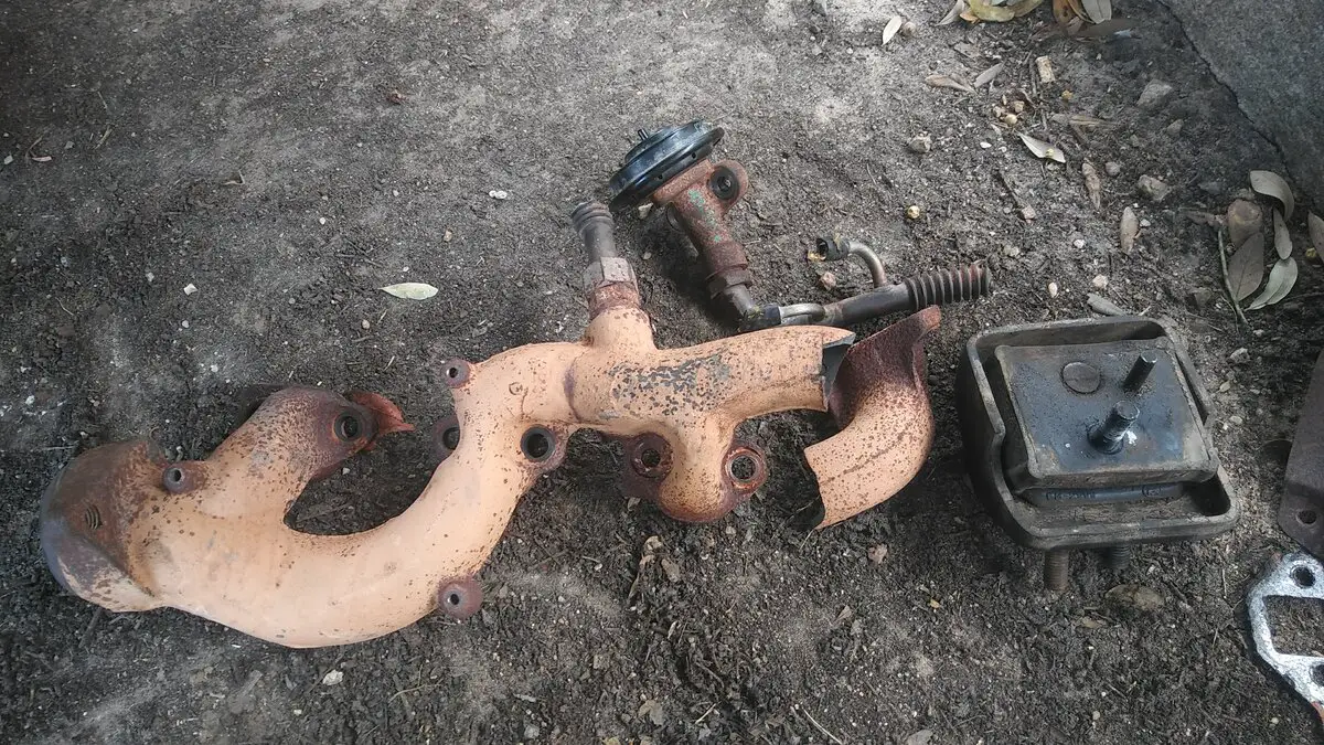

New Manifold on.
Old busted up POS manifold. Supposedly, these are off a Saleen rig used from 99-01 with less restriction in them than the 98, and supposedly less prone to cracking. Myth busted.
Mike thinks the smaller pieces happened after the fact, from the weight of it, and flex during use, getting it back to camp, and to his place. It was only the one crack (all the way thru) at the down, when it blowed itself up on the trail. It threw a CEL for the HO2 lean, on the way to his place.

WHAT THE HELL??????????????????????????????????????????????? I know every cast part has a weak spot but
DAYYYUM!!!!!! That sucker blew up!
I have a special shelf for parts like this, stuff that has reeked havoc, each bit has a story behind it, that manifold would be up there for sure
Maybe whatever was blocking the flow found its way deeper into the rack now? Who knows, that just plain sucks. I have replaced plenty of racks and power steering pumps and I have never seen this before.
I was even thinking sheesh maybe his serpentine belt is spinning the pump backwards? LOL
Did anyone pull the belt off and spin the pullies? I'm wondering why the 230 degree water temps
Had it happen to both of mine when Red got dunked.
Hot cast iron and water do not mix at all.
