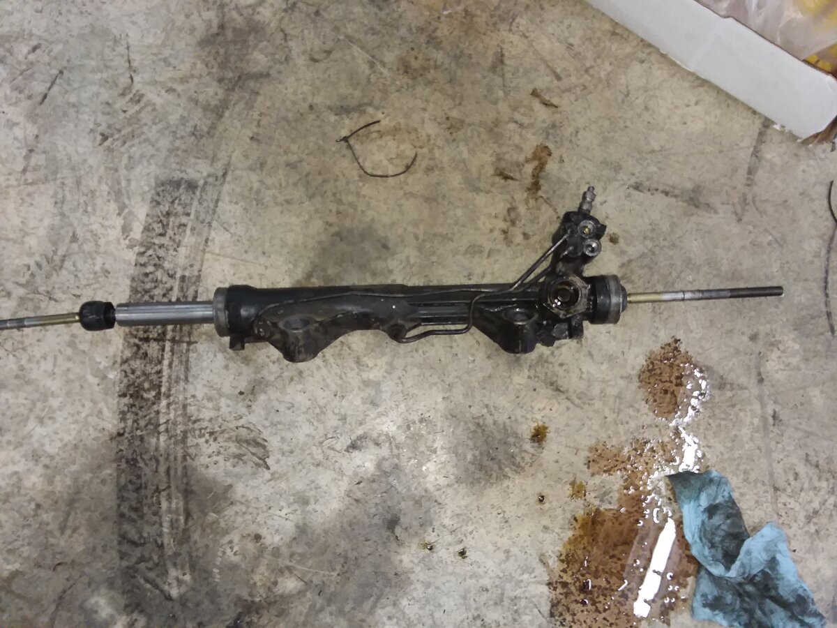

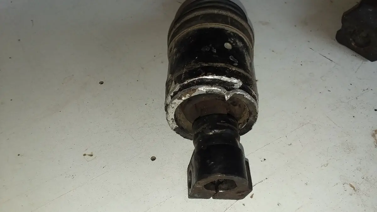

Was looking thru my recent pics, and found one I took of the blown Napa rack that was removed. It's not a good picture, but it kind of looks like the little restrictor valve is inside the lower line passage in this picture.
Inner tre's are from the new rack, and put on this old one for the core charge return.
The new rack, the restrictor valve is in the top line passage. Hmm...... if i'm seeing this right, that just could be the issue here with the low assist in the system.. Confusing part is, I thought it went in the upper line passage, whatever that is, high/low. I might be wrong. But if this is true, then that might be a difference between the 4.0 & 5.0 racks. They do have different part numbers. Hmm.... I need to remove the lines and see for myself with a mirror.

Talked to Pro Tech about the rack. He assured me that that valve was in the upper line, on the new rack when it was installed.
Looks like I have to pull it out.
He did it on the lift, and with the skid still on. He didn't have to raise the engine to do it either. It will be harder to do on stands, but he did take the inner and outer tre off as one unit to do it.
The camburg inners make it a little easier to remove them, and not mess with the alignment. Hopefully when I get around to doing it, it wont be a fight between heaven and hell for me.
Now.... do I replace it with the 4.0 or the 5.0 rack? I know the napa 4.0 rack worked, but only lasted a couple thousand miles. Too bad it was used as a core replacement as I might have been able to turn it in for a new unit. I can return the 5.0 rack in it now, but if I go 4.0, that's a new charge. Hmmm.... what to do, what to do.

a rack is a rack. ive used the ones that come with a sport because the lock to lock is different.
however
i am going to warn you. a rack in a 5L is a REAL bitch to change. i cant stress it enough.

I thought they were all the same . The only difference I can think of could be the wheels used. Bigger wheels or tires often make the steering racks have less turning range built in, or come with limiters to stop them before they make something rub. Mustang racks have done that many times by the model year and what wheels they changed to over the years. Explorers all had 235/75/15's generally from 91 to about 98. Then there were two new 16" wheels available and the tires went to 255/70/16's.
So if you have any full lock kind of possible rubbing, I would opt for an older 2nd gen application. You can also as needed find those limiters that are common on Mustang racks, they are literally just a round chunk of rubber that slips on the inner TRE at the rack, about a 1/2" thick or so. The racks should be the same internally I think. I wish they were different, I like a quicker ratio steering.

I was told the difference from the 4.0 to the 5.0 rack is in width of the rack itself. The 5.0 is a little wider. Only talking fractions of an inch tho.
I have replaced the 4.0 rack a couple times, and I completely hated the job. Took a couple days the first time. 2nd time went much faster, after learning the trick to manipulate it in/out. After watching Pro Tech remove / install this rack, I think I can do it even faster than the last time I did it, even if it is the 5.0 this time. Still going to be the big PITA job regardless tho, and one I'm not looking forward to.

If the pressures are regulated differently between the 4.0 and 5.0, that could be causing a problem with mine, if there is nothing wrong with the current rack.
Could be I got a bad rack out of the box.
I have heard there is a difference in years, with different turning ratios.
This new info of different widths isn't a concern to me, as it is minimal.
I know the lines from the pumps are different shaped, but don't know if they are different in volume.
I want to exchange this 5.0 rack with the same, just to save $$ on purchasing the 4.0. This is a gamble, if the same issue happens doing this.
On a scale of 1-10 for the assist, it is a 5 right now. No return to center, and you need full grip on the wheel to turn it. When I went from Colby ks to Ouray co, it was a 0. That took both hands, and full strength to turn the wheels, and impossible to turn unless the rig was moving. That wore me out!!
When on a trail, and put into low range, 4wd, something gave, and freed it up somewhat, and was about a 6. After we flushed the system, it got a little worse. Took it 1200 miles home like that, with a trailer. Talk about a rough time. Lol
The reason why mine is going to be a pita, is if I have to remove the big front skid plate, it isn't easy. They bash bar connected to the cross member blocks the lower bolts. To remove the bar, I have to remove the coil overs. The bar is bolted using the front bolts on the lca. That means an alignment is needed after. My fault for not turning the lca bolts 180, with the nuts facing forward.

that does add a bit to the job
I do remember them having slightly different ratios
Not returning to center is DEFINITELY a rack issue
I have used 4.0 pumps on 5.0 racks, I have used 5.0 pumps with v6 racks, heck even 5.0 pumps turning ttb gear boxes, never had one issue with power assist, returning to center, etc.
Something is fishy fishy
