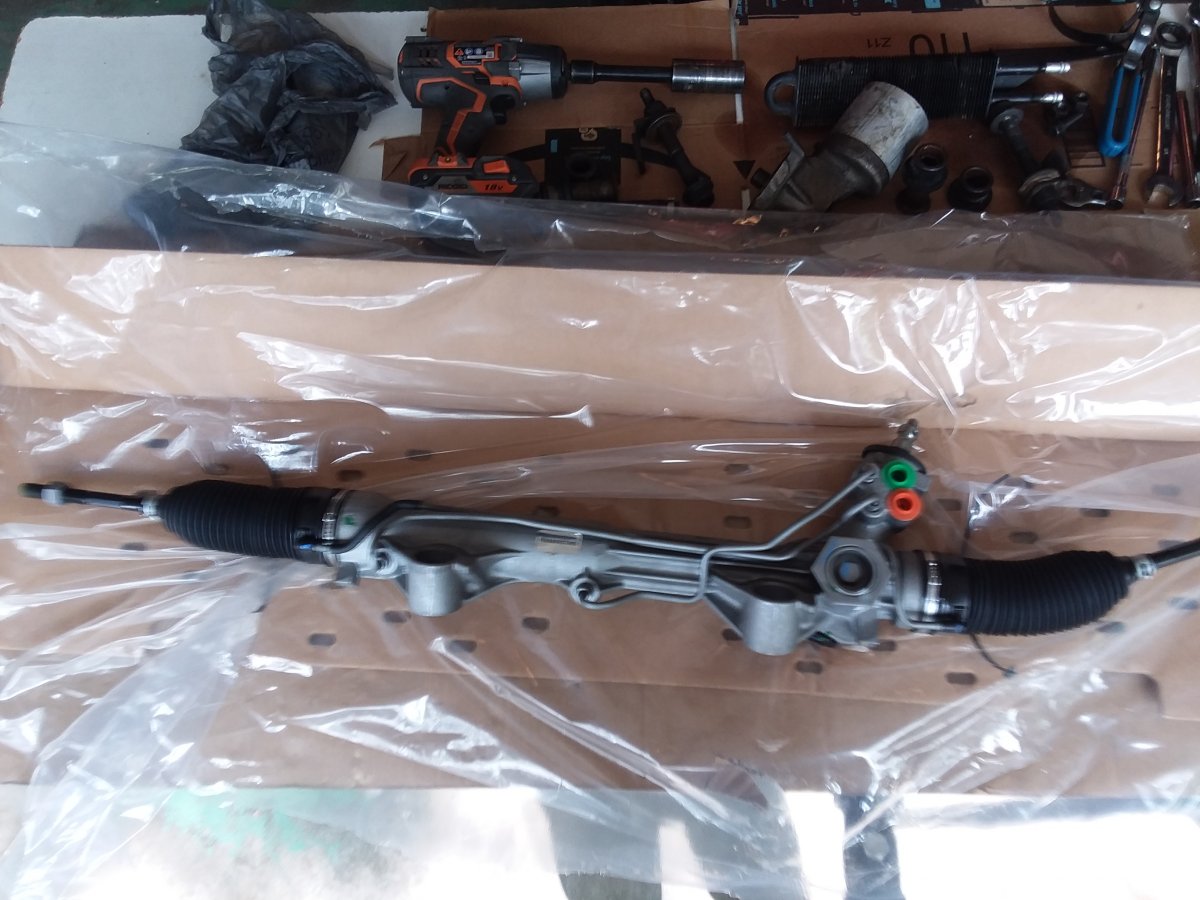

Last weekend, I pulled the recently installed Reman rack I purchased from Orielly auto in Colby KS, while on my way to CO. Stripped it of the mount bushings, and found the restriction valve in the correct port. I let the mechanic in KS know that too. He was sweating it a little I think, as he was relieved to here it. lol
I ordered that steering gear assembly I posted earlier last week, from my local Ford Dealership. They found it in Milwaukee, and had it shipped in. I picked it up yesterday. After opening up the giant plastic bag it was packed in, I found a shiny silver sticker on the body that said "ReManufactured" . Talk about being disgusted seeing that. I asked the parts guy at Ford, 3 separate times on 2 diff calls, and in person..... Why do they want a $200 core charge, on a brand new part? He simply said that's just how they do it. Yeah, OK buddy, now I know why. You sold me a reman as a new part. I really wanted to return that rack to Orielly, and get my $175 back. Well, not to fight it and add to my grief, I figured a reman by Ford using all Motorcraft parts is better than the remans I have been getting from the auto stores. I mean, it looked brand new, and 1000% better than those do. so I handed the rack over for the core charge.

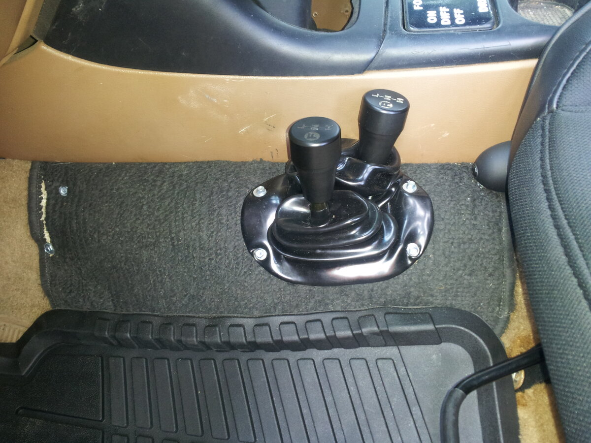

Atlas fluid change done today. Fluid wasn't bad really, but it wasn't that great either. Had about 4000 miles on it and been in there since fall of 2017, so it was time regardless. All I can say is one of the best shop tools I ever bought, was a good size transfer pump. 1 pint per plunge made fast, easy, & clean work for this job. Tube end fits snug, and stays put while working it.

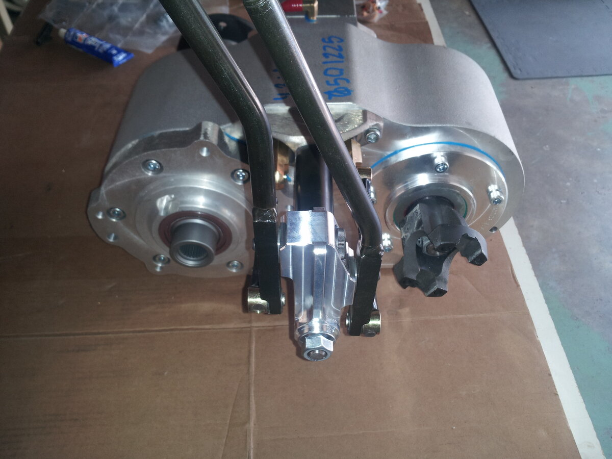

So while I was working on this case, I decided to tackle one job I have been putting off forever. The shifter's.
Skid & front drive shaft came out to make room to reach the shift rod linkage. The little circlip retainers on these rods are a frigging nightmare for me to work with. Small tiny things, that disappear into the void if dropped, or they shoot off while removing. Only enough room to get one hand up there to them, and arm is all contorted, and can't see what your doing, makes this a pita to do. Well, for me at least.
With them off, and secured in a ziplock (so they don't run away), the linkage rods can be removed from the ends of the shifter's. 19mm nut holds the shifter tower on the threaded rod to the case. Tower separates from the tube spacer, by prying them apart, and the tower with shifters are free.
Ok, what am I doing here?
The front shifter (outboard) hits the back of my calf where it is located. Thought about this setup long and hard for a long time, and had an idea. I decided to give a try at changing it up.

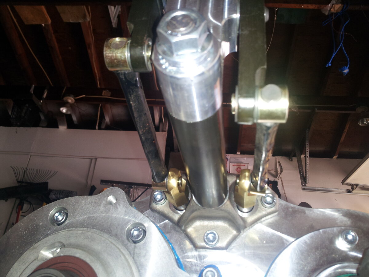

The shift tower that holds both of these shifter's is set up that each bolt to the sides of it. A bolt goes thru the tower for each, and are offset from each other by about 2" or so.
The case is clocked with the dr side dropped for the front shaft. The shifting rods coming out of the case are stationary, and with the case at an angle, so are they, with one higher than the other. The shift tower is also offset where the shifters are bolted, but the shifter's are of equal length, with bolt holes located exactly in the same spot. To remedy this, AA puts a hard angle bend in one shifter, that is supposed to make them closer to the same height at the knobs after case clocking. But.... The end where that 19mm nut is allows the entire assembly to twist about 1/2", which translates to about 2" of movement at the tip of the shifter's.
Confused yet? Yeah, lots to wrap your head around when staring at these things in an disassembled state. I think only those that have worked on these, would truly understand these things, and even then, might have to take 2-3 whacks at it.

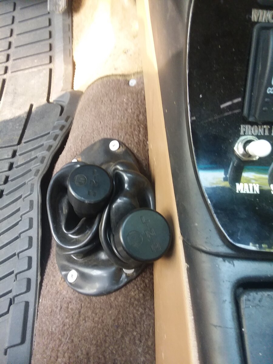

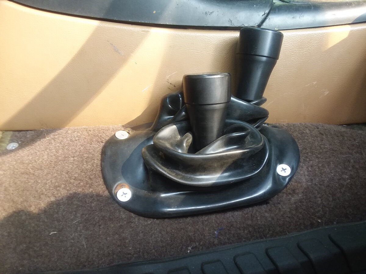

I had them mocked up to how AA showed them in the manual, but my console was in the way, for them to come up close to where a manual trans shifter would be ( to the left).
The shift tower had to be clocked outboard as far as it would go, to miss the console. That also reversed the shifter direction 180*. This put the front shifter into the back of my leg. They was even in height afterwards, but stuck out too far. I was thinking of just bending them, but wanted to try something first.
I removed the shifters from the tower, flipped the tower 180* around horizontally, and put the shifters back on. Remember I said the bolts was offset? So what this did was lower the front shifter, and raise the rear shifter. How? Because the case is clocked, and after clocking the tower, they are no longer compensating for that drop. So now, the front shifter is 2" lowered than before. Clears my leg...... almost.
I had some room for the inboard shifter to get closer to the console. Easy fix, just re-clock the tower, and moves them both inwards. Well, I still had room between the two shifter's. Lot's of room. Put the front shifter in the vise, and massaged it with a 4 ft pipe. Yep, ended up bending one of them anyways. LOL
I have about 3/8" between the knobs now. Tight as I want them together. Close enough that a finger won't get pinched, but far enough apart to work them without interference.
The end result is a go, I think. Still have to put the front shaft back on, and run it thru the gears to make sure it all works as should. (Cross the fingers everybody!)
Only bad thing that happened is the shift boot is all scrunched up, but it's a trade off I can live with.
Before
After
Of course this would only apply to those that have a center console, and I have a 3" body lift, but I found jackall on the webs about this, so maybe this helps someone, someday.
Ok, so now that this mod is almost done, I can now start thinking of how I can lower the Corbeau seat brackets 2", and get them back in this rig. Driving me crazy to see them bagged up in the basement.

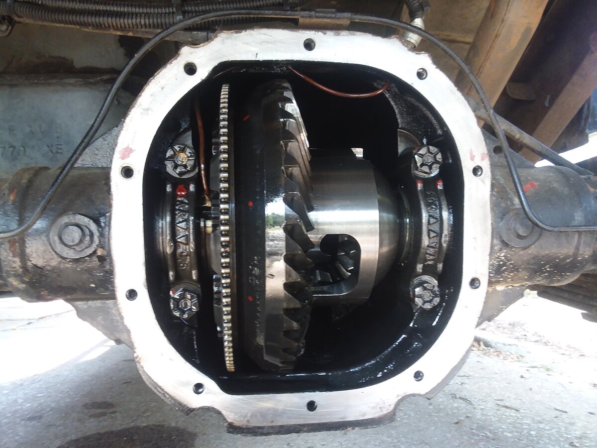

Today the Rear diff got the fluid changed. ARB break in period is completed. Got to see it in there for the first time. Meh, just a bunch of stuffs.
Ran a magnet in the valley. Fished out 2 tiny flakes of metal, about a pin head size. Was to be expected. Gear oil was dark gray from break in. New is green. Cleaned the re-useable gasket, and buttoned it back up. Refilled with the gear oil I purchased, from the shop that installed the ARB.
Had to adjust the rear Atlas shifter linkage rod. Wasn't engaging into low range all the way. 2 full turns out (longer throw) on the rod, did the trick. Skid plate was cleaned and installed.

Power steering rack swap. 1 qt Motorcraft Merc V

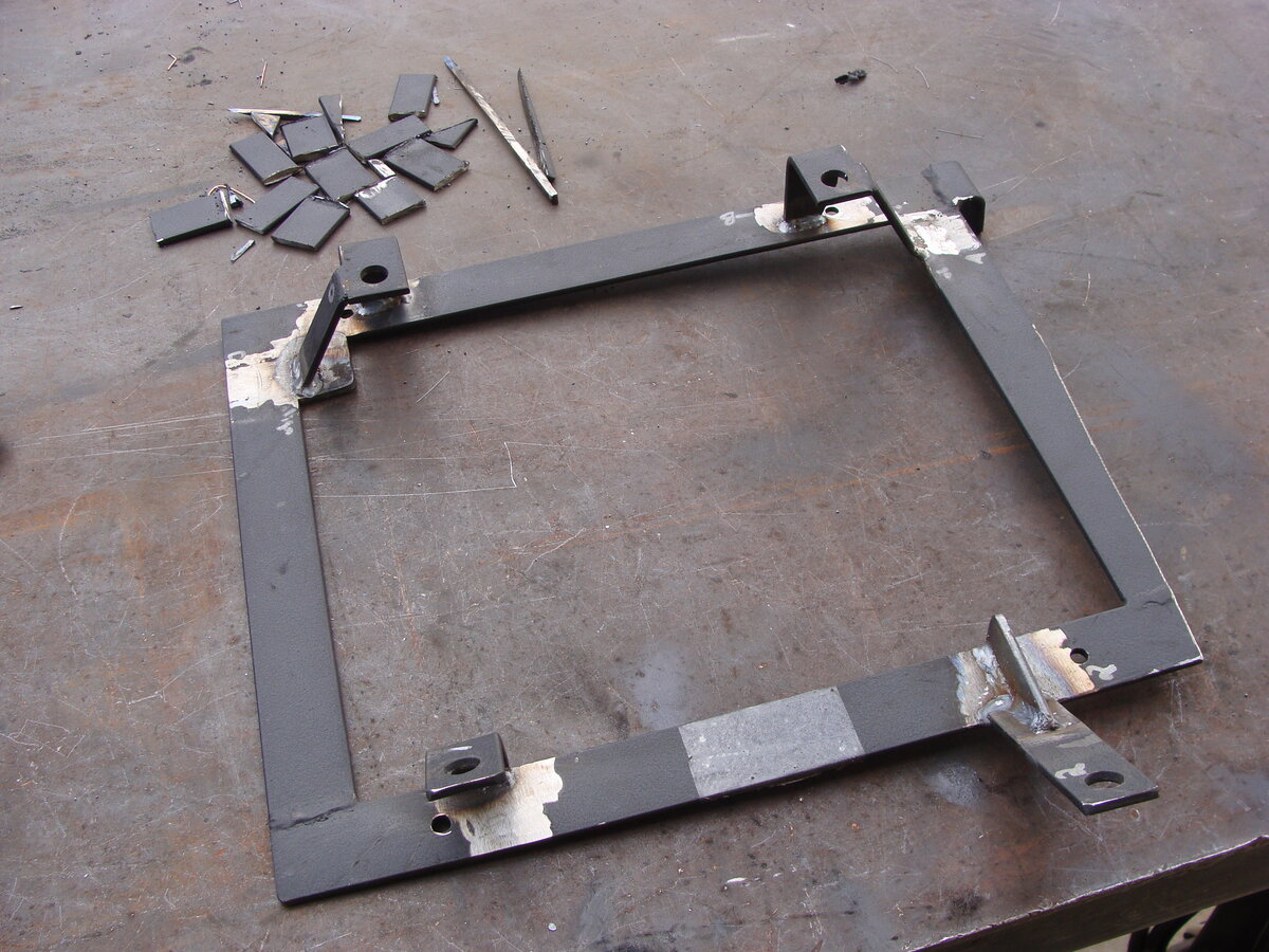

I had the same problem with my Corbeau brackets so I did a little chop cut and weld to them. Fairly straight-forward job, pretty sure I tacked them back together with them bolted in place and fully welded on the bench. These are the BII/91-Only brackets so yours will be a little different.
