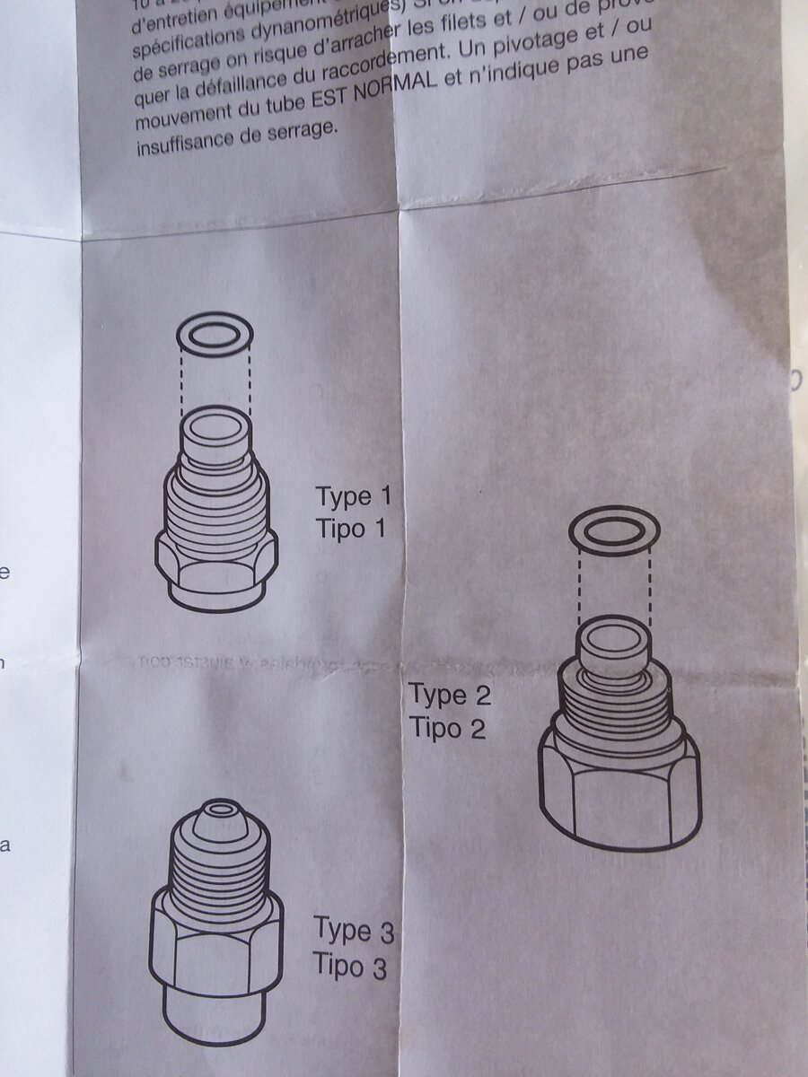

Got the old lines off earlier. Opened up the bag with the short rack to cooler line, and it had instructions. I don't always read them for simple things, but decided what the heck.
Well, it actually made me go "Hmmm".
It describes 3 types of fittings that Ford used on these lines. These instructions just don't jive with what I'm seeing, or used to. These seals shown are made to stay at the end of the fitting, and remind me of rubber O ring's. The lines come with pre-fitted teflon seals, at the end of the threads, under the nut. That's all I ever used on these lines for this rig over the years.
So it got me wondering, if there was at one time a small rubber O ring in the rack on one of those lines, maybe it got shot into the cooler or a return line? Got jammed in there?

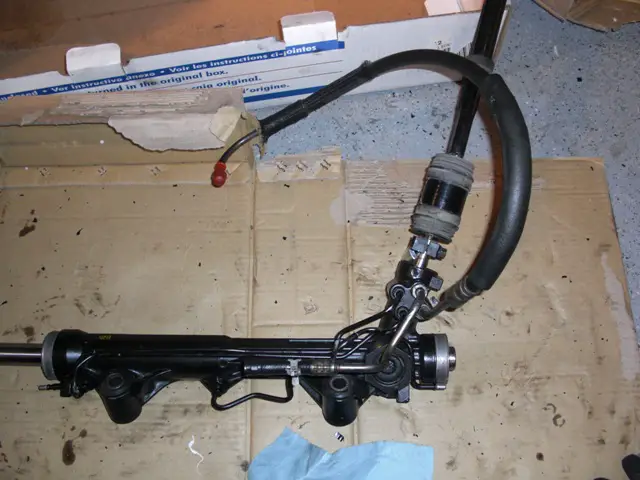

I hooked up a rubber hose, to the end of a fresh can of Kooler Clean, and blasted the cooler out. I collected all of it using a 2nd hose, drained into a plastic bottle. I didn't see any debris in the fluids.
The idea of using 2 ft long pipe cleaners to brush/force anything out of the cooler tube, proved to be fruitless. A trip to a couple hardware stores, resulted in empty hands.
I then tried a 1/8" steel cable to push thru the U shaped cooler line, but it would only go in each tube about 3". Weird I thought. Maybe that tube has a smaller ID to act like a constrictor to build pressure back into the pump? Dunno #2.
I am going to hook up an air line to the cooler, using fittings for a good seal, and blow it out with 150 psi, just for grins in the morning. Skeeters ran me inside.
So if there is something jammed inside that cooler tube, I really don't even want to use it anymore. Ford doesn't make them any longer, and these have built in brackets that fit the rack mounting bolt studs for placement. Figures.
So if I bought a new cooler, I am thinking of installing it, right behind the grill, in front of the middle core pillar. Reason being, is the big skid plate blocks air flow to the stock location for one, and the aftermarkets have no way to mount it in the stock location. If I got a small trans cooler, with tubes pointing down, I could run longer hose to them, from the rack & reservoir. I mean if a line blew, whats the difference if a trans cooler line blew? It's right there as well, just up against the radiator.
For now, all lines are off, holes plugged, and going to wait and see if I can find a new cooler, that will fit where I have room behind the grill.
Shipping always takes a few days, so I have another project on this I can start in the meantime.
Always something!!
Looked at the bottle of collected kooler kleen this morning and there was black sediment on the bottom.
Ran it thru a coffee filter. There is definitely something in that cooler tube. It's either bits of hose liner, or that rubber o ring. What ever it is, it made up my mind 100% not to reuse that cooler.

Edit: After removing the stock cooler, and having a look straight down the tubes, I found out why the cable wouldn't fit inside to clean it out. There is a fin that goes across the tube, on both ends. So this really has me believing my theory of something inside of it.
100% assist to the shop.
0% assist after rack and pump swap
50% assist after fighting the wheel on a trail, in low range, and something gave suddenly.
Something was on the end of the inlet tube, stuck on the cross fin after rack install, blocking fluid flow. That something was forced past the cross fin, and into the cooler tube. It was blocked by the exit cross fin, but only partially blocked the orifice, allowing some return fluid to flow.
