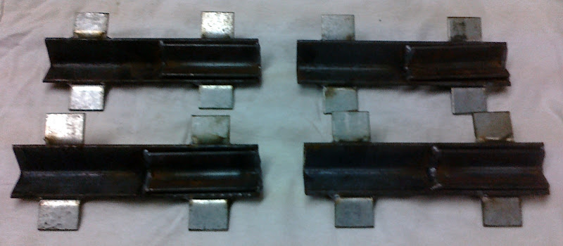

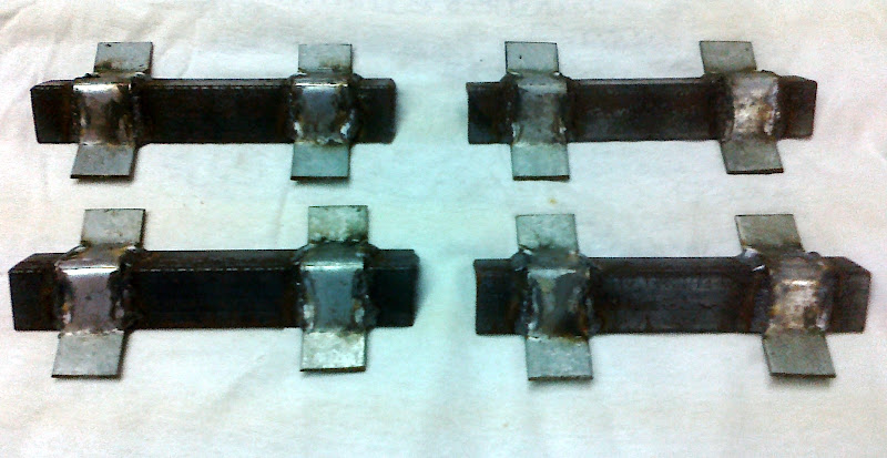

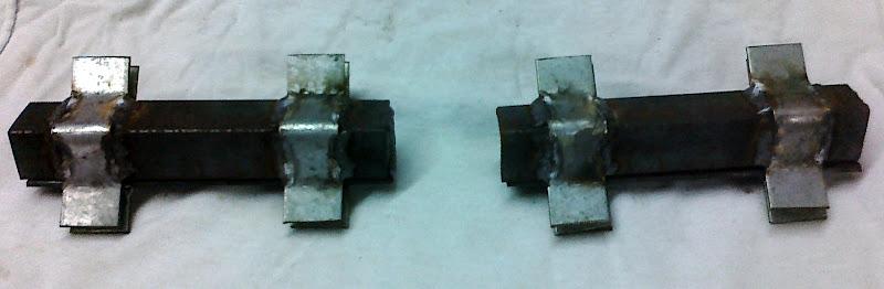

Ok, this is a crude design and I still need to drill the bolt holes, grind down the sharp edges, and paint them. But this is a much cheaper functional solution than buying the Dixon Brothers tie rods.
My solution is just some angle iron and flat iron welded together to surround the stock tie rods and keep them from being able to bend.
Top side
Bottom side
Together

Hmm, that will stop them from bending, but wont the stress be transferred to the connection in the rack? I really think that is a cool idea for the rods themselves. They just clamp on the rods?
Yes, they just clamp on.
