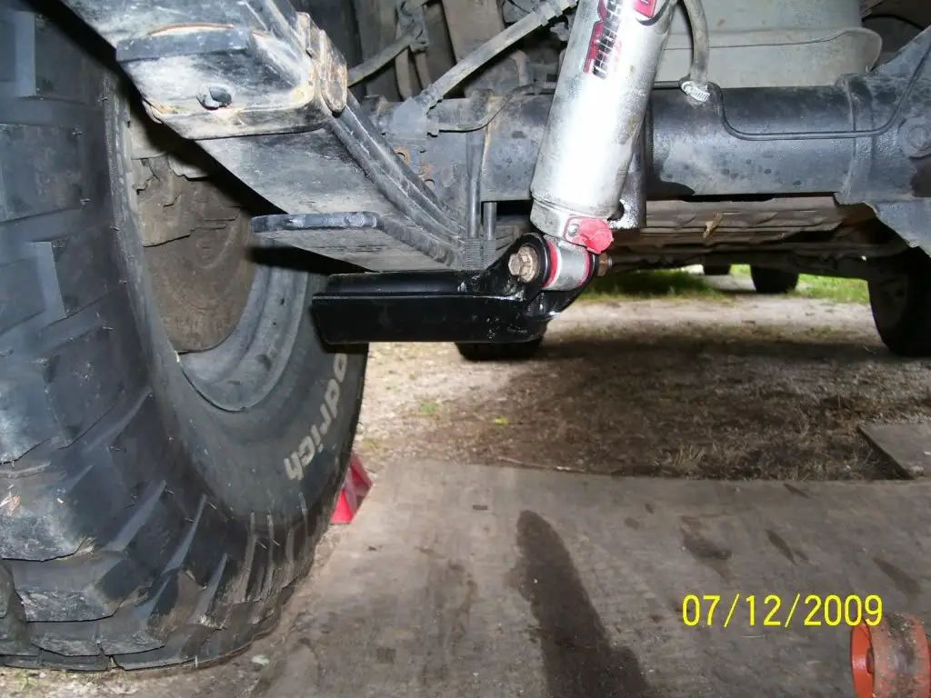

I ordered a set of custom Shock/u-bolt skids from Brian1 last week, and got around to installing them today. They are heavy duty 1/4" steel with shock mounts that raise the bottom of the shock by 3". No more hitting the shocks! I dont have to worry about ripping of my adjuster knob on the new Rancho's.:thumbsup:
Removed the sway bar as well. I got PB blaster all over everything in the process.
I had to take a break, so I took these pics and posted. Going back out in a few to finish up putting it all back together. The heat & humidity today is unbearable:(.
I wanted to see if i could use the rock sliders as a good place for the jack stands, they held perfect.
