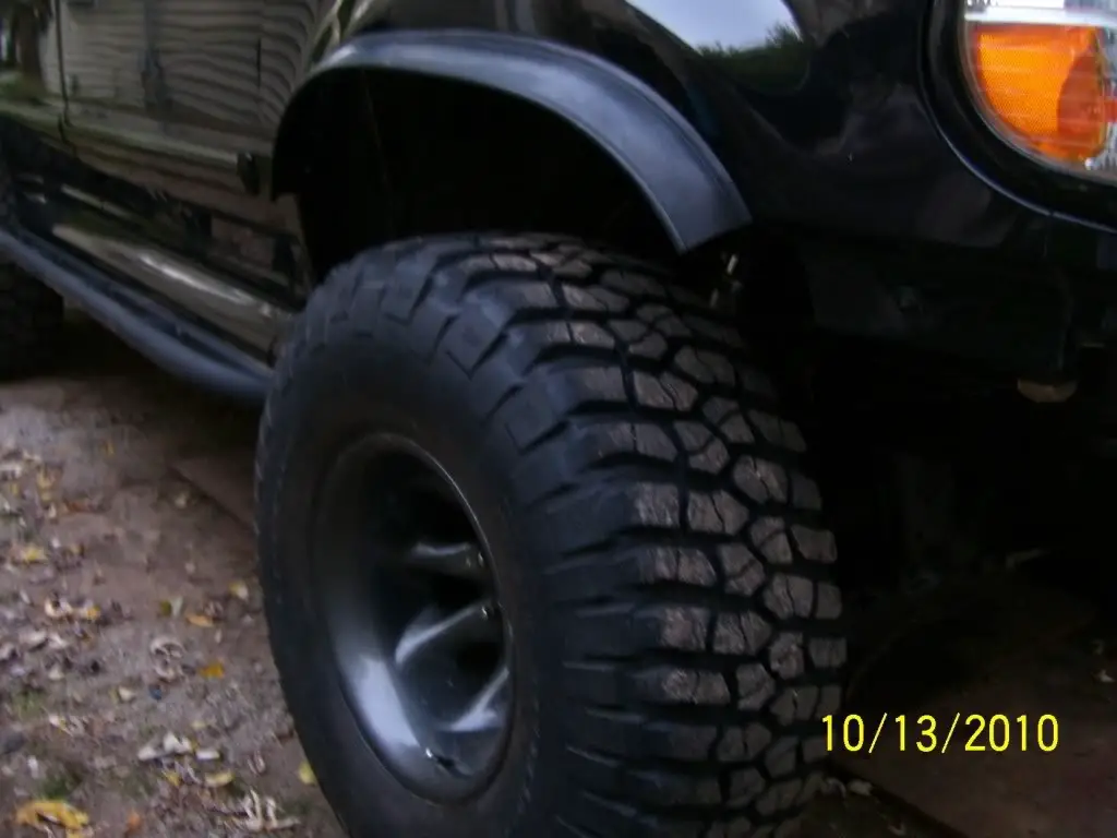

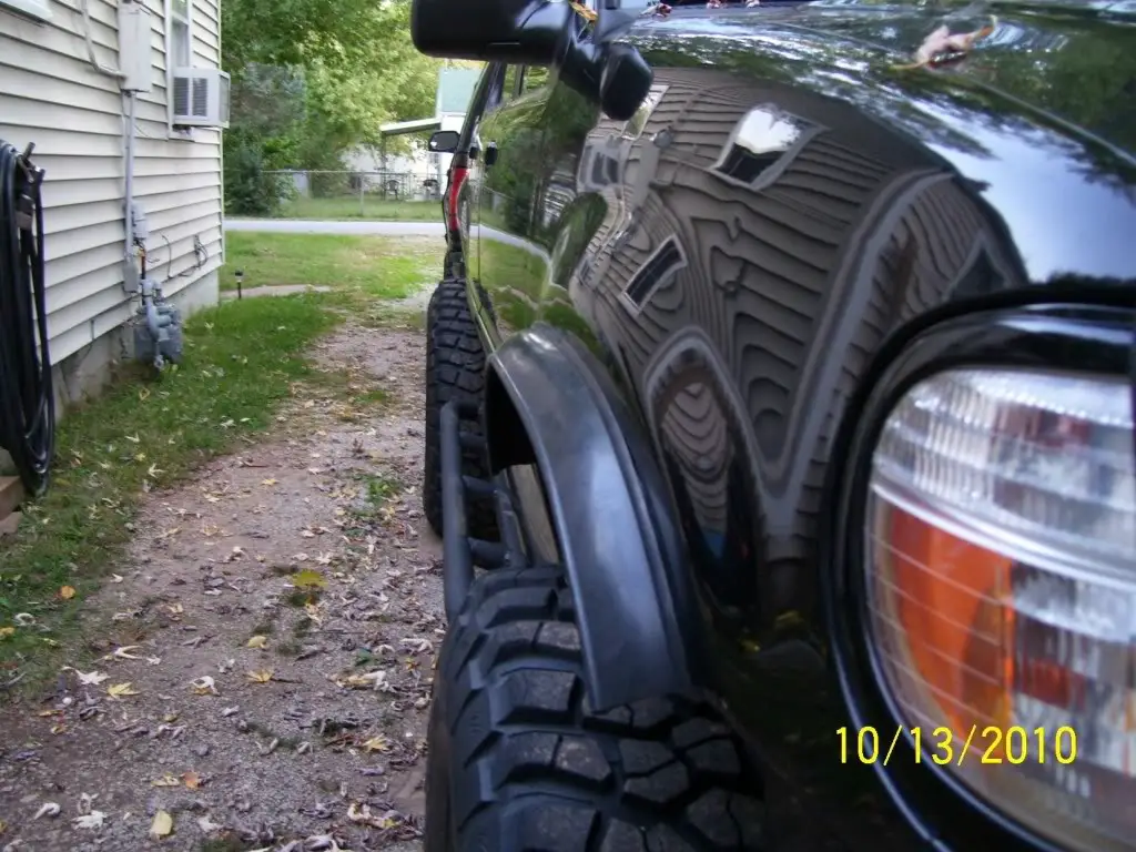

Pass side flare side view
Front angle
Front view

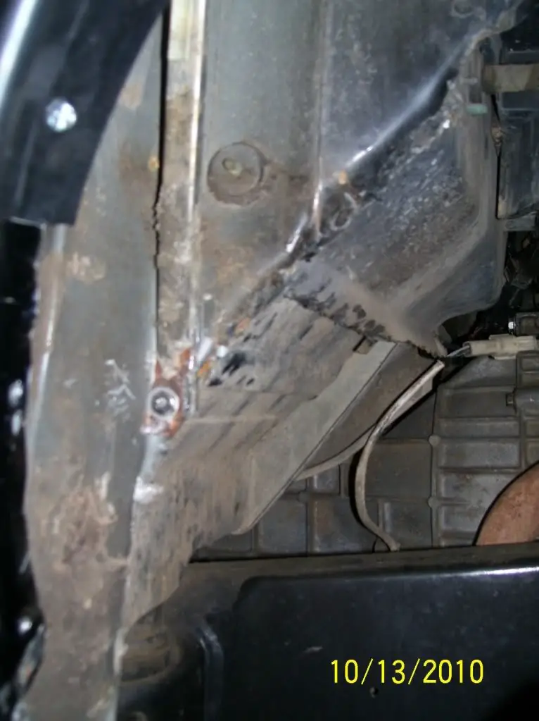

The pinch folds hammered flat. BTW...I discovered when you swing a hammer directly behind the fuel cutoff switch, it will trigger it!...lol
Drivers side fender well is finished being mutilated. :)

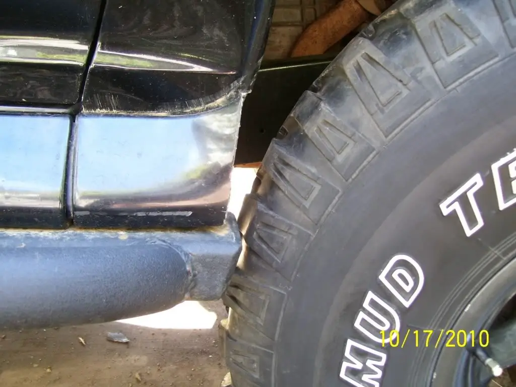

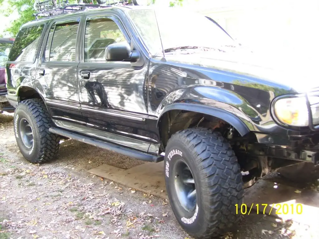

I have the 35" installed on all 4 corners now. I have an issue to deal with still. As I had previously predicted the Sliders are too long and the tires rub them at 1/2-3/4 turn on the lug edges. The rear has 2 spanking brand new tires, the fronts have 60% tread life. With new on the front, there would be no way the tires would even make a turn past halfway.
So, I have to cut the front of the "2x4" slider end off about 1 1/2" then weld back on the cap. :( I am trying to think if leaving them on, and cutting off the ends with a sawzall would be less work and effort than removing them to do the work.....????
Either way, it's gonna be the Suck!
19.5" clearance under the sliders.
Its getting dark out now, so pics will be taken tomorrow.
Got the sliders trimmed shorter, but still have to get the new caps welded on. Hopefully sometime this week that will get done. Left them on the rig, and used a sawzall & a grinder w/cutting wheel to take off a 1.5". Made a big dif in clearance.
Wheels turned half way and tire rub :(
Wheels turned 1/3 after the slider trimming done. :D

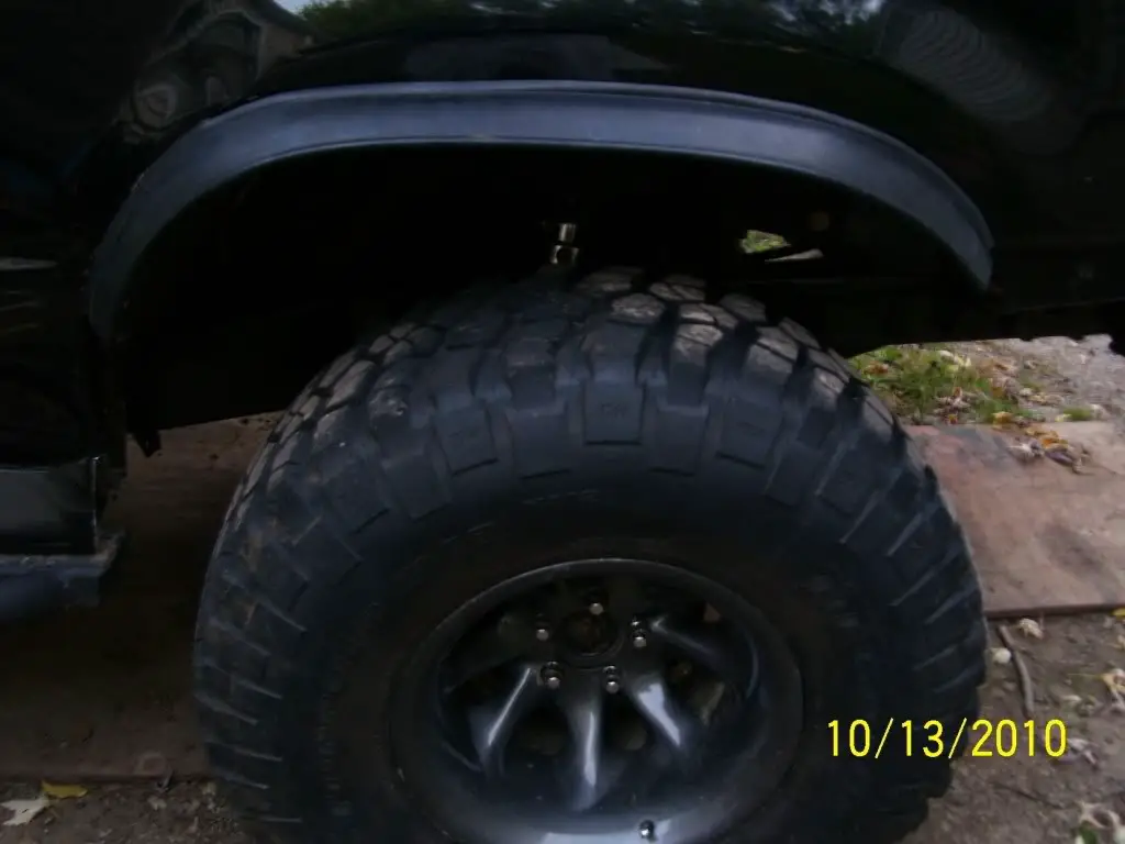

The front of the rear wheel wells looks fine, it's close but as long as there is no forward movement in the axle, everything should clear at full stuff.
The rear of the wheel well was a different story. At full stuff, the tire would definitely rub the fender. For street use, its fine.
I did remove some sheet metal to eliminate rub at full stuff. The chrome piece removed and all the fender metal was cut off below the trim line. Nothing new, as lots of people do this. The new bumper will wrap around some for protection. I do believe the exhaust tailpipe and tip has to be moved now.
