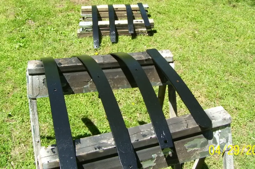

The F-150 leafs are off a 92 2wd. These are 2.5" in width (4wd are 3") and are 5 leaf packs. Years '80-96 are what your after for this mod. After cutting off the stock center pins and leaf clamps, the main leaf is discarded. The lower leafs, including the overload leaf is used.
Here is a nice spring chart to use for reference use.
Here is the 4 lower leafs cleaned & painted.

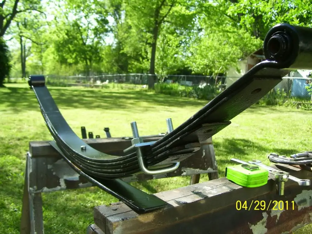

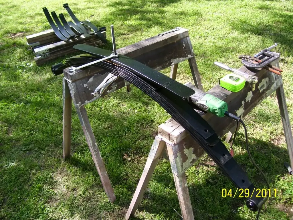

I re-used the Ex main leaf, a single leaf I had made from a spring shop that was added to my old packs, plus a short add a leaf. Here they are stacked and the 1/2" center pin bolt installed loose. You can see the arch diff in them. Each leaf you install in the packs will net you up to a 1/2" of lift. There are 7 leafs in these new packs.
Use a couple C clamps to draw the leafs together, then simply tighten the nut on the center pin nice & tight.
Cut the bolt to size. You can leave a little of the stud on as it will fit inside the hole on the plate. Just don't leave too much of it.
I ended up using some 2.5" U-bolt style spring clamps until I can get a diff style. 2 flat stock bars with bolts are better to clamp them with than the U-bolt as it offers more surface contact and less stress to the leaf. As soon as I cut & drill some up, I will replace these. Here is the packs finished.

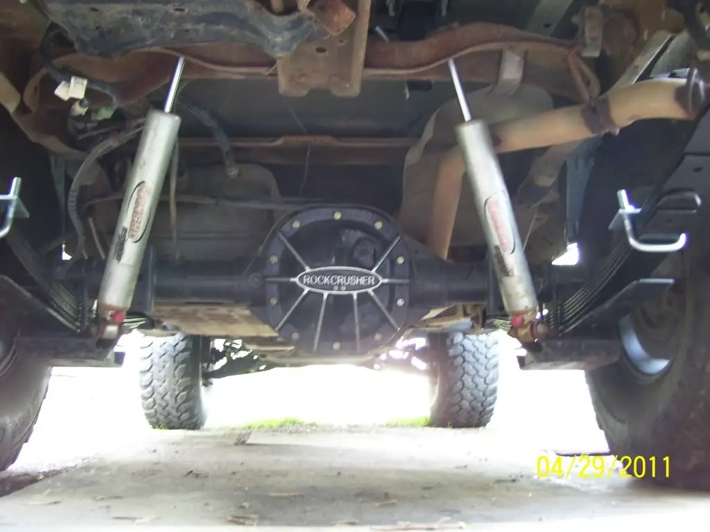

Getting started with the install.
Both sides installed with stock shackles.

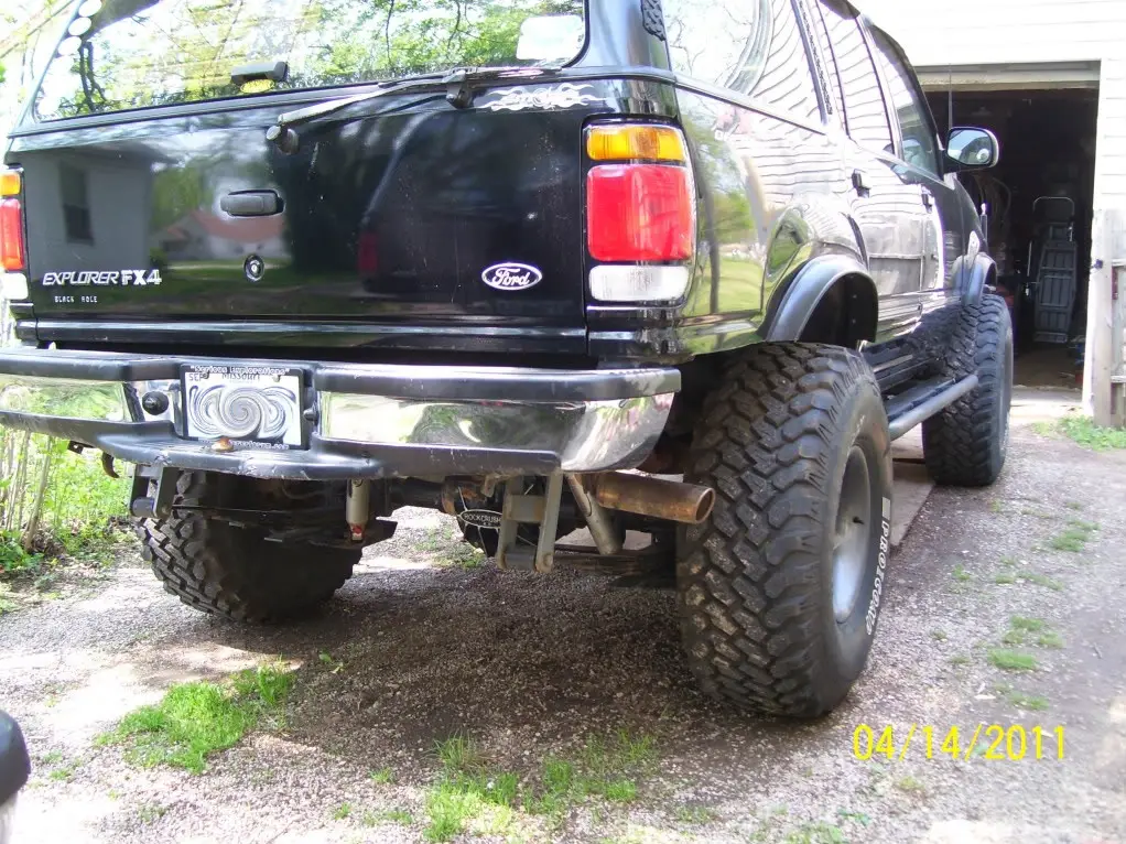

Before with war153 installed.

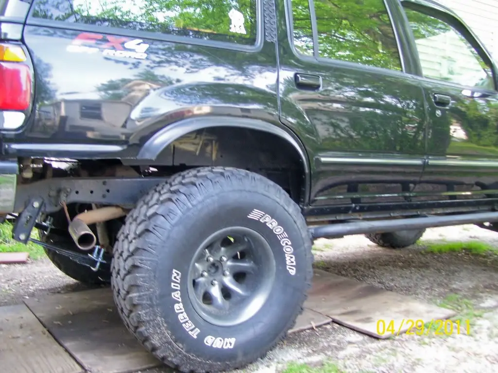

After with stock shackles and new leafs.
Objective accomplished! I got 4" of lift with these new packs, and have the needed lift for the 35" tires. Total cost for these packs with hardware/paint.....$100

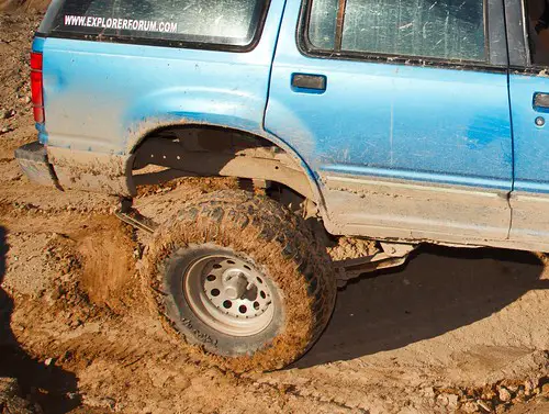

Did he say what to use to keep the srping from splaying apart without limiting travel? I can get 2" separation from my main spring and the 2nd leaf at full droop which is currently limited by shock length.
This is what I mean.
Spring speration by maniak_az, on Flickr

Mark, he recommends them to be clamped together on at least one side, and if you can on both. Thinner leaves(lots of them too) is the only thing that will give us more flex, and articulation w/o being too stiff. I thought about not clamping them so they can articulate more, but wheeling where I do, there is too much brush that can get snagged in the gaps. Tree roots are stronger than one might think.
