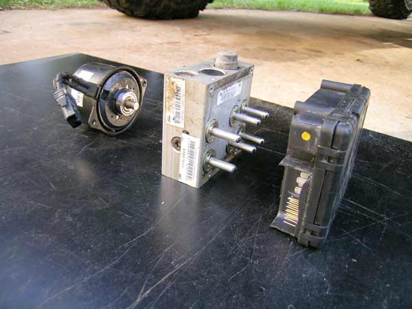

as far as I can remember, you only need the electronics part. Below is the modulator divided into its three main components, the motor, the hydraulic valves (where the brake lines would connect to) and the electronics. I only kept the electronics part plugged in and discarded the other two. Speedo still worked (drove it to the trails a few hours away and speedo still worked)
