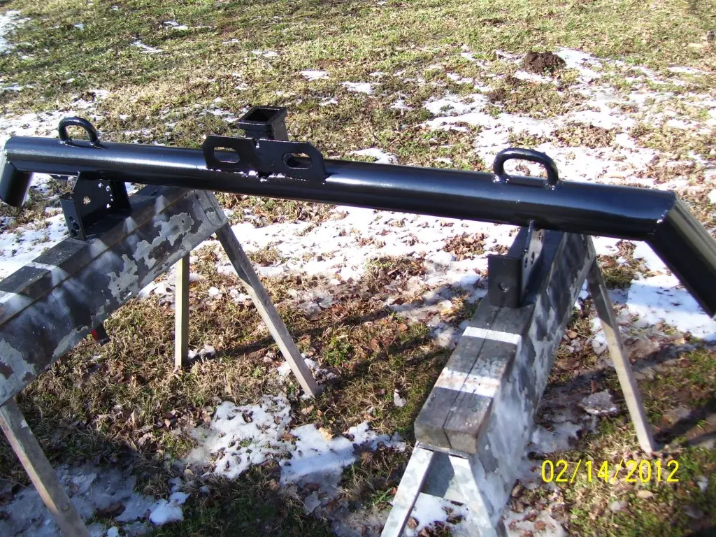

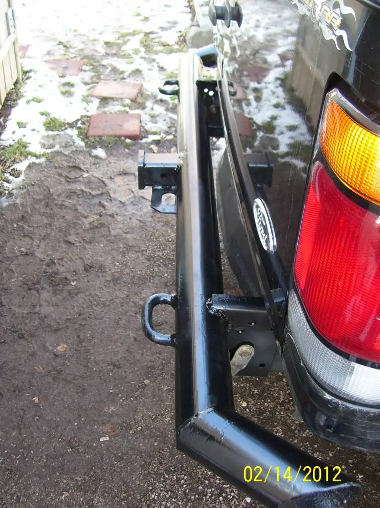

Got a beat up used tube bumper a while back, and decided I can make it work with a little tweaking. Had to run some new welds here & there, make some mounting brackets, grind it clean, and paint it.
This is just temporary and there is more to add to it, and change up a bit in the future. For now, it should work just fine.
Getting the brackets on.
Shop supervisor.
Painted.
Installed.

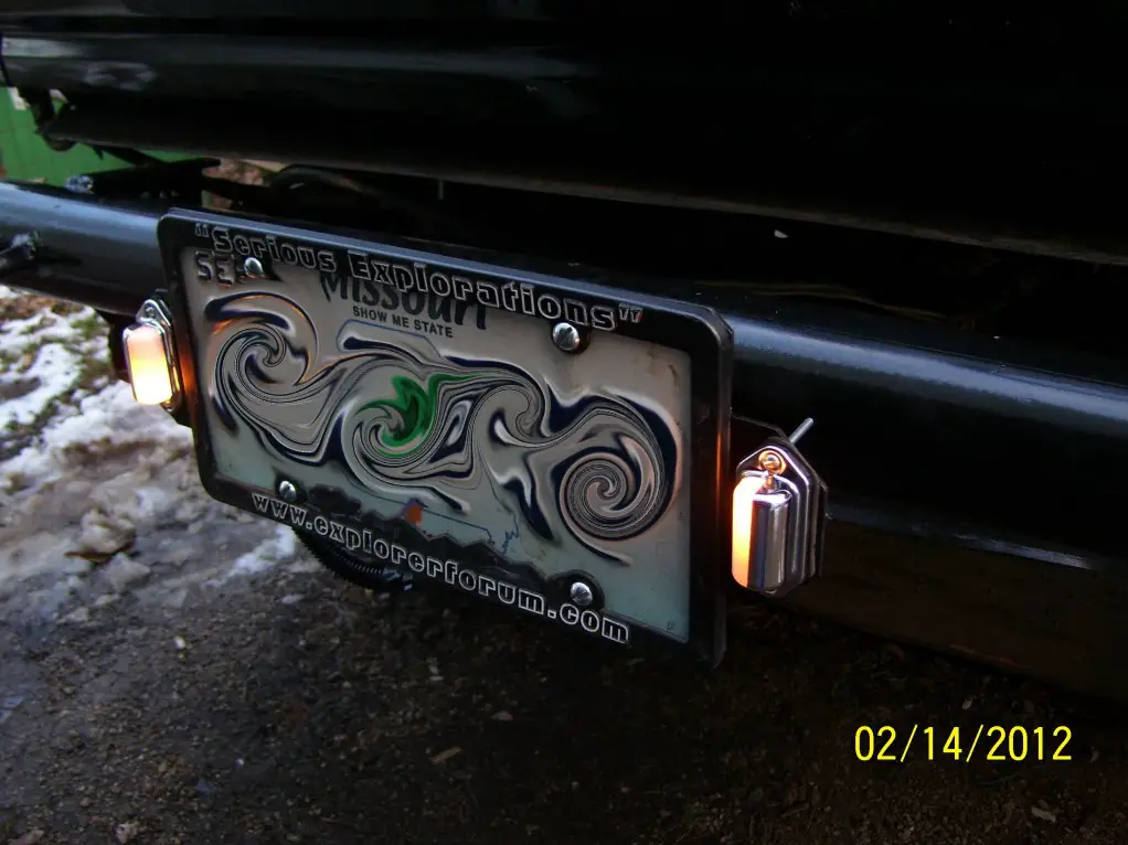

So with this bumper, there really wasn't a place to mount a plate. I really didn't want to attach it to the back hatch either as eventually this will get a swing out tire carrier with a spare fuel can.

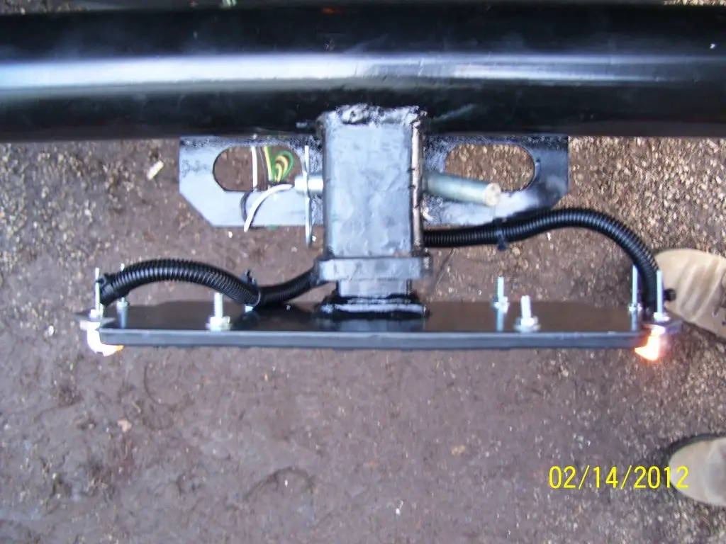

So as was posted earlier, the plate mount was made to be removable when not needed, and I wanted it easy to do so. Here is what I came up with.

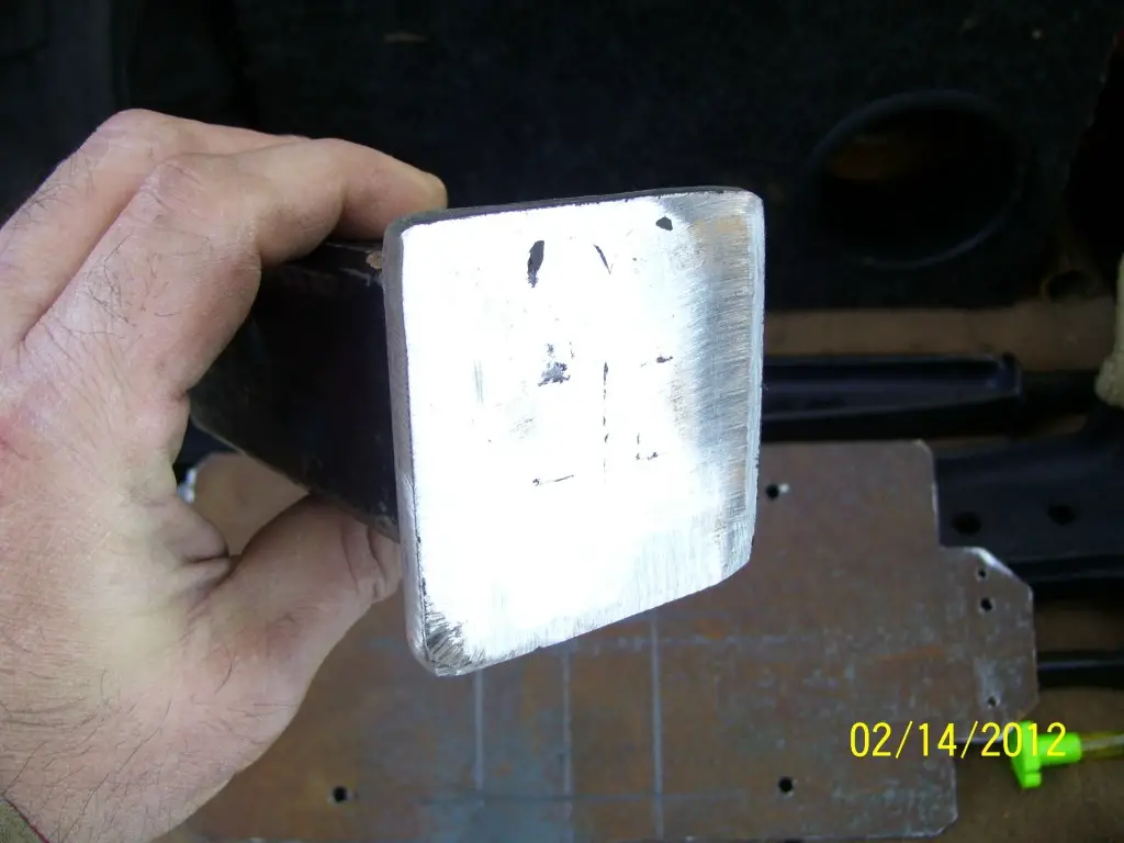

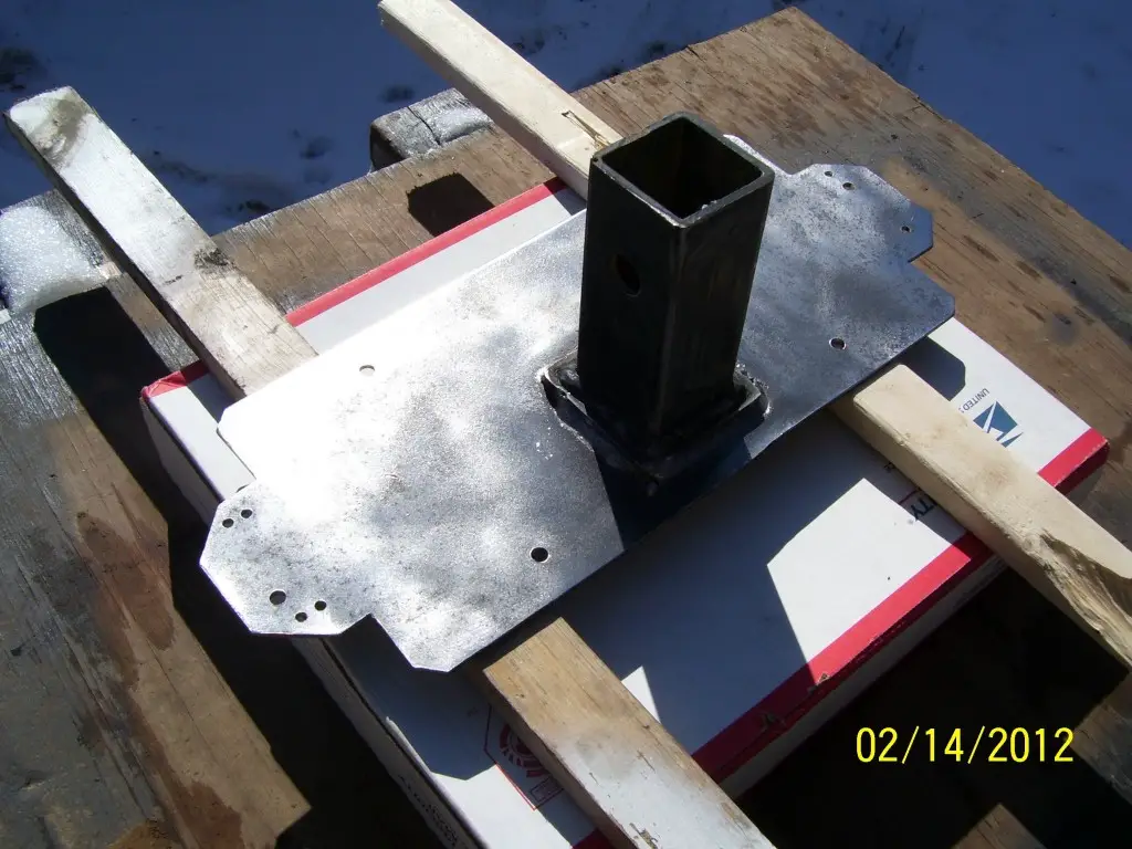

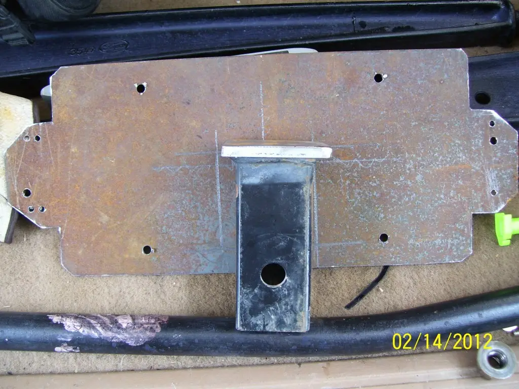

1/8" plate cut to size of a tag, plus tabs for lights. Used the tow strap hitch mount, cut off the tabs, and ground it clean.
Welded the two together and made it offset so it don't sit too much lower than the bumper.

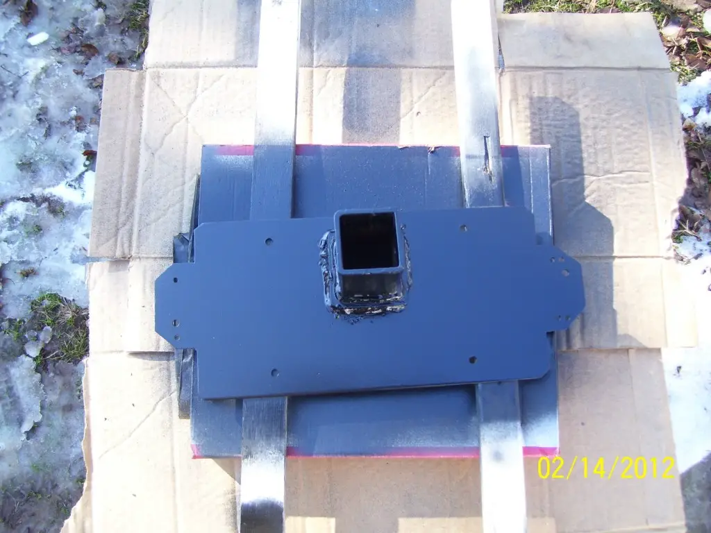

Primed it.
Painted it.

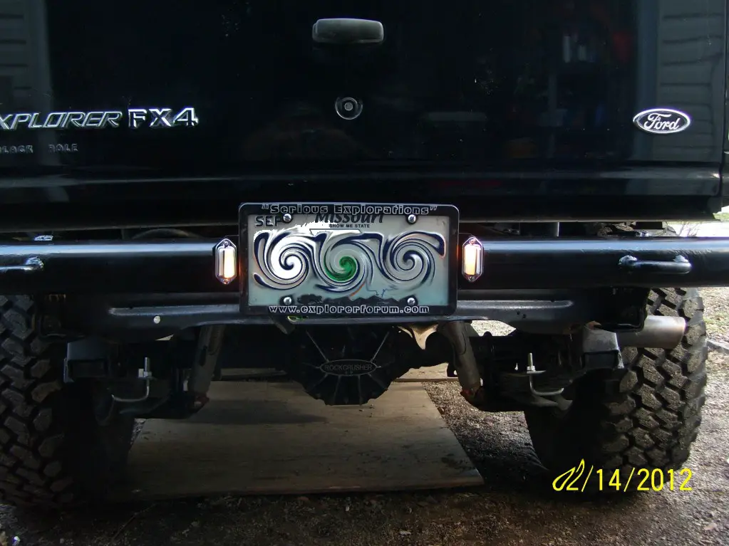

Wired the lights using one half of a trailer light harness, and installed it. Still need to cut down the bolts on the backside a bit.
The bumper itself will get a 1/4" plate added to the top to be used for a step, and to install the swing out hardware to.

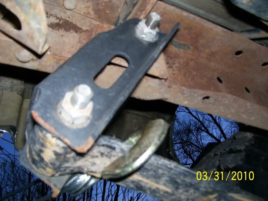

Not really a major job, but took most of the day. Brackets (1/4" channel) were the hardest part to make, as coming up with a set up for a bumper that can tow, and have a 3" body lift that still looks okay, was a mind melt at times. Once the decking plate goes on, it will look a bunch better as it will fit nice and snug directly under the hatch flap just like the stock bumper did.
