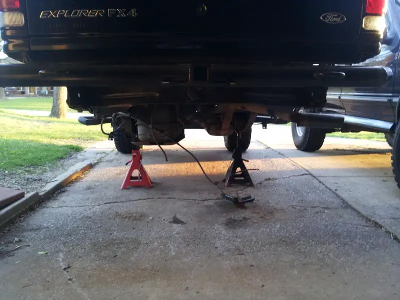

Now I have found another issue doing this. :(
The rear leaf hanger sleeves in the bushings are both pushed out to the right by 3/4" !!
So..... Any advise on replacing the bushings/sleeves? All I can think of is an air hammer/chisel to get them out. But even if I can do that, then what? Stock or aftermarket replacements? Are the stock one pc or two? Better to use a one or a two pc replacement? I have never done these yet. Ugh...:scratch:
So as usual, one thing leads to ten things. LOL!
All the leaf spring bushings need replaced as they are toast as well. I am going to bring them to a spring shop and have them press them in. I learned my lesson a long time ago with these things. Before I take them in next week, I will do that keeper mod over the weekend. I found the elevator bolts at Lowe's, in the specialty drawers. :thumbsup:
I will most likely take the rig back to the 4x4 shop or the spring shop for the frame bushings, after it is all back together. I just have too many things going on at once, and only a few weeks to be done. It is what it is. That's the way it goes.

While the axle is being worked on, I can work on other items at home. Like getting the new front & rear cameras, dual monitor switch & the cargo tie down tracks installed.
Today is cleaning day for all rear parts removed.

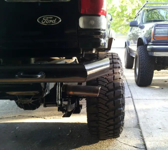

Decided to remove the leaf eye bushings myself today and install the Energy Suspension poly bushings I have from the kit. Small eyes fit perfect. Large eyes, not so much. They are 1/2" small in OD then needed. So... I found out that they are supposed to work for 91-94 only. I guess the 2nd gens have a much larger front eye. Guess I am going to the Spring shop here after all. Well, of course it's a Friday night, and I have to wait until next week.
Axle is home, and I have a coat of POR15 on it already. Looks like the leaf spring debacle is holding up the install. :banghead:
One thing I didn't think of when doing the C-clip eliminator, is I lost the hub centric rings, as there is none on the Yukon Chrome Moly axles. I have to rely on lugs alone. Well, the new wheels are going to take an acorn lug with a shank. I found out they are called "Acorn ET". ET stands for extra thread. So this means the nice new black set of Gorilla locking lugs I bought, are not going to work. This will be the third item I am returning to Amazon in 2 weeks. Before this, I never have. lol
Wish we had a flip off emoji here, because I would use it with this picture!!
The reason for all the rear axle work.... A cracked Crush sleeve on top of the now useless C-clips.

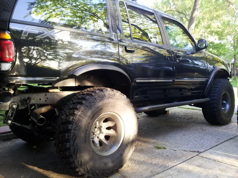

Rains stopped just in time for my one day a week off. Managed to get the rear all back together today. I might have broke myself in a couple places doing it, but by golly, I did er done!
Only thing I have to do is make a longer pass side E=brake cable bracket. the old one was way to short, and was cutting into the cable when flexing on the trails. I will get to that later in the week.
The rebuilt leaf packs give it a bit more lift, and it sits level now, (no more gangsta lean). The rear drivers frame rail reared it's ugly head on me again during the install. I had to fight to get the shackle bolt back in the eyelet. I have to find a place to fix that. That bend is causing the shackle to lean to the pass side, and forces the axle to the pass side a half inch past center. :( I almost went and bought a hydro ram to do it myself, but I figured it would just bend back as I'm pretty sure there is more to it, then spreading it apart, and expecting it to hold in place. So I didn't go through with it. lol
Every chance I get after work this week, I will be working on the front end. New coils, and UCA's have to go in. Since I took the time to clean the rear as I worked on it, I have no choice but to do it to the front as well. Function & looks for these mods. I can't stand rusty parts, looks like crap to me, and I take pride looking at my hard work.
