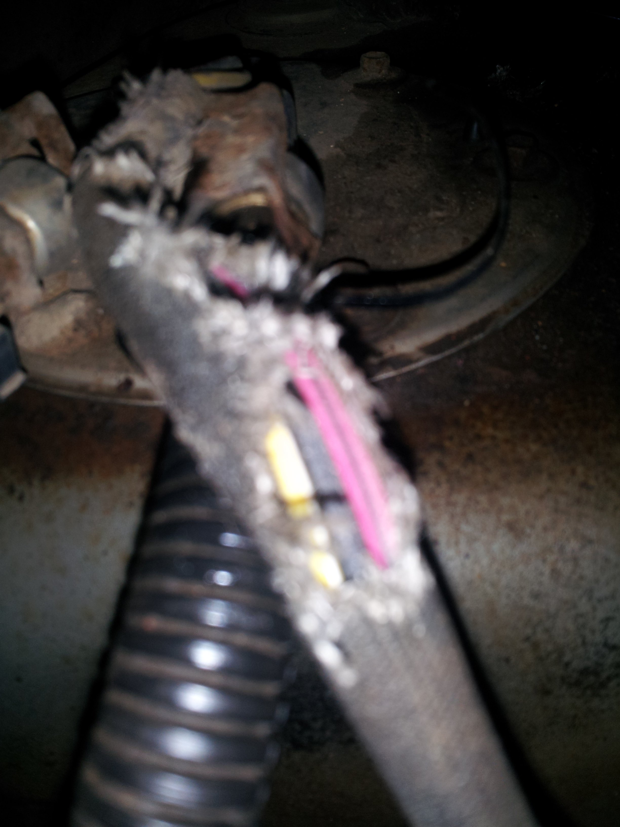

So the rig has been sitting for awhile, and about once a week, I let it run for a bit to keep the juices flowing. Today was another one of those days. I started it, and walked away for about 10 minutes or so. Came back to find a nice big puddle of raw fuel on the driveway! Looked under and seen the problem instantly.
In the last week or so, I'm guessing the Squirrel's decided that the top of the fuel tank was a good spot to sit around and have a snack. The 3" body lift creates plenty of room for them. They chewed threw the wire harness sleeve, but I don't think they broke a single wire, as it runs just fine.
I guess they decided that the rubber high pressure line was tastier, and managed to chew right into it. It squirts pretty hard when engine is running. SMDH!!
So, this line is under pressure, and I am assuming it is the feed line to the fuel rail. Since I have yet to drop this tank, and know how the lines are connected in the frame rail, I am not sure how to fix this. There has to be a pressure connector on the other end of this line that goes to the hard fuel line, right? I can't see it, and am afraid I have to drop the tank to find out, or to get my hands on it.
This is not a welcome repair, as I have other work to start on very soon. A week long wheeling trip is coming up in a month, a few states away, and I barely have time to get ready for that as is.
If I drop the tank for a new fuel line, the pump is getting replaced too. The pellet guns are at the ready, and any rodent I see, is getting blasted!!
