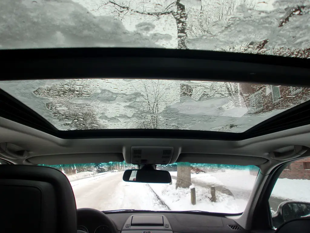

BMW X3 has a massive roof:
Pretty cool,something new but once you start there's no turning back..

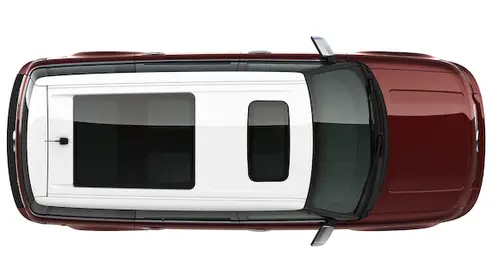

The Ford Flex has a roof that would work:
Or you could get one from a Land Rover if you wanted a larger one:
