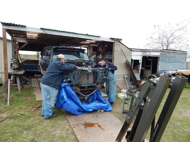

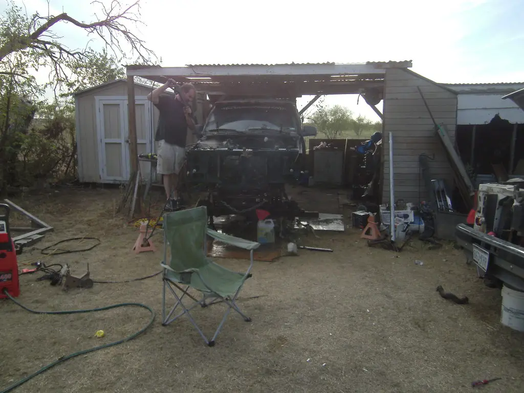

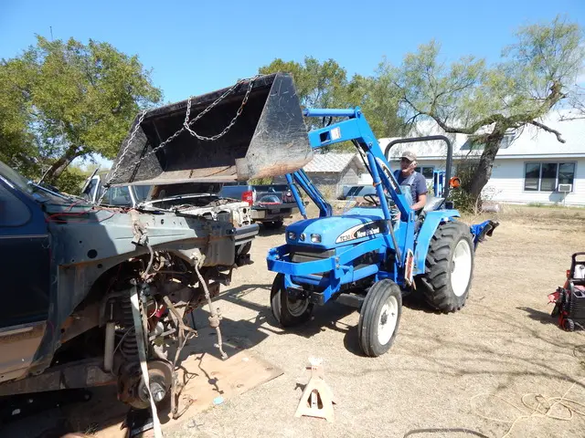

Had a great day. Russell got here and we got the engine out of the Buffalo.
Have the other one almost ready to come out. Will get that done in the morning. Hope to have it in and running tomorrow. Will not have the rig it self road ready, have to wait till next weekend to get the manual transfer.
Some more pics from Saturday, I have none from Sunday.
Sunday was a typical day for doing an engine swap, most items went well, but towards the end when installing the donor motor into the Buffalo, murphy's law raised his ugly head. Still moving forward.

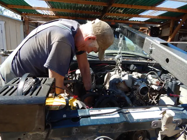

Got the engine set correctly into the engine bay. We had been using the tractor for lift due to height, but it was not feasible for setting it back in, the hydraulics on the tractor are just too touchy for minor moves and had no left to right controls with the system. So we got a engine hoist from Harbor Freight and used it since the motor was already in the engine bay and did not need to be lifted but a few inches to line up on the motor mounts.
Robert went ahead and replaced the spark plugs since there was plenty of room.

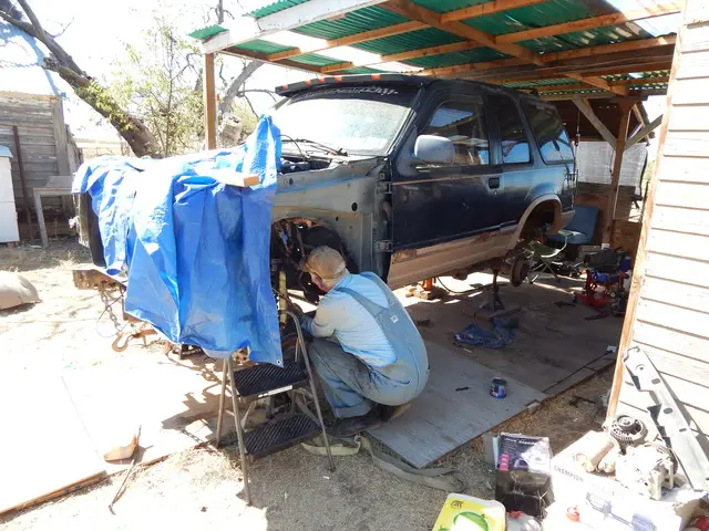

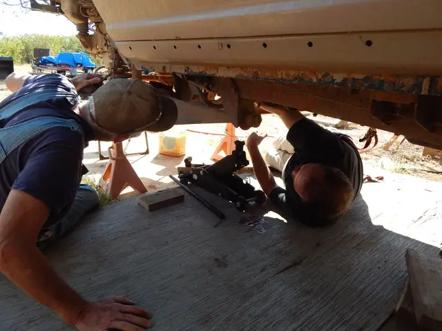

Good day of working on the Green Buffalo today. Xmission and xfer case are reinstalled and reconnected. I only have two pics from today, Robert has a few more.
For those who know how Robert and myself bi#@h at each other when we work together, you would of had several good laughs today. Too bad we didn't get them on video. :D
Robert working on the exhaust nuts and bolts.
I have no idea what he was doing at this time.
Like Mike said was a great weekend working together on the Buffalo. We are getting things done, even with all of our miss haps. As much as I hate to say it, but Mike was right one time:(. It was ok - I got him back later :D .
This is to show the trans and transfer back in place. ( Now it they work is yet to be seen :D )

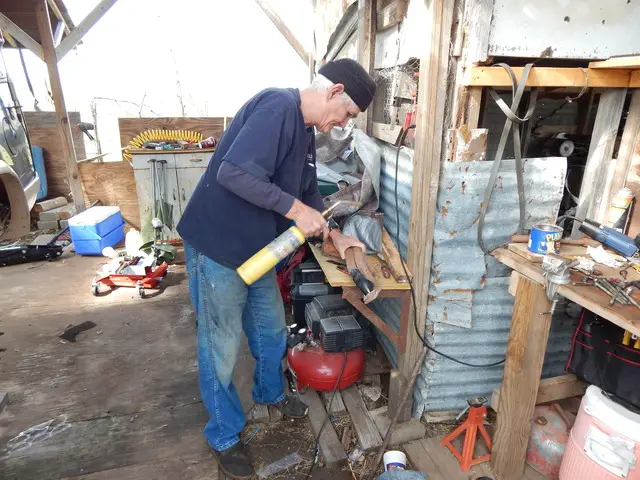

Robert playing with heat and hot stuff!
Putting the r/s exhaust back on, and of course stripped two mounting holes, gonna tap them tomorrow, like normal, the tap set is at my house.

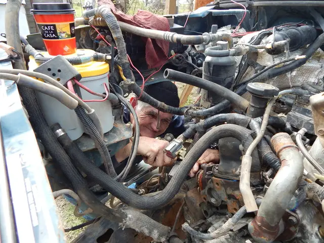

We did get some wiring reconnected and accessories remounted.

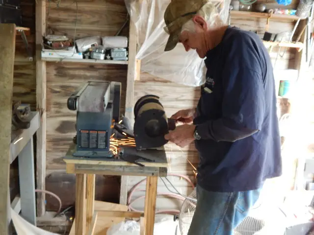

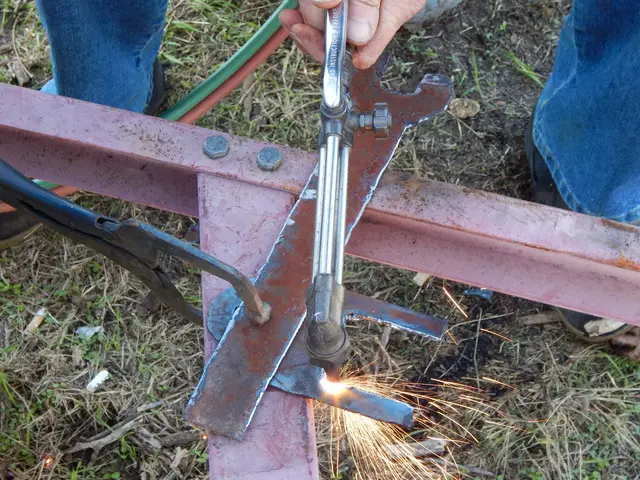

Got to do a little more on the Buffalo today, started off by having to make the fan clutch tool.
May not look purtty....
.... but it works just fine
Beginning to look like a rig again in the engine compartment

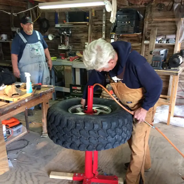

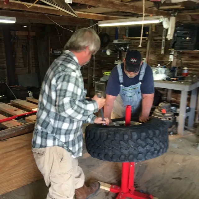

Mounted the tires for the Green Buffalo today. We ran into Temple yesterday and got a tire changer mount from Harbor Freight ( and a few more things of course :D )
The mount does it's job, but one thing we noticed is the bead tool is not very good, we are just going to replace it with a good one. And it needs to be anchored, but hey, for the price and what we are doing, it will work.
[MENTION=173980]easymc[/MENTION] and [MENTION=296339]willie s[/MENTION] doing their thing.
In order to soften the rubber to make it easier to mount, we put the next tire near the stove to heat the rubber some, it did make a slight difference in mounting on the rim, plus it was an excuse to light a fire.

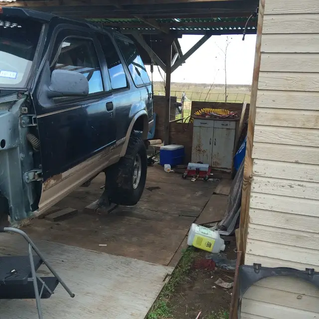

They are going to look pretty good on the Buffalo, here the rear end is still on jack stands.
Some more to do tomorrow before the weather turns.

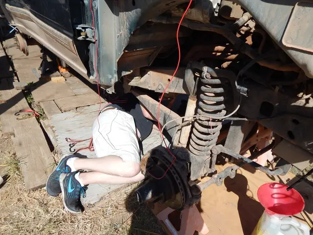

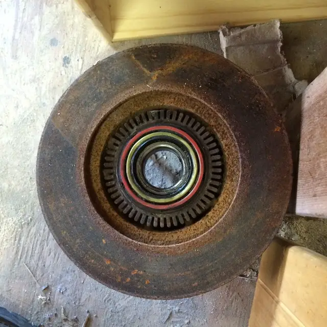

Who has seen this set up on a front hub on a X?
We were just going to replace stripped studs, when we got this "WTF?". The gears do not mesh into anything on the D35, and how to remove the gear to access the studs is unknown to us. There looks to be indentions on the gear to put a special tool, but am not sure what they are actually for, and even using a BFH or pry bar was out of the question, did not want to cause damage.
Well that's a big "duh", :banghead: :banghead: that makes my face tight. Thanks Russell, that good ol' search button answered the rest of my questions.
