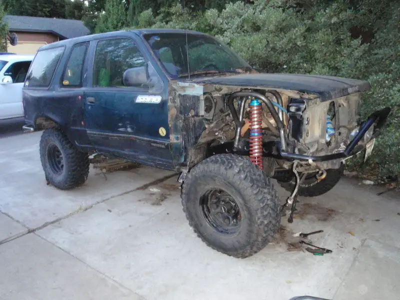

Plateage and start of engine cage

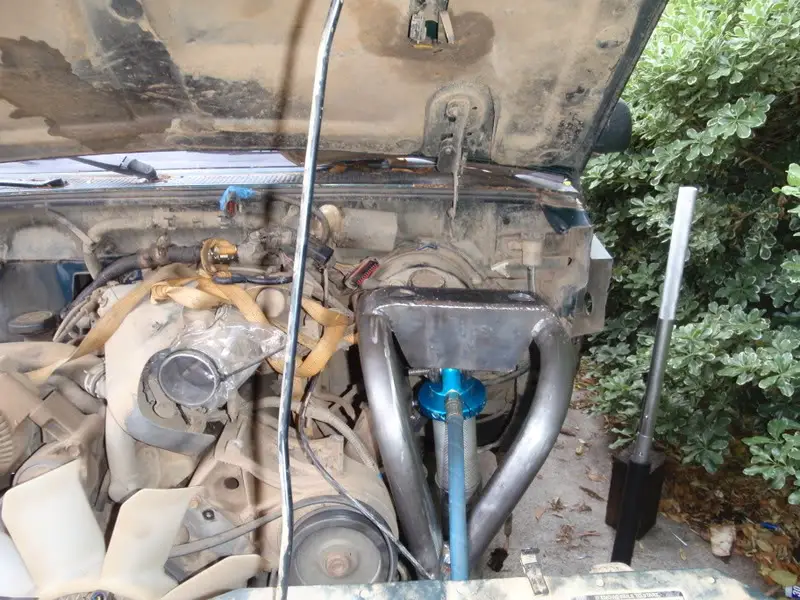

Had to get creative with the funky frame on the driver's side
Gussets on the motor crossmember so hopefully she won't bend next time
305 swap on my buddy's yota is going pretty good
Question about 9" swap...Am i going to need to swap in a different master cylinder and/or brake booster to switch from 8.8/drum to 9/disc? I'd hate to design my cage around my current stuff then have things not fit up if I have to throw in a different master down the road. I need to do some research but if someone knows off the top of their head that would be great.

I got one side of the shock hoops pretty well done, still want to do some gusseting tho. It will tie into the cab cage and have a cross-bar or two down the road as well.

nice work Josh, so did your inner fenders have a date with the saw-zall? I was eyeing mine up wondering the same thing. I've got a set of 37s I'd love to squeeze in there. You got glass fenders that are going right over the top?

Thanks man! Yah I chopped all that out last fall, it's much easier to work on now:D I will either have a piece of angle-iron or square tube connecting the back piece to the core support, then the fender and electronics tied to that, as well as some support from the shock hoops cuz they stick out a bit. I do plan on just bolting to the core support though and not welding so it can be removable to pull the engine straight out of the front when it is replaced.:thumbsup:

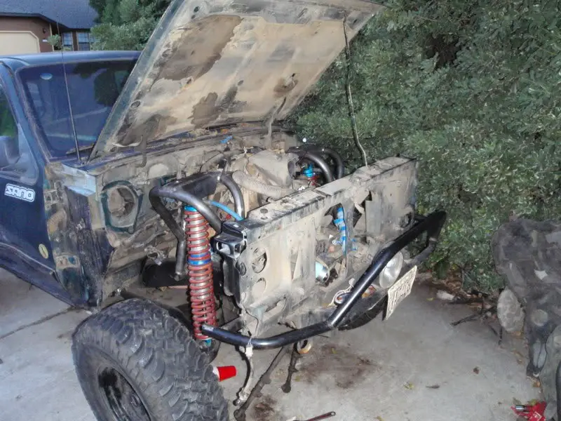

now that is air conditioning! A big ol hole in the firewall! Caution, AC from vents may include rocks!!!
LOL
trucks come a long way Josh looks real nice, nice fab work...
those shock towers look HUGE but will be nice once everything is tied in with more tubes.....

haha thanks man. They had to be pretty tall to fit the 12" shock and sneak by the dang master cylinder. I have a non-AC blower from the junkyard that I'm gonna throw there so I can keep my heater. I got the passenger side all gusseted and the bumpcan welded on. No fab over the weekend cuz I was at the Rubicon with some friends, and none next weekend cuz I'm moving to washington on friday:eek: I'll update as soon as I can;)

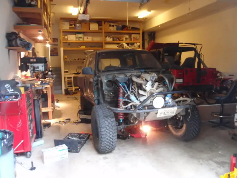

I guess the truck isn't really a driveway explorer anymore, it's in the new shop now!!!

I pulled my drivetrain yesterday, and as soon as we take the ferry across to Seattle(yes you drive your truck onto a ferry to go across the water) to Harbor Freight and get a engine hoist, the old clapped out 4.0 is getting shitcanned to make room for a carbed 350.
I got the passenger bump in today. I haven't started working yet so i can't buy a welder and bender, but as soon as July hits the shit is gonna hit the fan, in a good way!!:D
