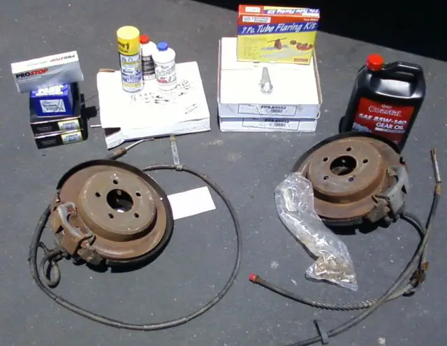

...Bought the cross drilled and slotted rotors for the rear to match the current front ones from them today...Just about got all the parts I need and hopefully will have a full rear disc conversion done before the 4th of July celebration..:hammer:
We need a picture of the rotors...
And, I assume you are going to use rebuilt calipers as opposed to the ones in the picture, right?
..There similar to the ones on the front shown here..
..As for the calipers, I just figured I would beat on them with a BFH..:hammer:..That should get most of the east coast rust off of them and they would be good to go..:D
