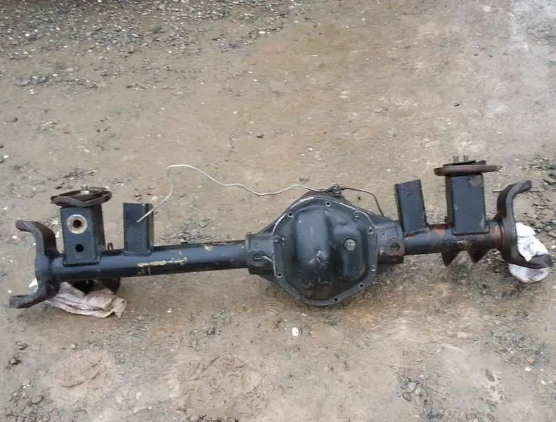

First thing I need to do is figure out the outers since it didn't come with them. Hopefully the shafts it came with are correct and splines have not been re-worked.
..Since it is empty, I have yet to open it up to see if the bearing caps and bolts are in it. It is missing a number of cover bolts and I definitely need to find a good cover as it's going to take some abuse..
..Next I'm going to cut off the 6" lift post someone installed and that will be a feat in itself.
...Goal is to not do leafs and go coil overs. I'm not sure if the ARB from my Dana 35 can be moved over to save cost and I will may move up to 5:13 gears.
