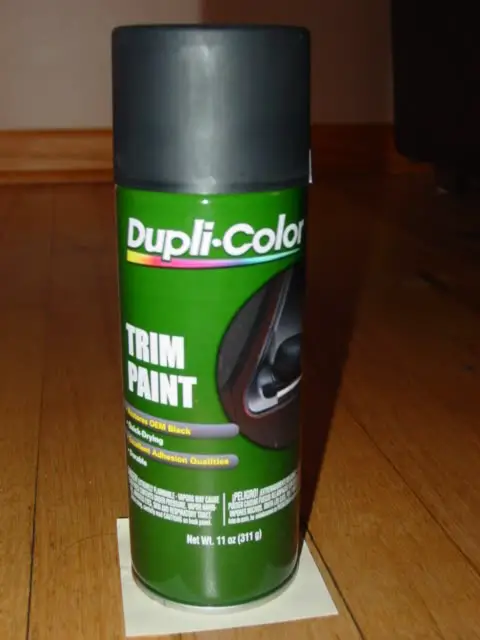

So, with my heart set on mesh, I set out for a method to make my own and spice up the look of the front end a bit. I did a little probing around my house and came up with some simple items that would complete the task.
The materials I came up with were:
- Poultry Netting (Aka - Chicken Wire)
- Silver High Heat Paint
- Flat Black Paint
- Gorrila Glue (Not Shown)
- A couple of old Paint Thinner cans full of water (Not Shown)

After that, I began painting. I painted everything at once. Doing three coats of the flat black on the grill and headlamps, and two coats of the high heat silver on the wire mesh. Then I waited for all that to dry (I hate downtime).
