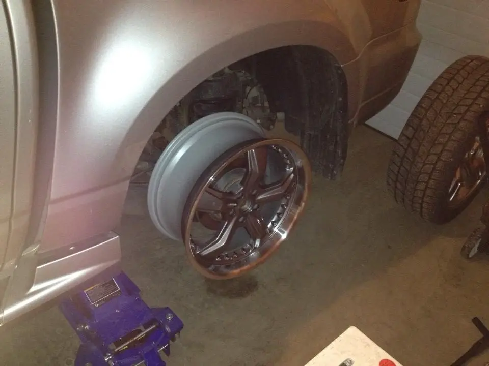

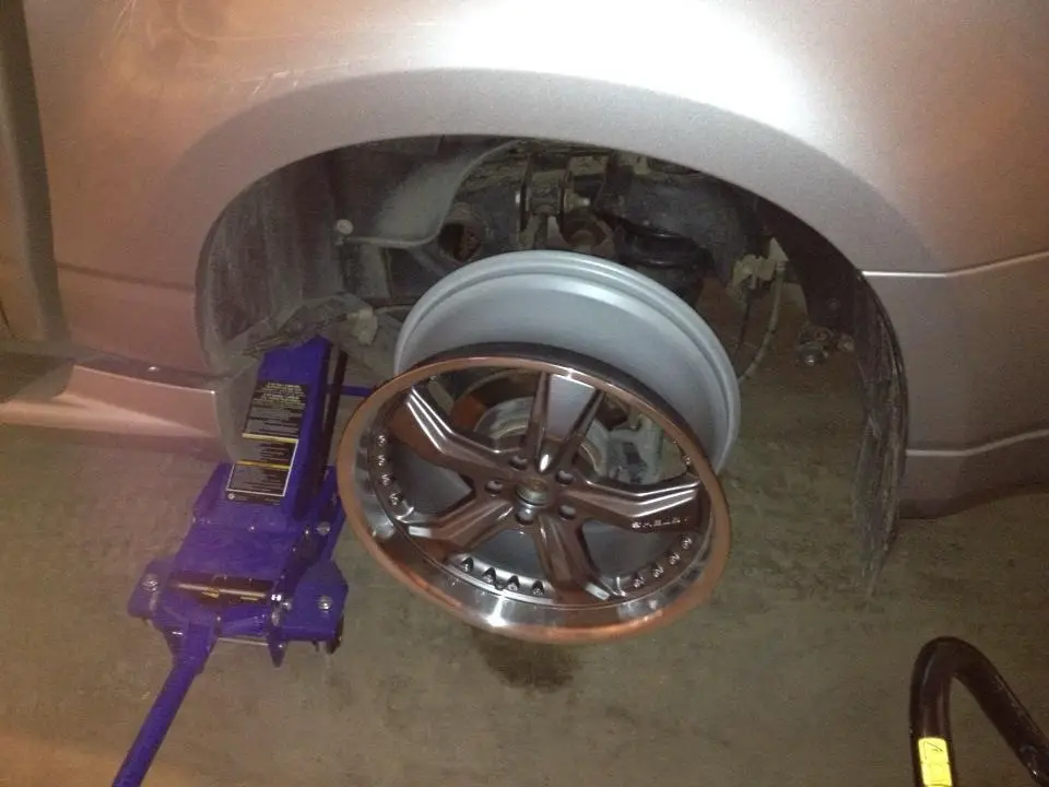

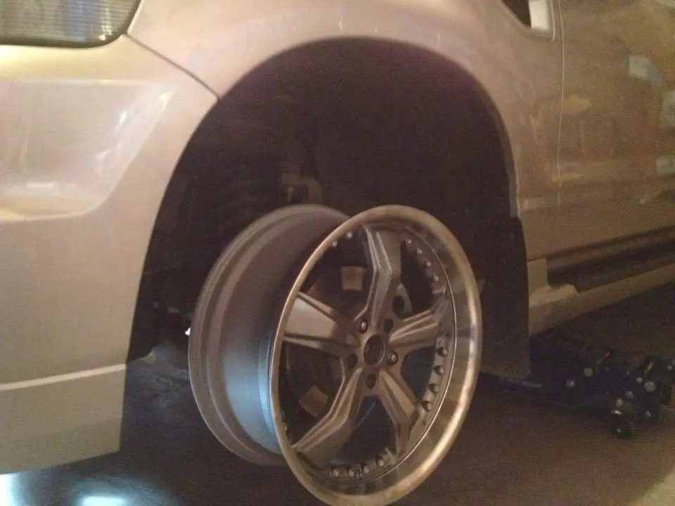

I just bought an '08 Adrenalin which currently has a set of Blizzak tires mounted on the factory rims. The vehicle came with the OEM summer tires but no rims for them.
Doing a bit of online research I've discovered that a past purchasing error might work out for this. A while back I bought a set of Shelby Razors with the intention of them being spares for my CS6 but in my haste didn't spot that they had a 30mm offset instead of the 24mm offset that is needed to clear the bigger brakes. I've since tracked down a correct set & the rims sit in the garage together waiting for a day they become useful.
The "incorrect" set I have are 20x9's with a 30mm offset & 6.2" back spacing which according to an online calculator should fit on the Adrenalin. My only remaining question is whether the stock tires 255/50/20's will fit the 9" wide rim when the factory rims are 8" wide. I think they may but might look a bit stretched. Any thoughts or experience with this rim/tire width issue?
