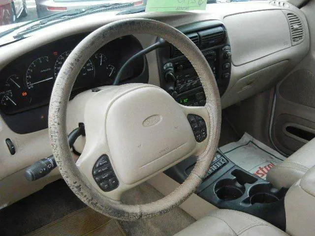

If you're looking for a solid ride, I'd seriously consider an XLT. Not a knock against the Limited's, but you won't have to deal with the air ride and some other stuff: The XLT's ride fine, and aside from the seats, (which I prefer the support of the XLT seats, actually, the Limited seats after 1994 are flat to me) the trucks are pretty much the same- The auto climate control is nice, but, eh, I like the manual controls, less to go wrong. :)
More stuff:
If you get the steering wheel controls for the audio and HVAC, if the wheel goes to crap, it's hard to find a replacement sometimes. The black leather wheel on the XLT is nice and fairly easy to find a replacement for at least in my experiences- there are a lot more of them around int he yards, and the Ranger used it also.

The message center is the other issue, and if you like to store things like a phone, etc., in the center console in easy view, you lose the cubbies if you have that.
