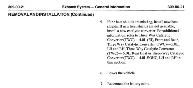

Local mechanic pulled off one of my heat shields and tossed it; said it was loose anyway/rattling. Said 'not to worry'.
Ford seems to have a different idea. I haven't been able yet to crawl under and see which one(s) are missing. There are generic pieces of heat shield(-ing) available at low cost from various sources; they could easily be banded in-place with clamps. My questions are: "What would would I be trying to protect with re-adding it/them?"
[Ford's suggesting to replace the TWCs is laughable!]

Stock shields are welded and that's how the engineer's preferred them. Clamped versions can move with heat/vibrations.
They say to replace the Cats, because the shields are welded to them. Being welded keeps them stationary (until they break off) and not hitting any surrounding parts.
My suggestion is to spot weld the replacement shields, or replace the cat's as suggested. You could always talk to the shop that removed it, and share your concerns about heat transfer.

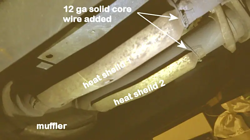

They changed the exhaust between '98 and '00 so this may not apply, but the heat shields that came loose on mine were welded directly to the bottom of the two pipes (in your case would be only one pipe) going into the muffler. I mean these pipes were part of the stock muffler. I just secured the loose ends where the welds broke, with bare (no insulation) 12 ga copper electrical wire about a decade(?) ago... still there.
I have a poor picture of them.

They changed the exhaust between '98 and '00 so this may not apply, but the heat shields that came loose on mine were welded directly to the two pipes (in your case would be only one pipe) going into the muffler. I mean these pipes were part of the stock muffler. I just secured the loose ends with 12 ga electrical wire about a decade(?) ago... still there.
I didn't see any of these (single intermediate pipe on my OHV/2000 XLS) shields so you're probably spot-on. Thanks.
