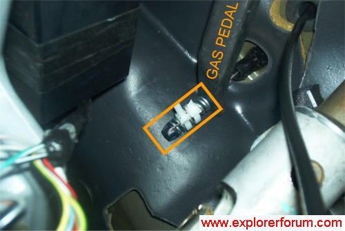

Some of you might know this already, but it's probably the #1 DIY mod on other Ford truck boards, but it isn't talked about much here. Stock, the gas pedal cable has about 3/4-1 inch of play in it. This means that you have to push down further on the pedal to get response from the motor. By eliminating that slack, you'll get better throttle response. This can be done by folding the excess cable over and zip-tying it to itself, like the pic below.
Very easy mod, and you can definately tell a difference. Lil tricky to get the zip ty on, but it's worth it.

Yikes! If you do it that way it looks temporary to me! I wouldnt want to run those zip ties around the spring!

It looks temporary, but I put the zip-ties on VERY tight. I did it in a way that the spring can still compress. If the cables come off one day, it'll just go back to the way it was before, in which case I'll use something stronger. But almost all over at the Ranger board have used zip-ties and have had success.

hey 410Fortune, does it matter where you put the zip ties? i put mine infront of the springs rather then behind. yes no?

As long as you remove the slack from the cable I dont think it matters where you take it from.
