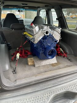

After a successful 5.0 swap two years ago I decided it's time to add some real punch to my Sport! Had a fresh motor built with new rods and pistons, AFR heads, a Comp Cam, 24# injectors, and an extrude honed upper and lower intake manifold. Dropping it all of with the mechanic today, should be able to get it tuned next week. Wish me luck!
