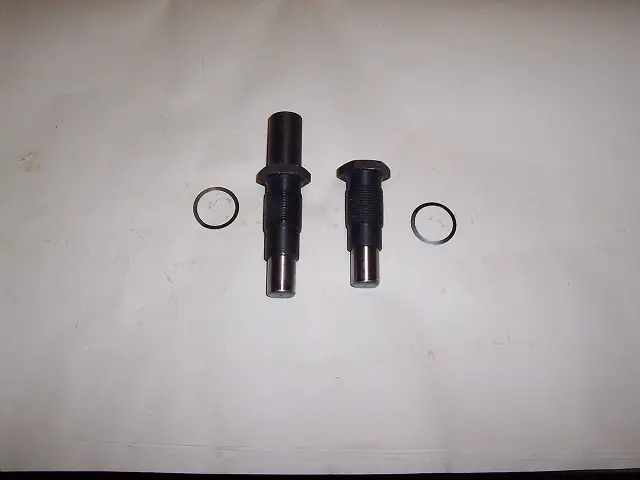

improved tensioners
The improved tensioners are shown below.
The longer one is for the front/left side and the shorter one is for the rear/right side. I'm not aware of any later changes. I advise against reusing the compression ring since that will probably result in an oil leak. A replacement compression ring part number: XU2Z6M252AA
The compression ring will drop out of position and leak if not kept in place when tightening the tensioner. I used wheel bearing grease to keep it in place. It is very easy to cross thread the tensioner because of the spring pressure. I advise starting with just hand pressure for the first couple of turns.

My original tensioners are different to the ones pictured.
What I mean by the step down is the end 1/4 inch of the tensioner piston is a smaller diameter than the rest of the piston.
This is not an actual tensioner but it is the same shape as the tensioners that came out of my Explorer
