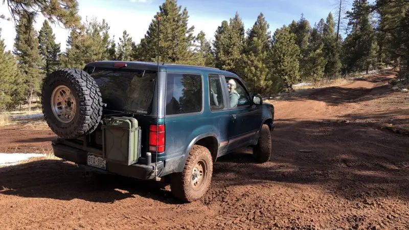

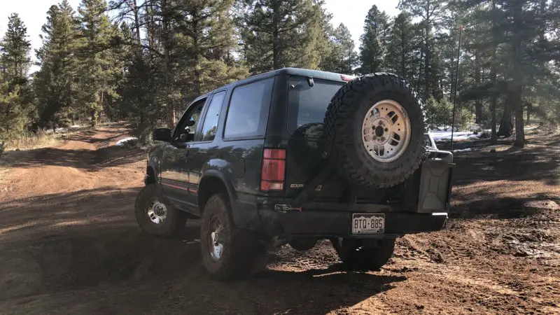

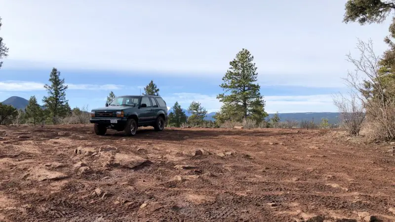

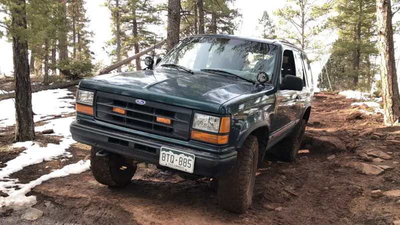

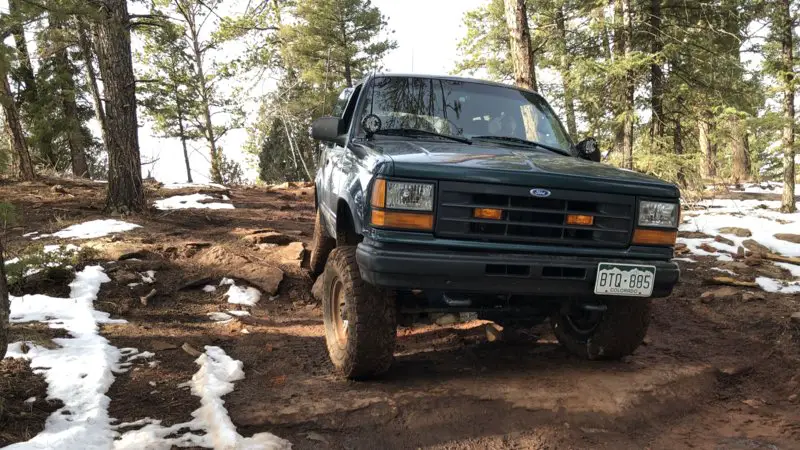

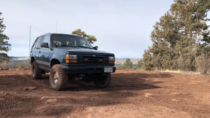

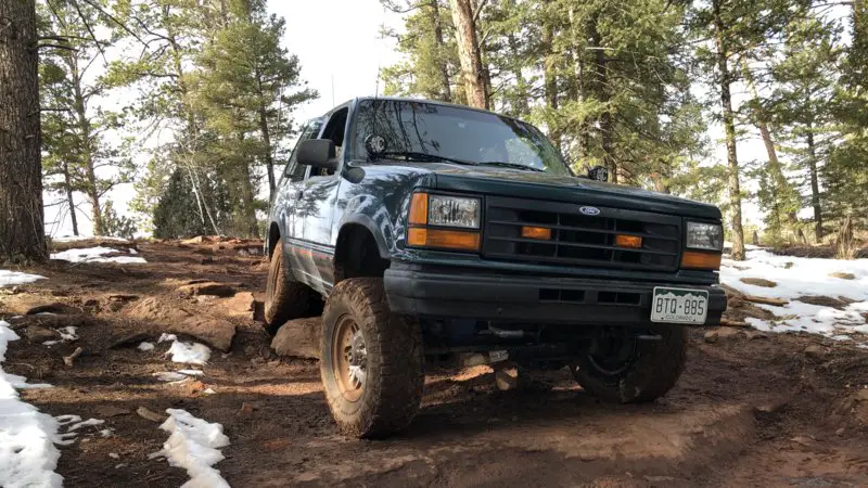

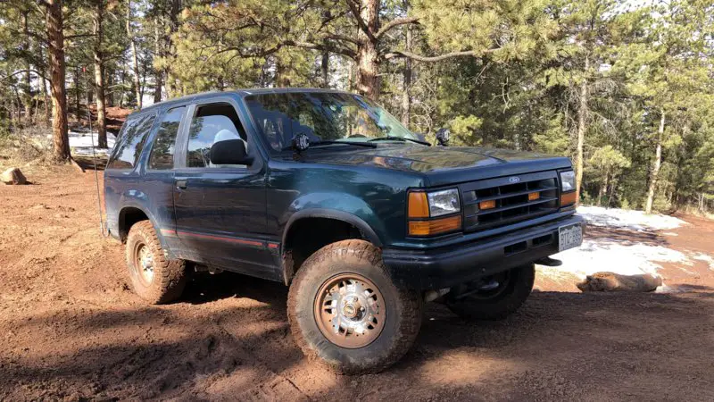

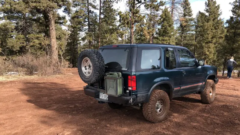

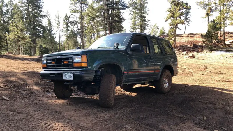

Went out and did some wheeling today at Rainbow Falls/Little Moab near Woodland Park! I hadn't been since June, but it sure feels good to be back out. This was also the first time wheeling with the 5 speed! I'm very happy with the swap still, and even more happy with the control I have off-road. Only stalled it once on a pretty good size rock. I'm undecided on a hand throttle. After today I don't feel like I really need one, but it would be nice to have just in case. I guess we'll just have to take it out wheeling some more to find out:thumbsup: The 5 speed also helped immensely going over Ute Pass into Woodland Park. It was still slow going at 35-40 over the pass. But unlike before, the engine temp never got over 190*. Granted the air was cool this morning. But even still, with the auto the engine used to run in the 200* range on a cool day and even hotter at 205-210* on a hot day with the heat blasting. So I'd have to say that the running hot condition I was seeing was definitely caused by the auto. As far as the slow going, that's probably just caused by a tired 187,000 mile motor. It's my plan to replace the motor in a couple years here, as well as some axle gearing.
I also let my wife drive for her first time off road on part of the Little Moab obstacle. She did pretty good for her first time driving! She was a bit nervous, but managed to get through a pretty rough line on Little Moab. I think she'll get more used to it the more she wheels. We just bought her a Wrangler (I know, don't kick me off of here:laugh:) that she wants to build and take out eventually. She'll need to get used to the Explorer first before we do that!
I've probably mentioned in this thread somewhere about wanting to go to the 5.5" option on my James Duff kit. And I seem to get ideas like that or SAS swap ideas when I haven't wheeled the Explorer for a while. Then I get it out and it's just so good the way it is. It's incredibly comfortable and drivable on the road. And it works so well off-road. It flexes great and it's just so stable being so low. Would it be nice to have a bit more lift and 33s or 35s? Sure it would. But I just don't think this Explorer needs it. I've gone plenty of places that I probably shouldn't have with the way this Explorer is already. And I really don't want to ruin the drivability of it. I would really like to have a full blown trail rig/beater. This Explorer won't ever be that though. It's just too nice and so good the way it is. People used to take old Willy's Jeeps out with small tires and open diffs. And they would go just about anywhere. I've always liked that way of wheeling. When it comes down to it, it's about the ability of the driver off-road and the driver's knowledge of the vehicle. All the big tires and one ton axles aren't necessarily needed unless you're doing some extreme crawling. So I guess what I'm saying is I don't really want to change the Explorer a whole lot from the way it is. I want it to kinda be a "sleeper" if you will. Small lift and "small" tires, but still with gears, lockers, and all the other off-road goodies. I think I'll be able to go just about anywhere I want to that way. Then I can get another Explorer for a full blown rock crawler:D
I know, blah blah blah blah blah.... Here's pictures for y'all to look at!

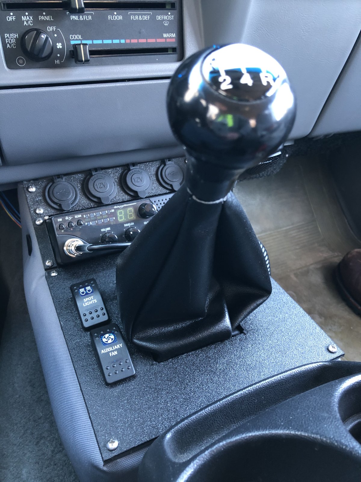

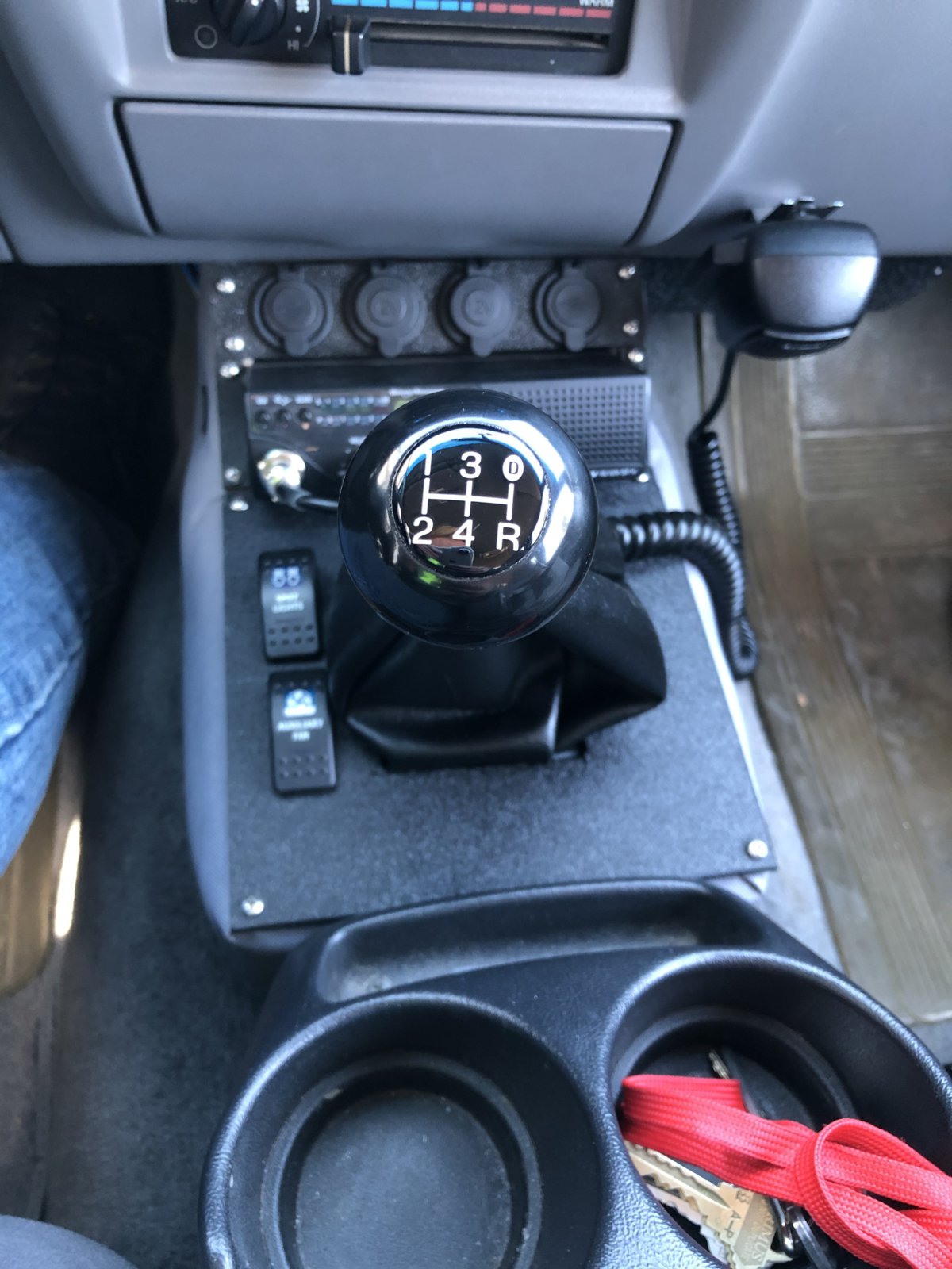

So the last few things from the 5 speed swap...
Just a couple more pictures of the shift boot because it’s that awesome! I stuck it on just to break it in before adding a trim ring/keeper for it. Well the boot doesn’t need anything to hold it in place! So I’m not going to worry about a trim ring for now.

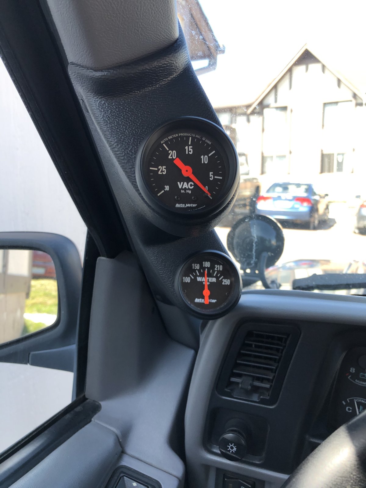

And the finished a-pillar gauge pod. As @gmanpaint had suggested, I got a vacuum gauge for the second hole. It’s not functional right now though. I put it all together and the vacuum line wouldn’t stay in the back of it even though I followed Autometer’s instructions. Think I need a different ferrule... or if anybody has other suggestions?? But hey at least it fills a hole and lights up!
