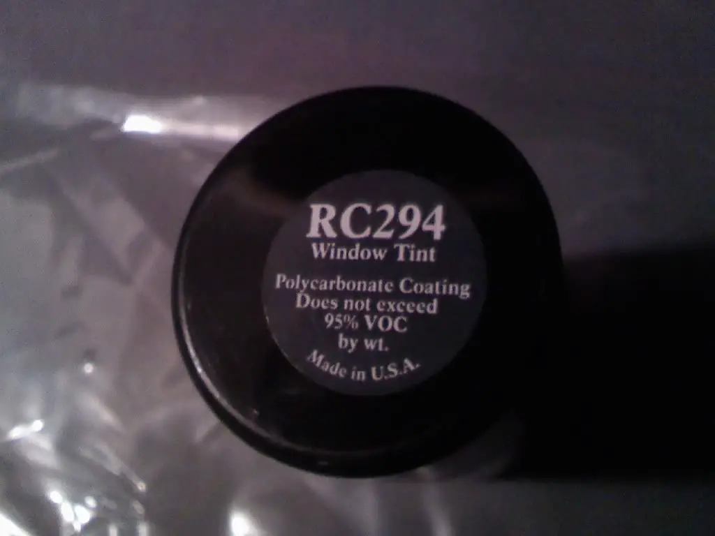

first i bought this stuff from a local hobby shop, its made for rc car painting, but works perfect for this, trust me, i think its better than vht night shades.

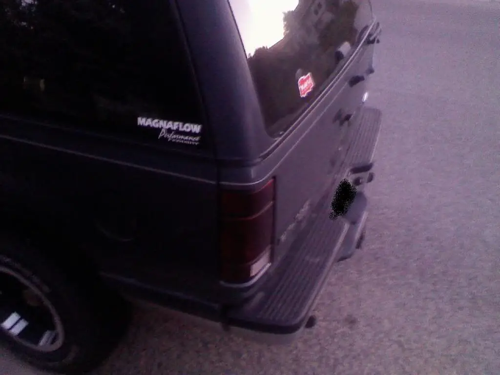

here is what it came out to be, this is essentially 3 coats, and its pretty dark, but 4 or 5 would have been ok, i think enough of light would still get through.
before:
after:

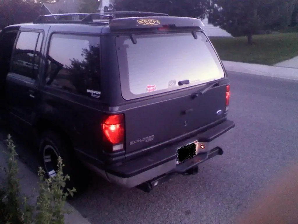

this is with the running lights on only, not even brake lights, so as you can see it shines through well.
