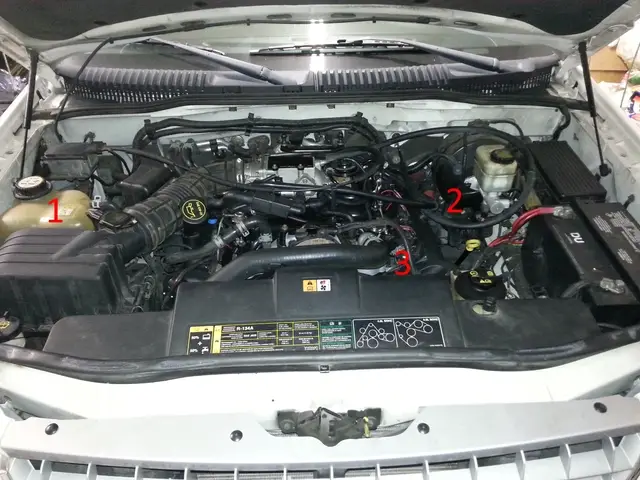

Since I was already working on the intake manifold I had previously drained the radiator which yields about 2.25 gallons of coolant. Because I had most of the coolant removed I decided to remove the water pump to get it out of the way and provide more room to work. Be warned though, you should expect about 1 quart of coolant to come out if the water pump is removed at this time given that the radiator was already drained. This is the perfect time to change out your water pump anyway. If you have high miles and have never changed the water pump it's so easy to do at this point and a water pump only costs $40. In addition, I had the alternator off which gives you even more room to work. Both the water pump and the alternator are VERY easy to remove and it really helps to have them out of the way. You'll note in the video he has difficultly clearing the water pump with protrudes outward.
The power steering pump is not all that hard to remove. You need to remove the driver side front wheel to have easy access to the power steering bolts. After that, it's easy to remove the two bolts from the wheel well. With regard to the front p/s pump bolt you can make life really easy by simply removing the p/s pump pulley. I rented a free loaner p/s/ pump pulley removal installer tool from O'Reillys. Once the pulley is off it is SO EASY to get that bolt out. The actual process of removing the pulley then reinstalling it is very easy with the tool. You'll thank me later that I gave you this tip.
Eventually you'll need to remove the valve covers. To make the job easier you should: 1. remove the three bolts holding the coolant reservoir to allow moving it slightly so you can get to one of the harder bolts on the right side valve cover, 2. Remove the EVAP canister vent value by simply pushing the metal retaining tab on it and pulling it off...in the video he unnecessarily removes a 13mm bolt but no bolt removal is needed, 3. The power steering bracket should have already been removed.

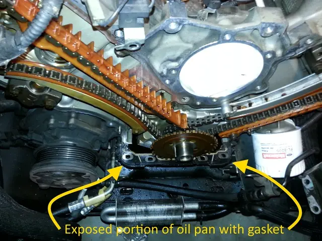

Eventually you'll get to this point where you will note the front portion of the oil pan is exposed and this is why you would want to remove the water pump before the timing chain cover if your desire is to remove the water pump.

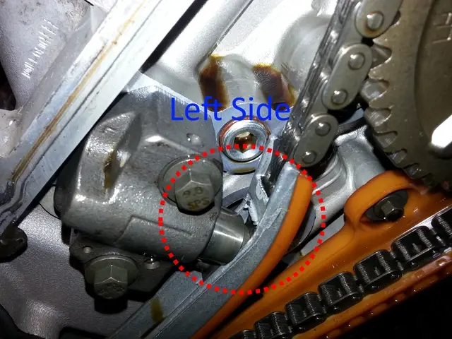

Before servicing the timing chains you'll want to take a close look and determine if there is anything catastrophic within the area and could include finding pieces of plastic or metal from the tensioner arms or guide arms. My first verification that I was long overdue timing chain service was this:
Note that the chain had worn right through the tensioner's plastic rail and the chain was riding right on top of the tensioner piston.
The right side was just as bad:
At this point it's clear that the tensioner arms, tensioners and guide rails need to be replaced on both the right and left side. But, do the timing chains and sprockets need to be replaced? Well, in my case it was not clear because I did not have any feedback from others on the topic and had already ordered a full chain/sprocket/tensioner kit for $75. Hindsight is that my factory sprockets and chains did not need to be replaced even though the chains were riding on top of the tensioner pistons. I only know this because I removed the chains and sprockets and inspected them for damage and stretching. I found no stretching or damage to the chains and the sprockets were in excellent condition. In the end I replaced the chains since I had them already but reused my factory sprockets. If I knew the chains and sprockets would be in excellent condition then I would have left them in place and replaced only the tensioners, tensioner arms and guide rails. I mention this because if your engine is similar to mine with no wear or damage to the chains and sprockets then why subject yourself to the process required to remove the chains?
I would recommend leaving the chains and sprockets alone and only changing the tensioner arms, tensioners and guide rails. You will not need a cam holding tool if you leave the chains and sprockets alone. However, be prepared to zip tie in several places the chains to the sprockets so they don't jump off otherwise you will have to go through an extra step of making sure the timing in put back in place. Anyhow, the call is yours to make on if you want to replace chains and sprockets...I say, don't bother.

I never suggest reusing gaskets anywhere unless you have to such as the oil pan gasket which is partially exposed when the timing cover is removed. Make sure you thoroughly clean the oil pan gasket with throttle body cleaner and remove any RTV in the corners where the bottom of the timing cover meets the engine block and the oil pan.

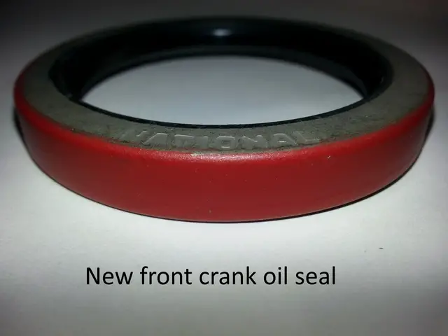

I purchased new Felpro valve gaskets which come with new rubber grommets. I also purchased a new Felpro valve cover gasket set which comes with a new front oil seal. Regarding the front crankshaft oil seal...even though mine was not leaking and since I had a new one in my gasket kit I decided to go ahead and change it out. It was very difficult to remove the old seal which was done while the timing cover was still off. After using a large punch and whacking the outer edge of the seal many times then using vice grips I was able to get it out. I installed the new seal after the timing cover was bolted back on. The reason I did this was I thought it would be easier to do using the p/s installer kit I had rented for free at O'Reillys. The idea is the same as the one below where a "special tool" is used. I thought it would be easier to drive it on using the installer kit but it was not easy at all because the seal would tend to go in ****ed slightly on one side or another. In the end I got it installed but I dented the outer rim of the seal and can only hope that doesn't create a oil leak problem. So far, so good. If I had to do it all over I would probably try to install the new seal while the timing cover was outside the vehicle and use a mallet with a block of wood.

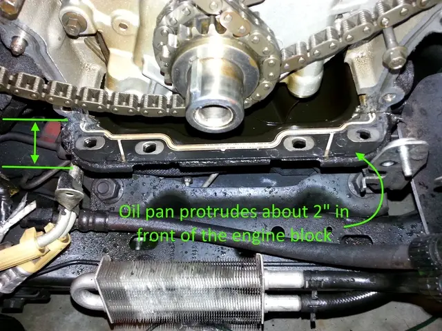

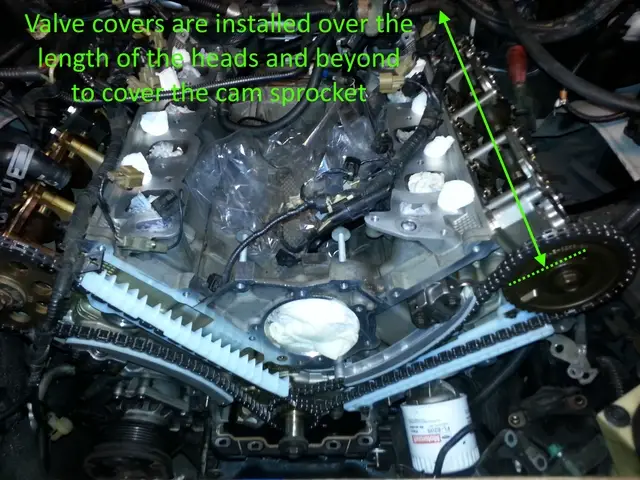

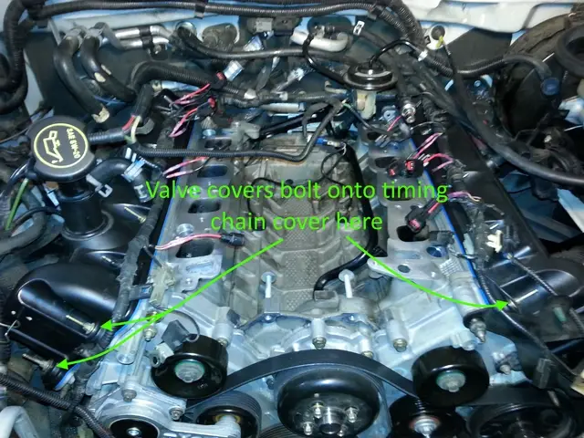

Great write-up. Question- if doing only guides and tensioners, but no chains and sprockets, do you have to remove the valve covers?
Yes because the valve covers bolt onto the timing chain cover and you would not be able to properly reseal everything by trying to slide the timing chain cover between the valve covers on the top and the oil pan on the bottom...if fact, if may be impossible.
I thought there might be a way to streamline the procedure a little if not doing chains/sprockets by just removing the bolts holding the valve cover to the timing cover. I've never been in this part of the motor, so I'm sure you're right, thanks.
Here is a better visual on the relationship of the valve covers to the timing cover and timing cover to oil pan.
Thanks SyberTiger, that helps. I'll probably try leaving the chain/sprockets alone if they look okay. Not sure how much time this saves, but I won't know until I can get in to it -probably not until the weekend. Thanks again, great pictures!

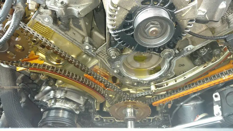

Well it looks like it was from the chain rubbing against it. The guide was completely destroyed. Take a look at the photos below. I'll throw some new tensioners and guide rails and have the cover welded up. Other than the aluminum shavings now floating around the engine, I should be ok.

Kind of weird because it seems like your tensioner rails are still in place and doing their job. Did the tensioner pistons poke through like in my pics? There must have been enough slope in the chain for it to slap against the cover. I guess this shows again that the 4.6L is near indestructible. I would assume that bit of oil was coming out of the hole?

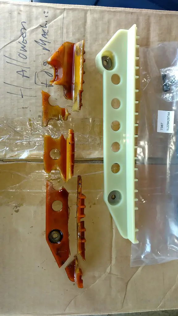

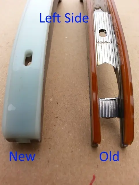

Ok, so here is the comparison of old verse new parts. One thing to watch out for when removing the right side is the cam is wanting to push counter clockwise on you once you remove the old parts. I was not ready for this and now have to figure out how to get the chain back on the correct tooth. The chain does not have marks so I guess I'm stuck buying a new chain set. Ugh.
