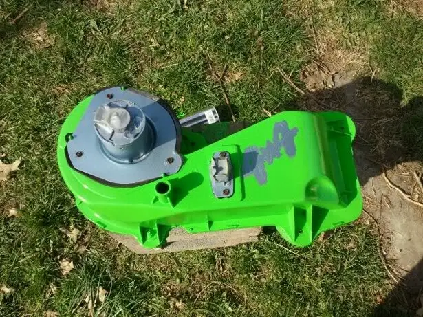

right you need a non a/c heater box
looks like this.. not green... normally nasty greasy black
i did my hearter box
hey all a 94 ranger will fit a 90 bronco 2 no problem at all
im removing the ac on my 97 sport was wondering if the 82 ranger non ac box would still work or if i would have to look for a different one
Any non ac will work
alright it just looked like the one at the begining of the post matched rate up. i dont mind doing a mock up (actually prefer mocks, makes them there own) but looked nice how that one fitted
They should all be the same.the green one was modified for a v8 swap, its not stock
