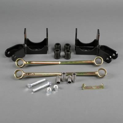

After further review, I can't possibly use my longer shocks. :( There is no way to mount the tabs low enough to use extended length shocks without sacrificing ground clearance.
I guess stock length shocks work OK and don't limit travel?

I saw those in pictures, they are pretty slick because they allow the shocks to mount and the bolt on. The bolt on is a double edged sword: Its nice that I can remove them, but would I risk them coming loose on me?
What if I got those and some big ole u bolts and 3/8" thick plates to make it more secure?
And, the "footprint" of the adapter is small, that could contribute to spring wrap.
:dunno:
Could I use those and my longer shocks???
If I could, it would be beneficial cost wise to buy the Superlift kit, u bolts and spring plates.

Call Superlift. Tell them about your front kit and that your springs are sagging so you want to go SOA to match the front. Ask them which shocks they recommend with their kit.
I have the Superlift bolt ons and beat the crap out of mine. They won't come loose any more than they would without the kit.
You could bolt the shocks to the sway bar wholes.
That's good to hear- sounds like what I am going to do. I don't have a welder at my shop, no power to run one. :(

From what I can tell, the Superlift brackets want to reuse the stock shocks. I may just try to find some cheapies.

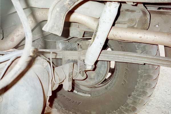

I also have a 33" spare under the truck.. Its a '92 4 door with 33x12.50 BFG At's on 8" rims. I keep 10psi of air in the tire to make it fit. I have found that if I compress the rear suspension far enough that the tire does rub on the diff cover.

I wonder how much of an angle shocks can be used at and they still be effective?
