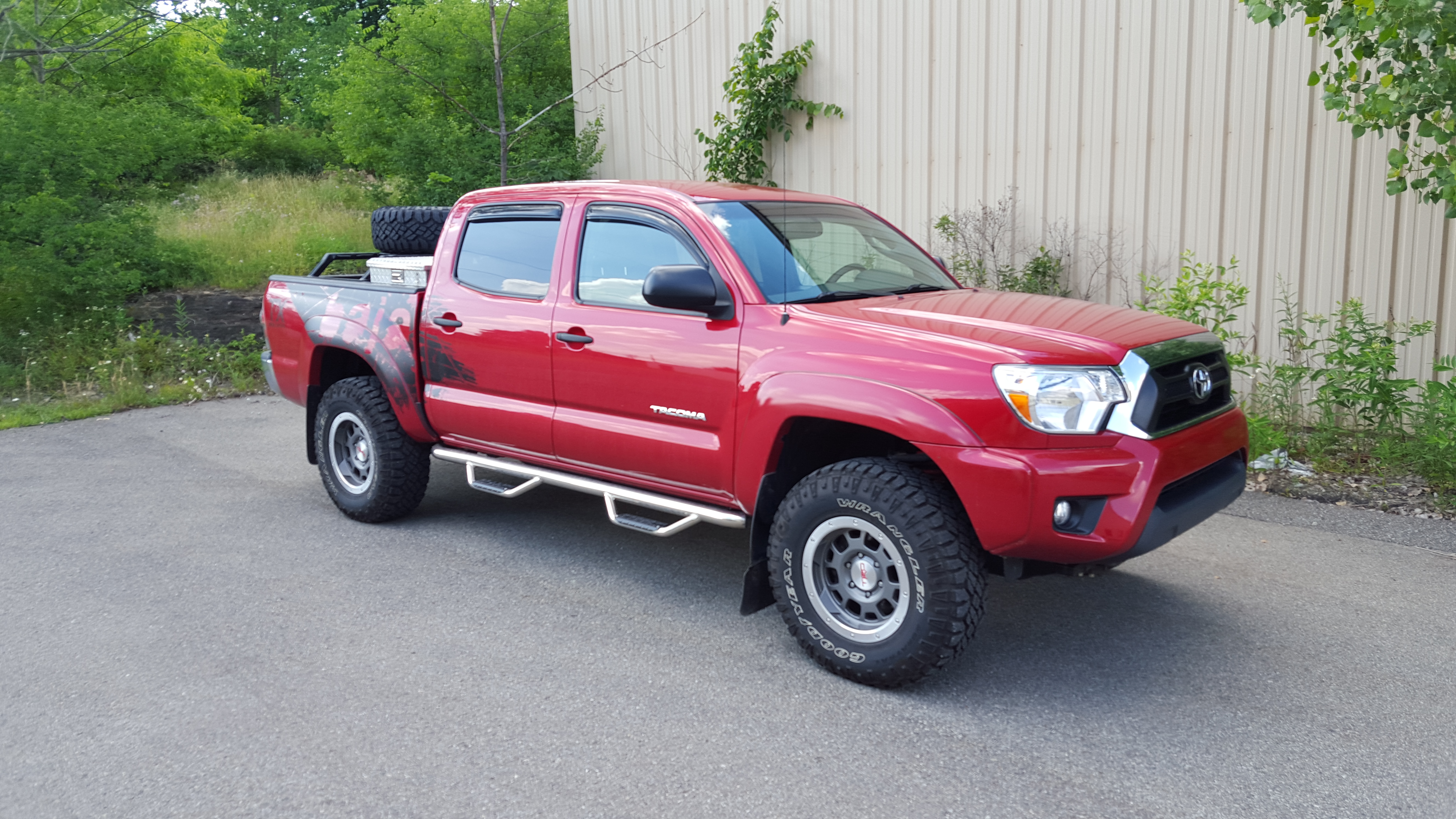

I have 265 75 16 Duratrac's on my 2013 Tacoma BAJA and they work great, you'll want to make sure you get the Load Range C tires and not D or E. Discount Tire Direct always has awesome deals on them, I bought mine for $172 each plus got a $100 rebate.
