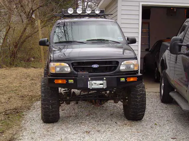

Here is a TJM for a 94 ranger on my 97 sploder with a warn M8000.

Looks great Dave! I think I see my 7/16 socket in those rocks.
Fits great. Side wing things are too long cause my fenders are trimmed so this weekend I will trim them to match. The contour of the body line is perfect, the 94 ranger bumper mounted to the outside of the fram rails so I cut the ends off the frame and could have then sleeved and bolted them through my frame easily, but I chose to take the even easier rout and weld them to the frame. The bumper is still removable cause it bolts to the brackets. It only took me a couple hours last night to align it weld it bolt it and wire up the winch.
I got it off the TJM USA web site blem sale. saved a bit over $100 and all it has is a nick in the powdercoat on a corner and not even all the way down to the bare metal. Heck I'll tear it up worse than that in no time.

Its steal. Functionality is what I go for. Don't need a shiny aluminum one.
As for the first gen, this one would look funny cause it is curved for my front clip but I believe they make one for a first gen sploder already. If not an early 90s ranger one would work.

Only its the steel black one. You may find (hard for me to say since my wheel wells have been trimmed) that the side pieces are too long. You could just trim them down or if you watch too much monster garage you could do like I did yesterday and cut 4" out of the center and weld them back up so that you have the original look... I'll get some pics of the sides when I get them back from the poweder coat shop.
