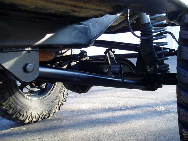

Here's something I found on eBay... an XJ for sale sitting on full width Dana44 up front and 9" rear... kind of interesting set-up:
that is the route I would go if I went SAS...... Save time and $$$$ and get right to the long travel with no messing around :)
That looks nice. Looks like the way to go even if I wanted to use D30 that I've got. Rubicon Express you say?

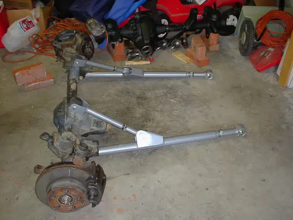

I already have the RE braket kit, and I'll make my own long arms, so total cost up front should be in the $800 range for me total.
Dre said:
Jefe - which set-up did you get from Rubicon Express? and is that a full width D44 on your truck? Interesting.
I just bought the front arms (lower and upper) and track bar from them and made all the frame brackets myself. The D44 is custom built to TJ spec. If you read my SAS thread, you'll see that I mocked everything up using a TJ D30.
