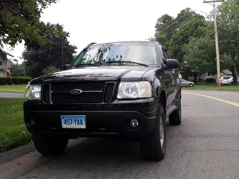

did you guys clear the cladding after painting?
I used fuzion plastic paint. It came out great , but it seems to scratch very easily. I was wondering what people are doing to keep it from scratching
here is my progress so far. I still have to do the front bumper.
any help?

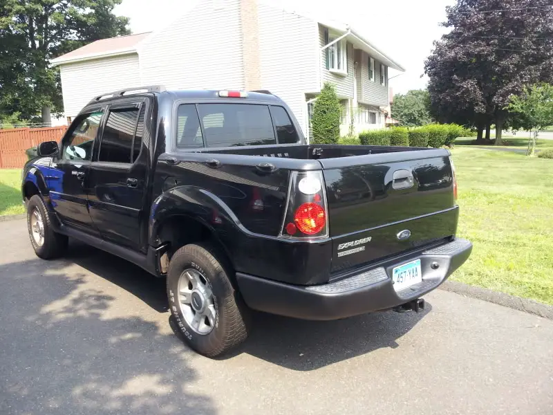

So I tried out the duplicolor bumper paint on the front. I think this might hold up a little better. But for now I will keep it as is to see how everything holds up. I also installed some euro tails which i plan on tinting soon. So here is the truck as it stands now.
That looks SOOO much better. Why Ford didn't do that I have no idea.
