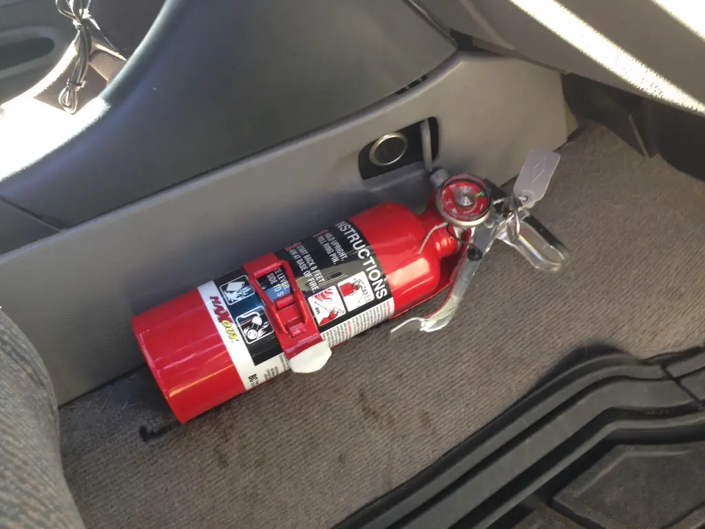

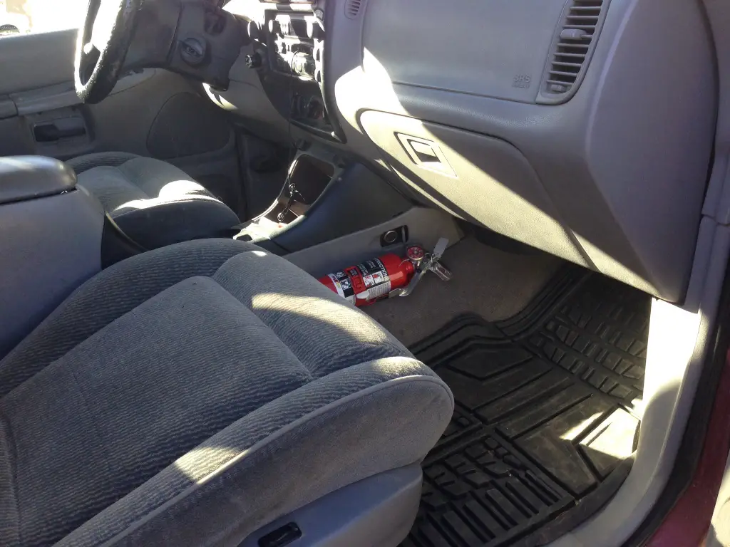

Looks good, I placed mine in the same place and have a back up under the rear seat.

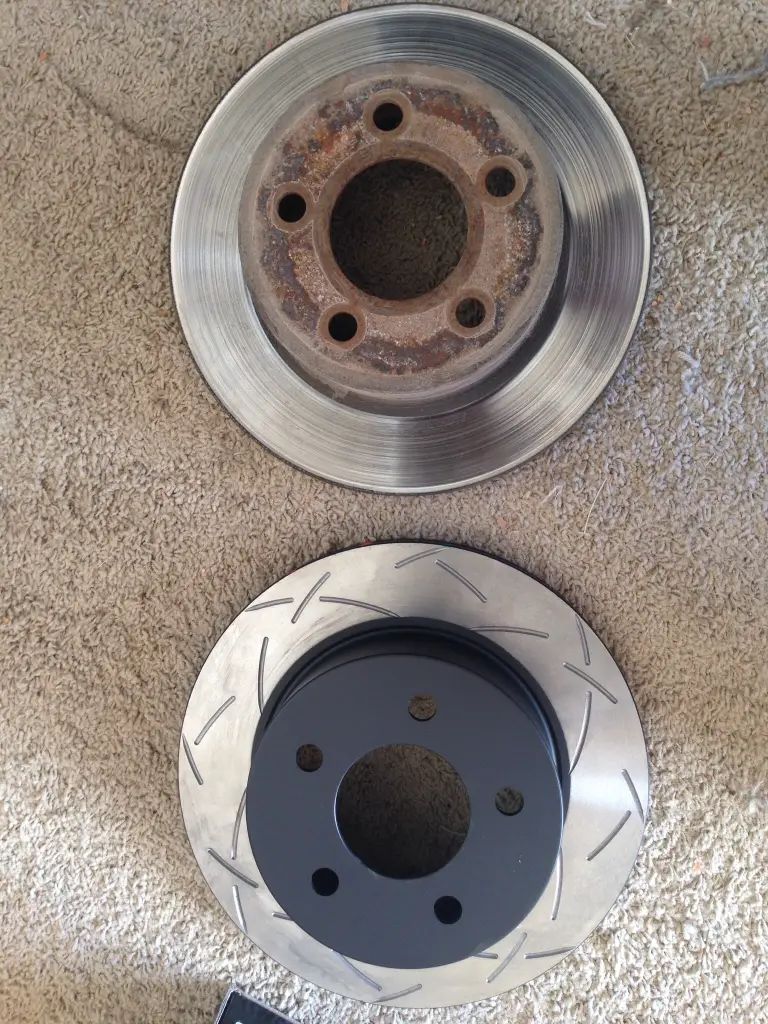

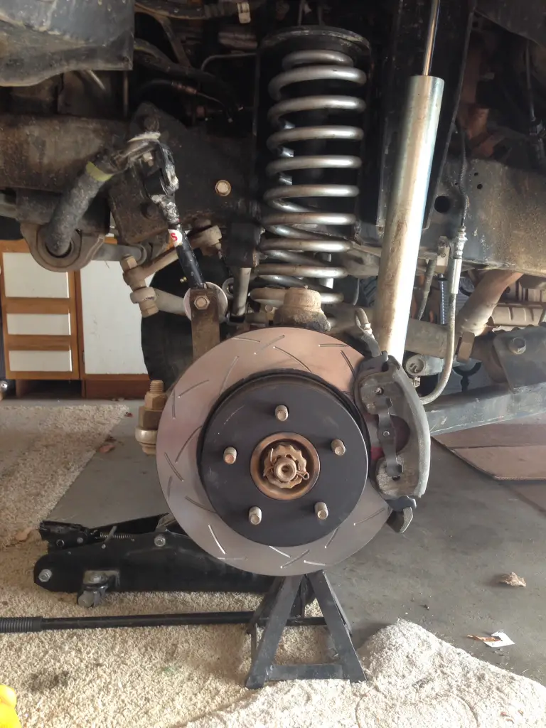

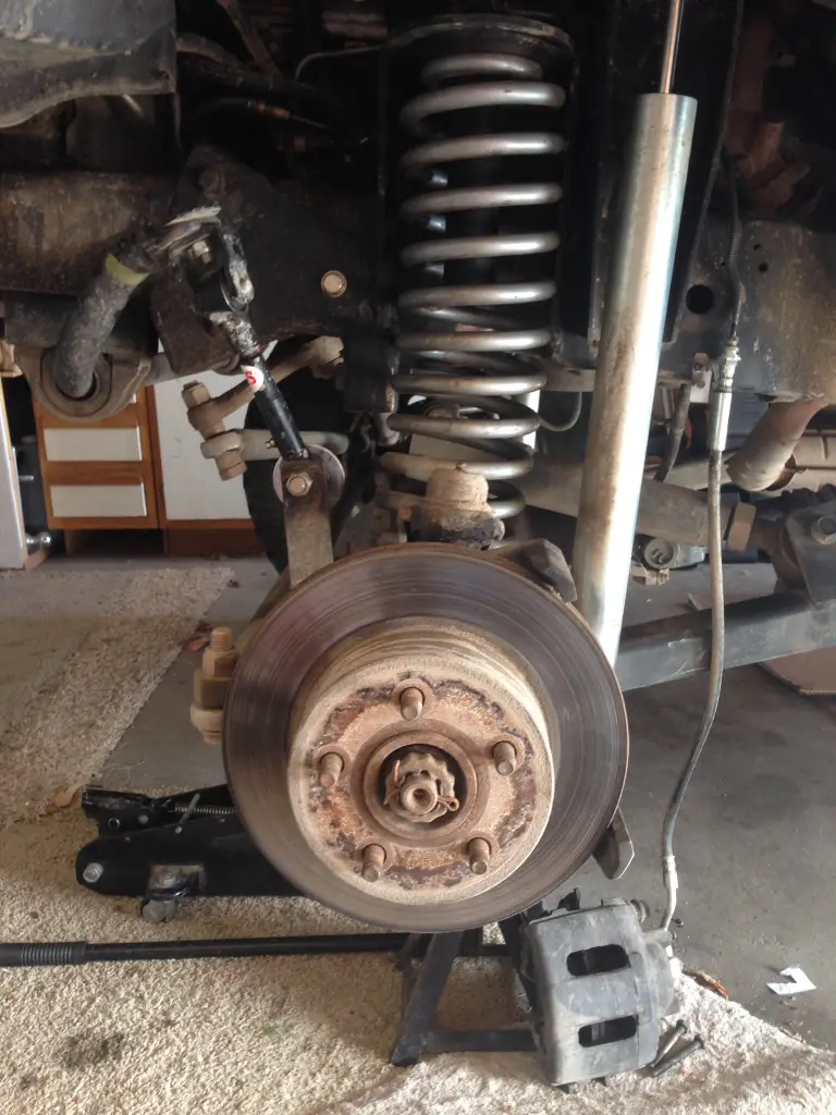

Replaced the rotors and pads that came from the junkyard on the D30. I went with some DBA rotors (4096s) and Hawk LTS pads (HB210 Y.677).
The old:
Side-by-side:

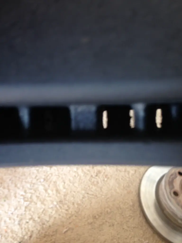

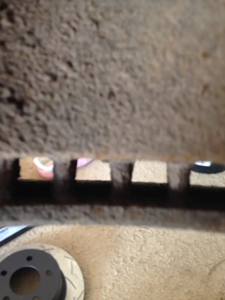

Here you can see the difference in the cooling vanes density.
DBA:
Junkyard:
All done:

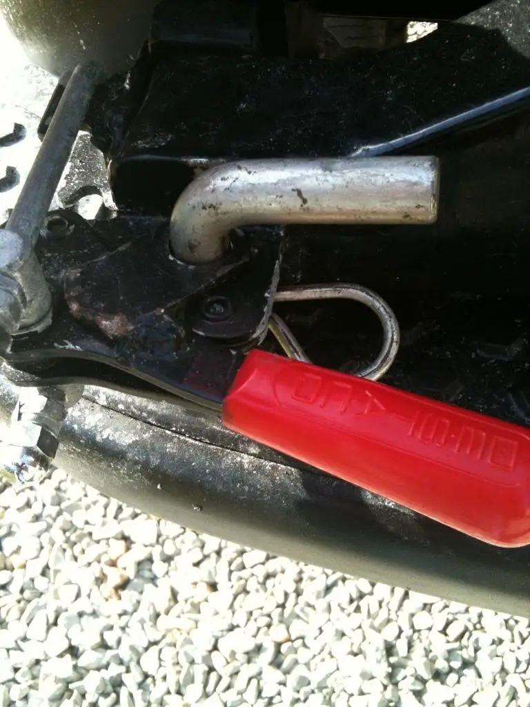

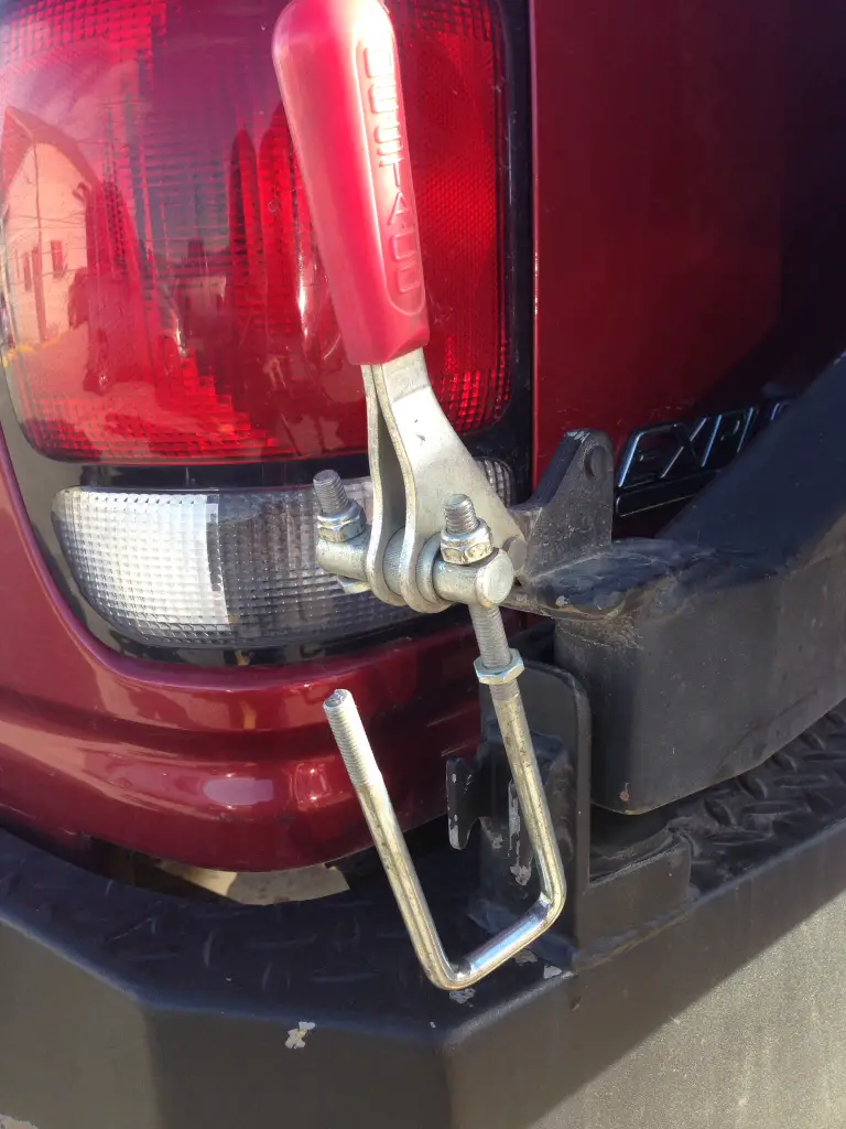

That sucks. It snapped because the ubolt was 1. Off-centered in the swivel pin to the latch and 2. Doesn't have a secondary pin/locking latch to keep the pressure off of the ubolt. I'll upload pictures (shortly, on my phone now) of my setup and it has held up for years of abuse. I bought my kit from EMS offroad.
Ok, so here's how I built mine and added a secondary lock pin (started with a cable lock but changed to pin) as well as a gusset bracket for the isolator pad where it latches to keep the vibrations down.
Here's a link to my PB bucket, from page 6 and up there's tons of pictures of the carrier, brackets and latching mech. to check out. I noticed that you had the nuts on both sides of the u-bolt holding it tightly onto the pivot pin, you can see I just doubled them up on the backside of the pin so that it can move as needed with the vibrations. I think that this is the main culprit as to why it snapped along with the pivot pin not being centered when it was last latched.
http://s1201.photobucket.com/user/MidnightRebel07/library/?sort=3&page=5
I just noticed that you don't have much of an isolator pad left there, when you close and latch it do you latch it down really tightly with the latch to keep pressure? This could be another reason why it snapped the u-bolt, too much tension on just that.

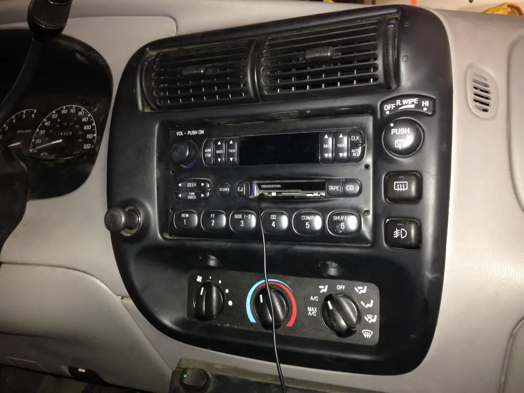

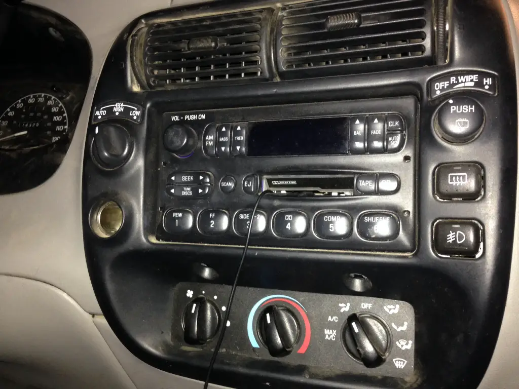

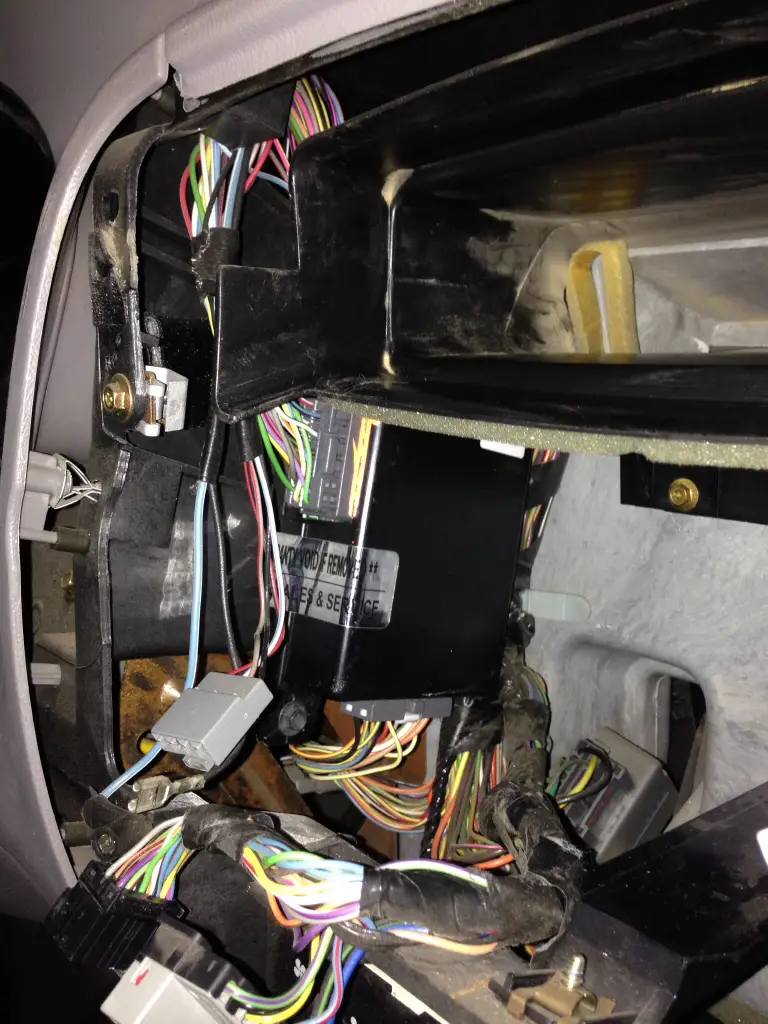

But the nagging 4wd lights that have been blinking ever since I went to the manual transfer case finally got to me. I bought a GEM module back when I had the lift put on but just never opened the dash to change it out. And after getting a lecture at the emissions place from a guy saying I needed to make sure I lined up for the AWD rollers as he pointed at the 4wd switch on the dash with the "auto" position, it was just time to fix it. I picked up a "new" center dash bezel at Littleton U-Pull and swapped it out:
The old bezel:
The "new" GEM module:
The "new" bezel:

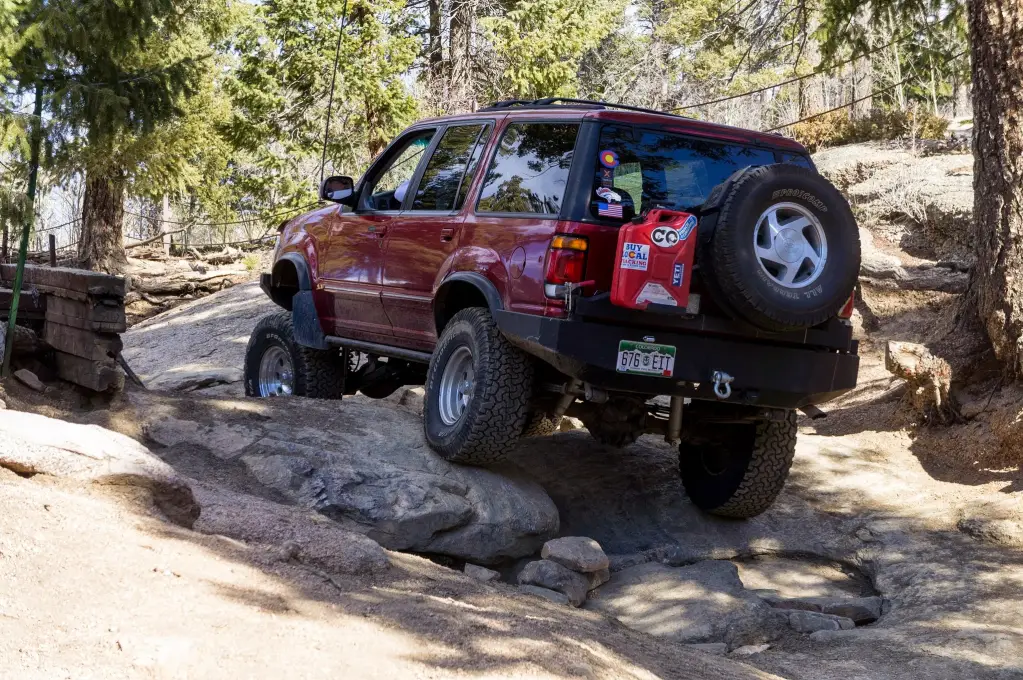

Nothing like February in the mountains:
Then I got the diff hopelessly hung up on a rock. Forward didn't work, reverse didn't work, stacking rocks didn't work..... Out came the brand new MaxTrax:
I slid sideways into this position:
This is trying to get the MT in position to go forward:
The front MT ended up getting pulled under which probably helped when we put the rear MT behind the driver rear tire. It pulled itself right out.
This rock felt much steeper than the pic indicates:
