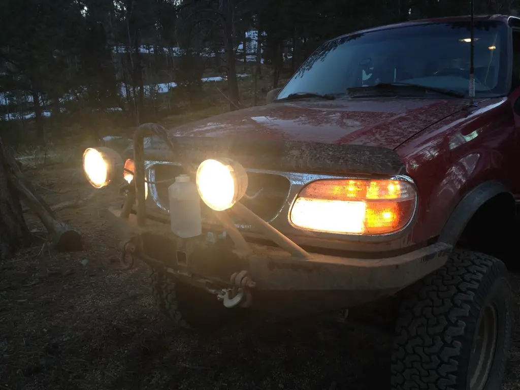

Had to stop and clean the mud off my lights:

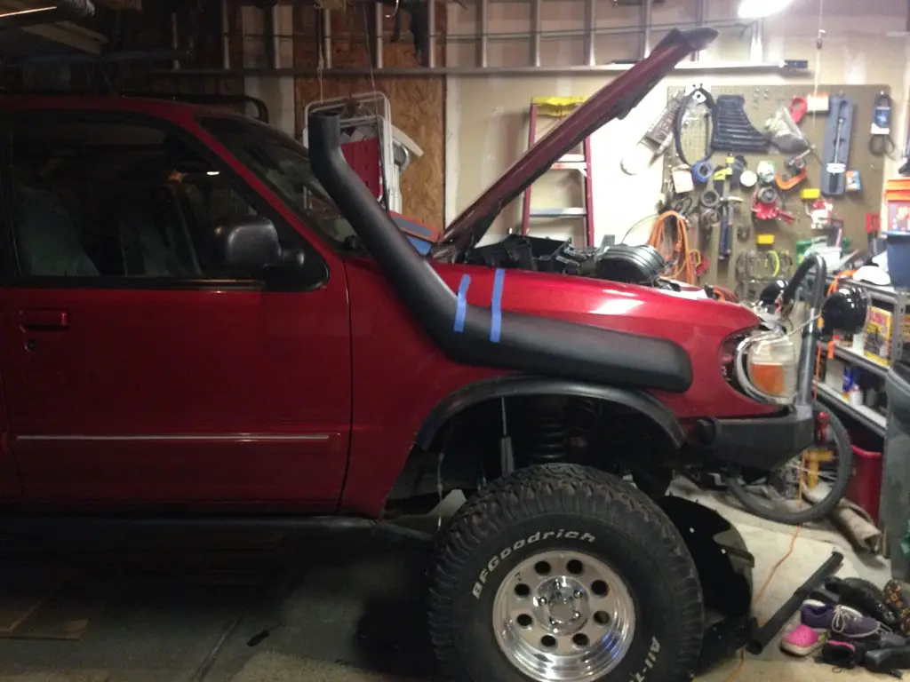

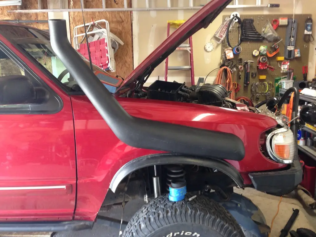

It's a generic 80-series Land Cruiser. It's taking a little massaging with a heat gun. In the end, it'll pass the 10 foot test.
But most importantly it'll hopefully keep my air filter cleaner on all these dirt roads I drive. Going to be doing a couple hundred miles in CO/UT at the end of May with a group so it'll get a work out.
Too bad you couldn't bring it back and run it along side the windshield pillar, gonna be a bad blind spot there.
The worst blind spot is the massive lift. The snorkel tube isn't that bad. My iPad hangs from the windshield over in that area so it's already partially blocked.
Here's some pictures of the process:

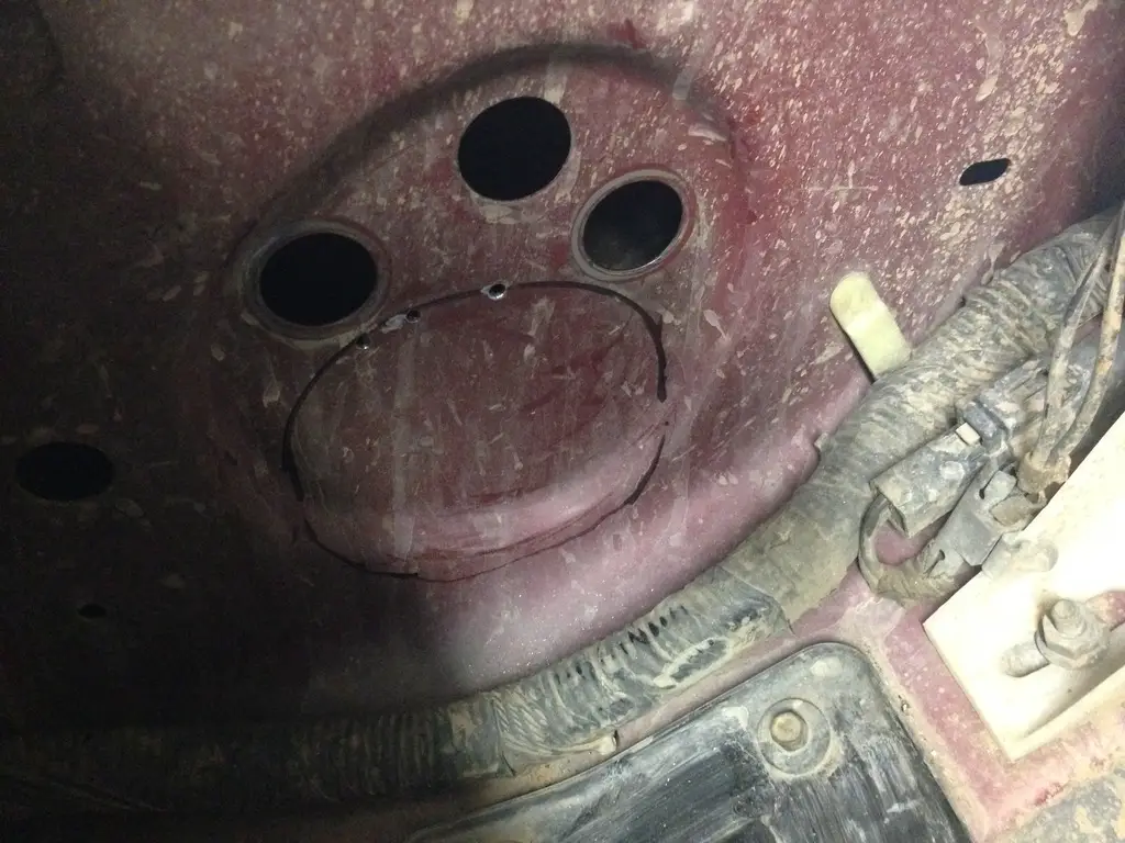

I decided I wanted no S-bent piping behind the fender and to just have the 90 degree at the end of the snorkel go straight into the airbox. Here's where it goes through the inner fender:
A 3.5" hole saw made quick work of it. But I should have gone with the 4" to give myself a little forgiveness.

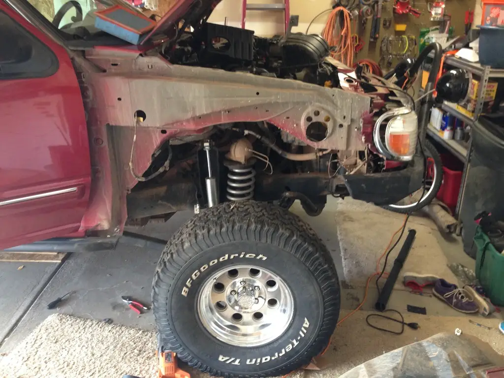

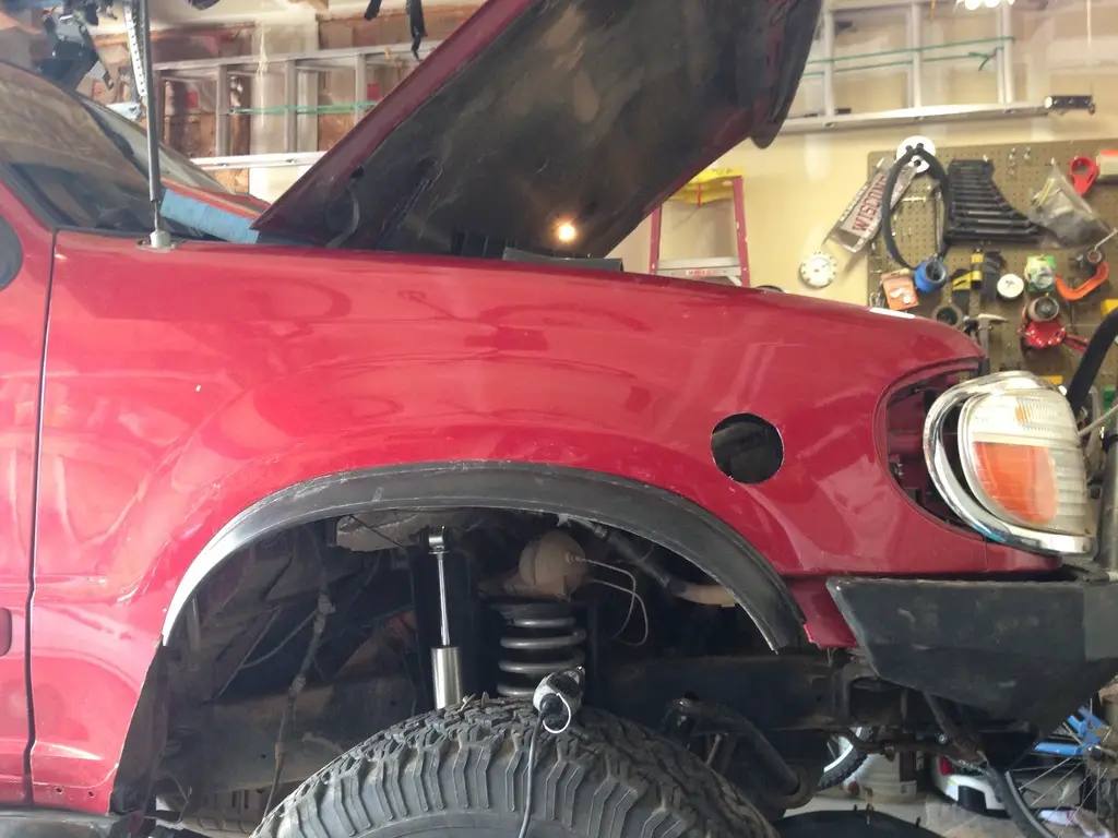

Fender off to cut the hole.
Then some heat gun massaging and repeated test fitting:
It's ready for the fastener template:
Installed:

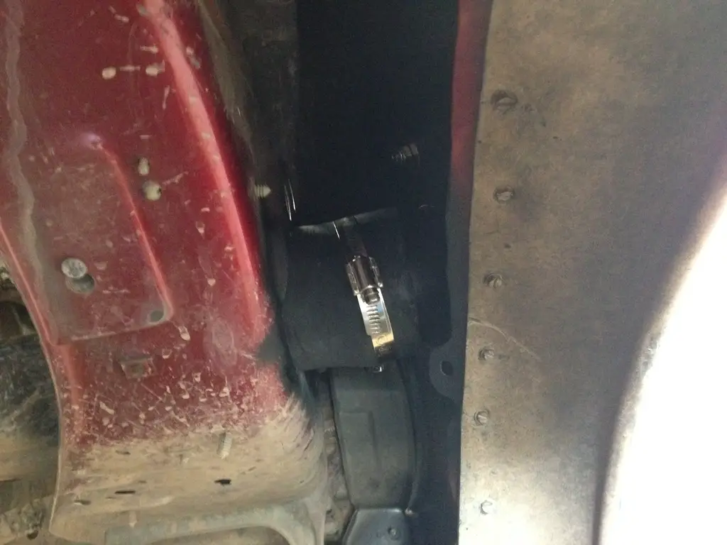

This is the rubber hose connecting the snorkel to the airbox as seen between the fenders (fender liner removed):

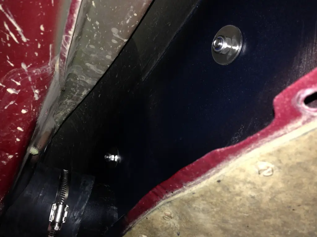

Backside of fender showing a couple of the fasteners:
I still want to bend the top of the snorkel so the snorkel head is straight. Other than that, I'm just waiting on the adhesive to dry on the airbox itself from where I closed off the OEM front hole.

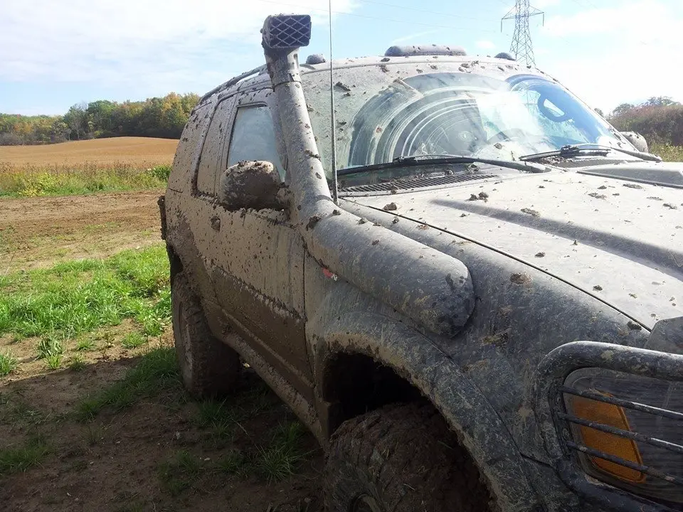

Interested to know where you order the snorkel from.
Good job Tom never thought of doing it that way
How does the front edge look down that low ?
I did have to s bend the tube in the fender but I'm thinking I may put my spare fender on and do it your way. Props man
I like the way yours looks. The air path for mine is simple and hooking it up is easy, but yours looks better. Yours looks like it belongs there, mine looks sort of hacked on.
I don't know Tom still think it looks good and as long as it's working it's job done

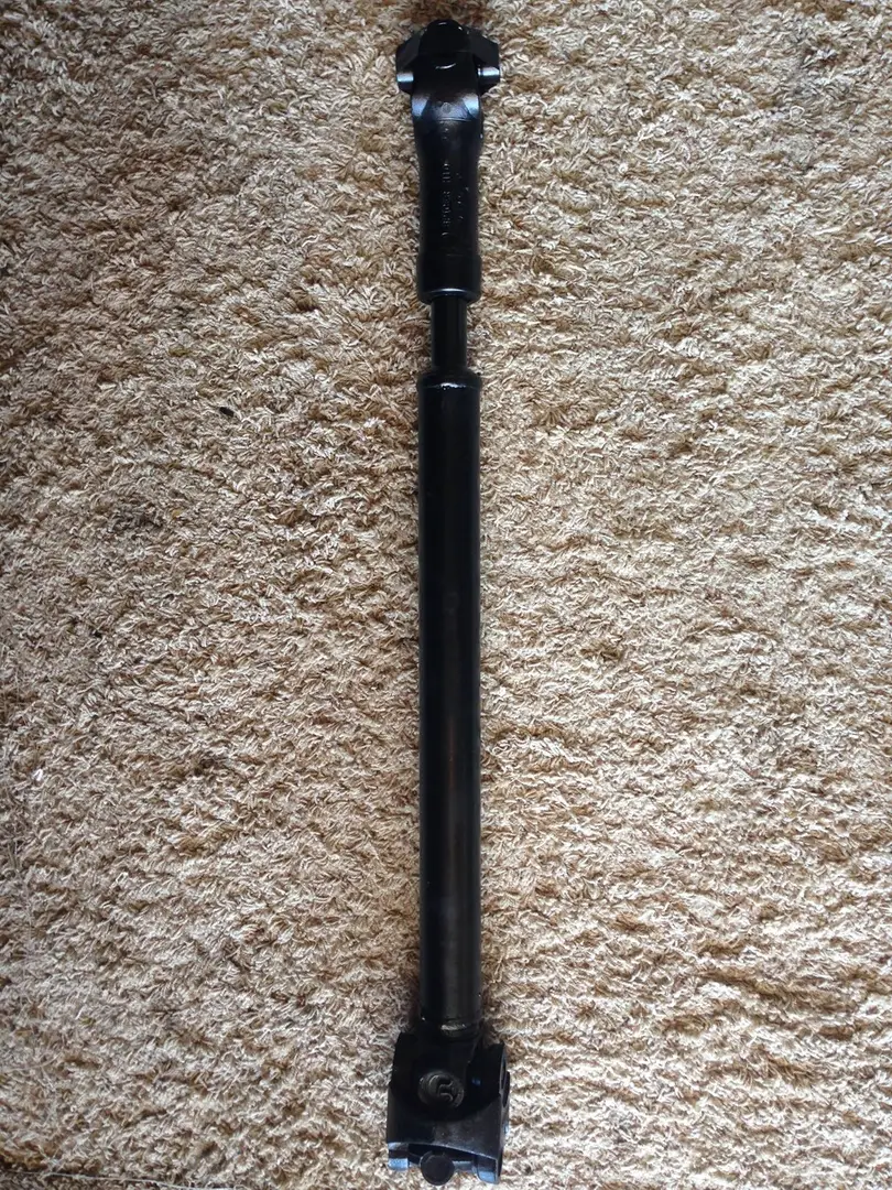

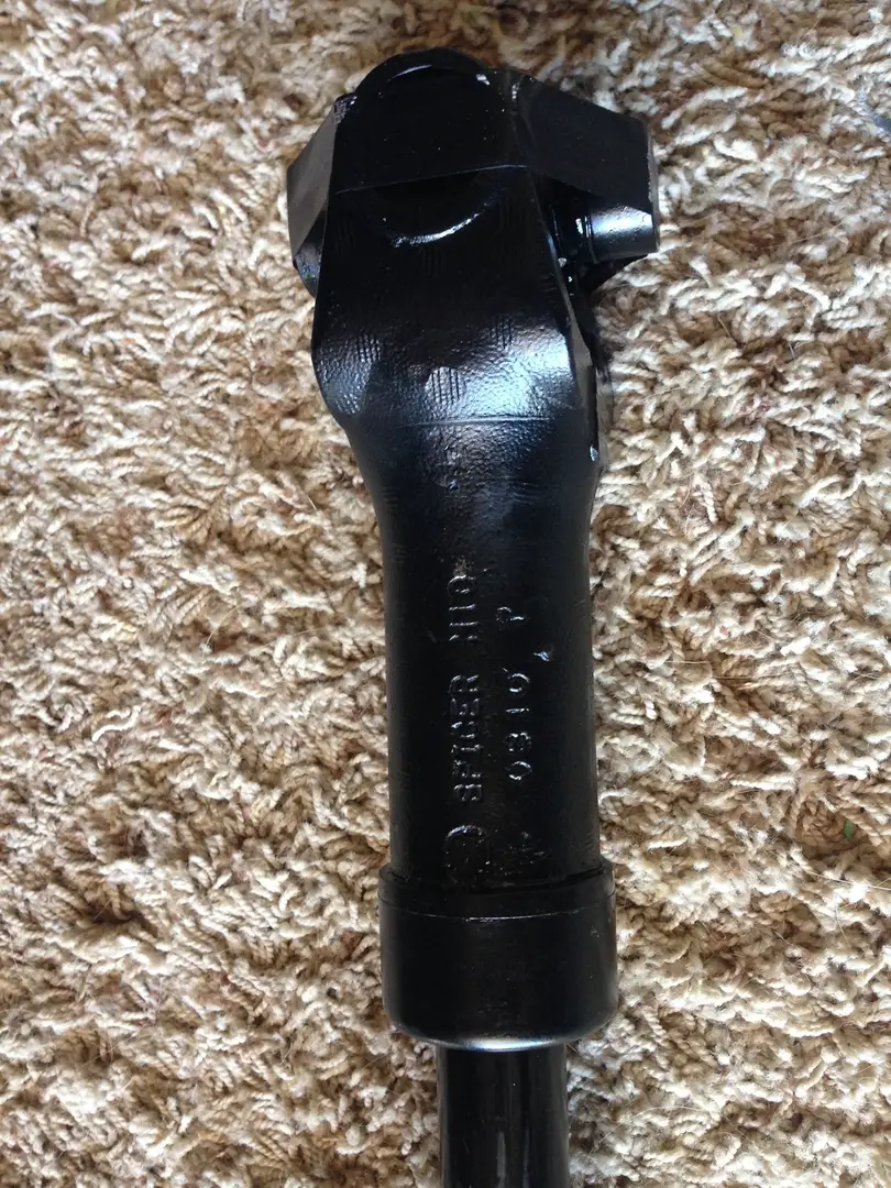

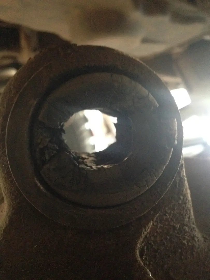

New front driveshaft. The old one developed a wobble/vibration above 40 mph. It was completely dry on spline lube and was about 1" too short. Old one used the Jeep Grand Cherokee slip shaft, new one has a beefier Spicer slip shaft. No more vibrations!
