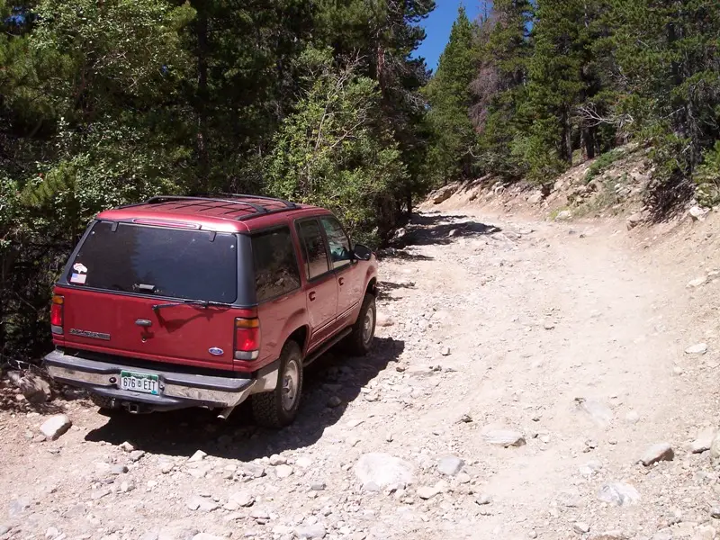

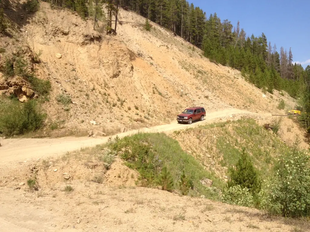

We went up Kingston Peak, down Mammoth Gulch and then up/down Rollins Pass East.
Kingston Peak was fun. The trail was easy. Grabbed a rock from lower on the trail to bring up to the rock cairn:
This cairn has grown significantly over the years. The guy I was with saw it for the first time 20 years ago and said it was much smaller than it is now. (I'll post better pics). The cairn house is at roughly 11,500 feet. The temp was 57 degrees and felt so refreshing. There's a lake (Loch Lomond) below here that I'd like to explorer later on.
Just after the rock cairn was some open tundra that we went across. Had a small water crossing to go through:
On the way down, there was a section that has been "maintained" where they filled some holes in the trail that apparently make it fairly difficult for some SUVs. I still managed to come down hard on a rock where I thought my sliders paid for themselves but instead I came down on the torsion bar mount instead.
The section behind is where I banged pretty hard:

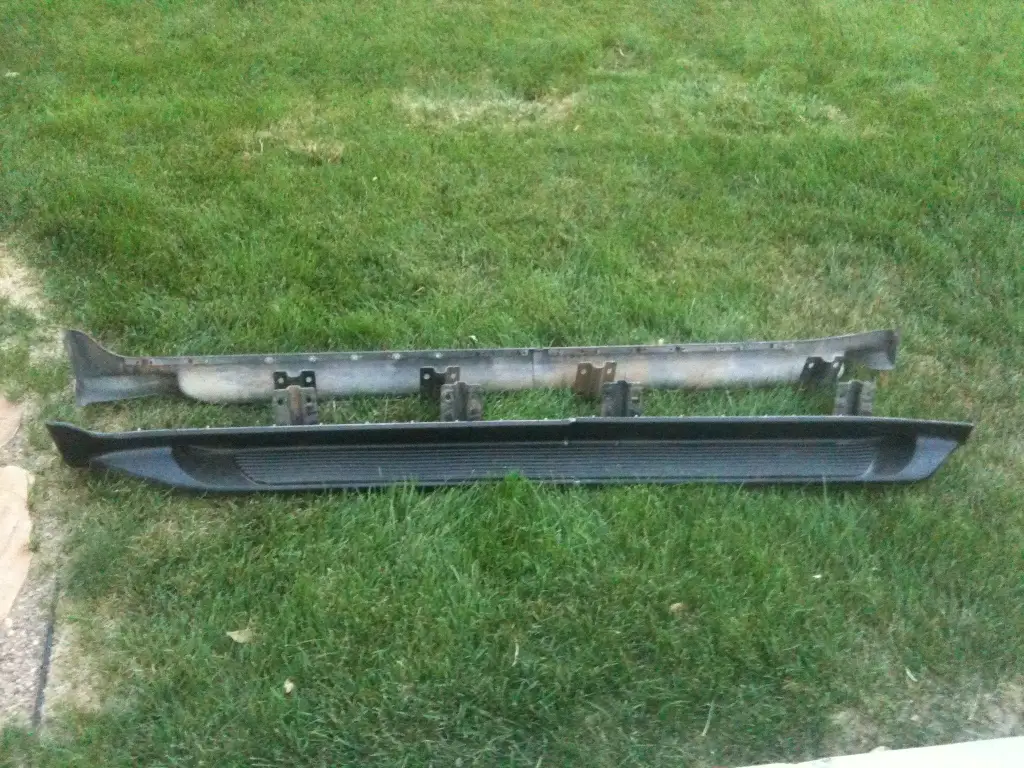

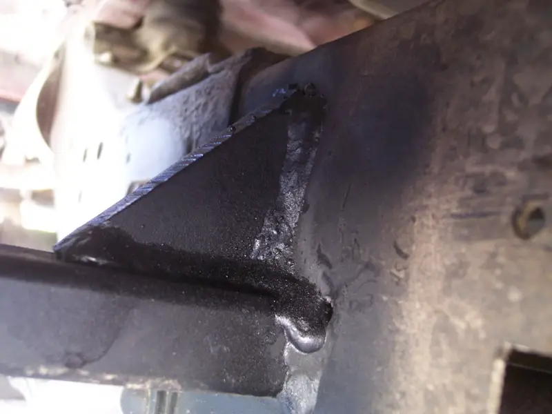

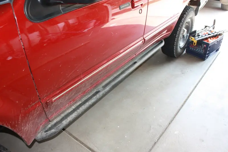

Sliders!
As I eluded to above, I removed the factory side steps. While I liked their functionality (the kids used them all the time getting in and out) I didn't like the way they hung down or how the looked. And I really didn't like how if I came down on a rock on the rocker panel, I could do some major body damage.
I found a local fabricator on craigslist called First Choice Fabrication. He has done lots of bumpers, sliders and tons of non-vehicle work. His bumpers are amazing. He uses diamond plate on the top and plate on the front and sides- but the welds are ground so smooth and evenly that you'd think it was bent out of one piece of material.
I think they turned out great. Yes, they are welded to the frame, but I don't see myself ever needing to remove these things.
I'll probably get some kind of panel plugs to fill the holes left by the side steps.

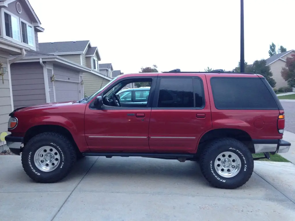

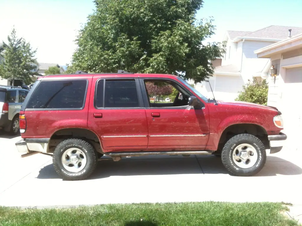

Well, as Luke eluded to above, I got some new wheels and tires. I went from 30/9.5/r15 on the factory 15x7 wheels to 33/12.5/r15 on 15x8 wheels.
Before:
After:
They are a little....... large. Even with the 2" body lift, AAL and some TT, I had to break out the cutoff wheel and make some cuts. I think I need shackles and more TT. While on the trails, I only rubbed a couple times, but I heard from another guy we went with say that he didn't rub hardly at all. The trails were great fun, but not a lot of flexing with the wheels cranked.
But I really like the additional diameter. They really seem to smooth out the ride on the road and on the trail they really seemed to make the rocks seem smaller. Plus I like the additional lift I got. It's starting to feel like a truck when I'm driving it.
I stuck with the BFG A/T KOs. They worked great when I had them in 30s, and I liked the price.
Looks awesome. I'm not sure if I want to tackle the body lift and roll with 33s or not... How do you like it?
I think I would have been happy with 32s. But try to find some 15" 32" diameter...... I was told that tire companies aren't seeing the demand for that size so they may stop making tires in that size.
But I like the 33s. Once I lift it a little more, they won't rub anymore and they won't look so huge in the wheel wells.

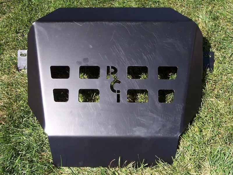

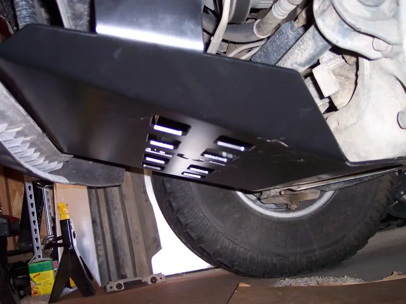

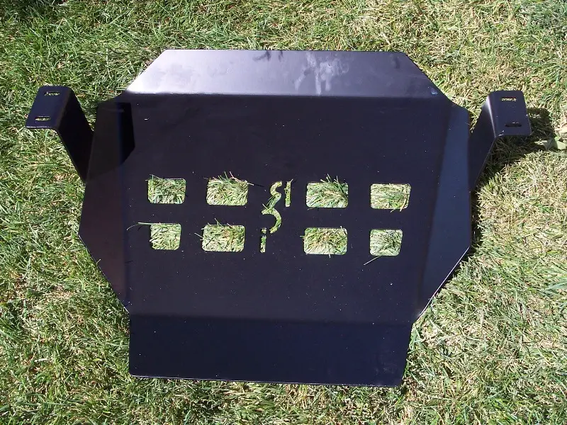

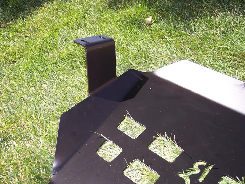

RCI Skid Plate
Today I met Josh up in Loveland, CO to pick up a front skid plate.
As you can see, this thing is awesome. One solid piece, water jet cut and bent steel. I almost don't want to go 4wheeling just so I won't bang any rocks off it- this thing is pretty!
The pick up points apparently aren't the same across all frame configurations. Josh told me that I might need to drill an additional hole. The provided self tapping screws make this an easy task- once I drilled a small pilot hole.
Although I have a 2" body lift, my bumper is still at the factory height. It works really well with a stock height bumper and should work just as well with a bumper that's been raised up to match a body lift.
PM me for contact info if you're interested in one for your rig.

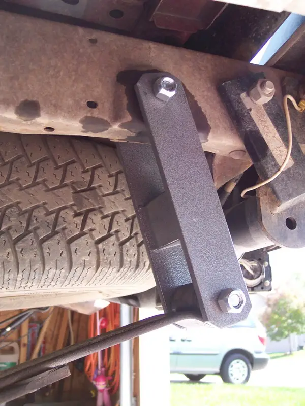

Warrior Shackles

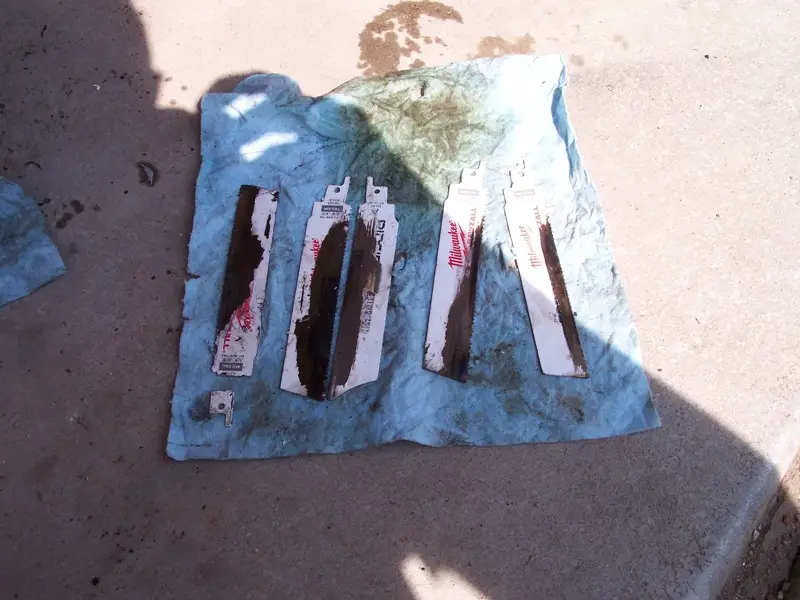

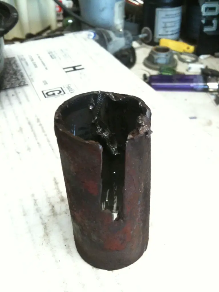

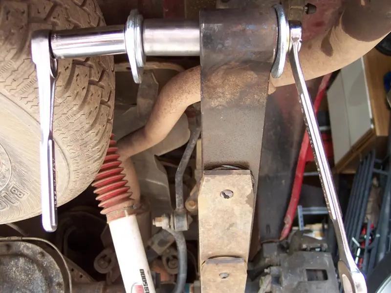

Holy crap...... Long time ago, I noticed something: the right side of nearly every vehicle I've worked on has given me more trouble than the left. My Ex has been no different. The right rear leaf spring bushing put up the fight of their life. But I guess I can't blame it- it's spent 15 years and 133k miles right next to the tail pipe getting heated every time the engine is run.
So anyway, the other 3 bolts came off with no drama after soaking most of the week with power steering fluid and PB Blaster. Then there was the fourth bolt......
5 sawzall blades later:
And a bushing BBQ:
I was able to get the outer sleeve of the bushing out:
What a PITA.....
The rest of the install went fine. I bought a bunch of large washers and 3 different length bolts to help draw the new bushing in. Worked great.
New shackle installed (left side):
During the removal of the right side bolt/bushing, I broke my 3/8" to 1/2" socket adapter so I'm not able to torque the shackle bolts down, but I have applied the German torque spec: guten-tight.
I haven't cranked up the torsion bolts yet, so this is how it sits now:
When I get my new adapter, I'll crank up the torsion bolts and get an alignment.
I can DEFINITELY see a difference. Can't wait to see what it looks like evened out with the ttwist, and what it looks like eating up a trail :-D
